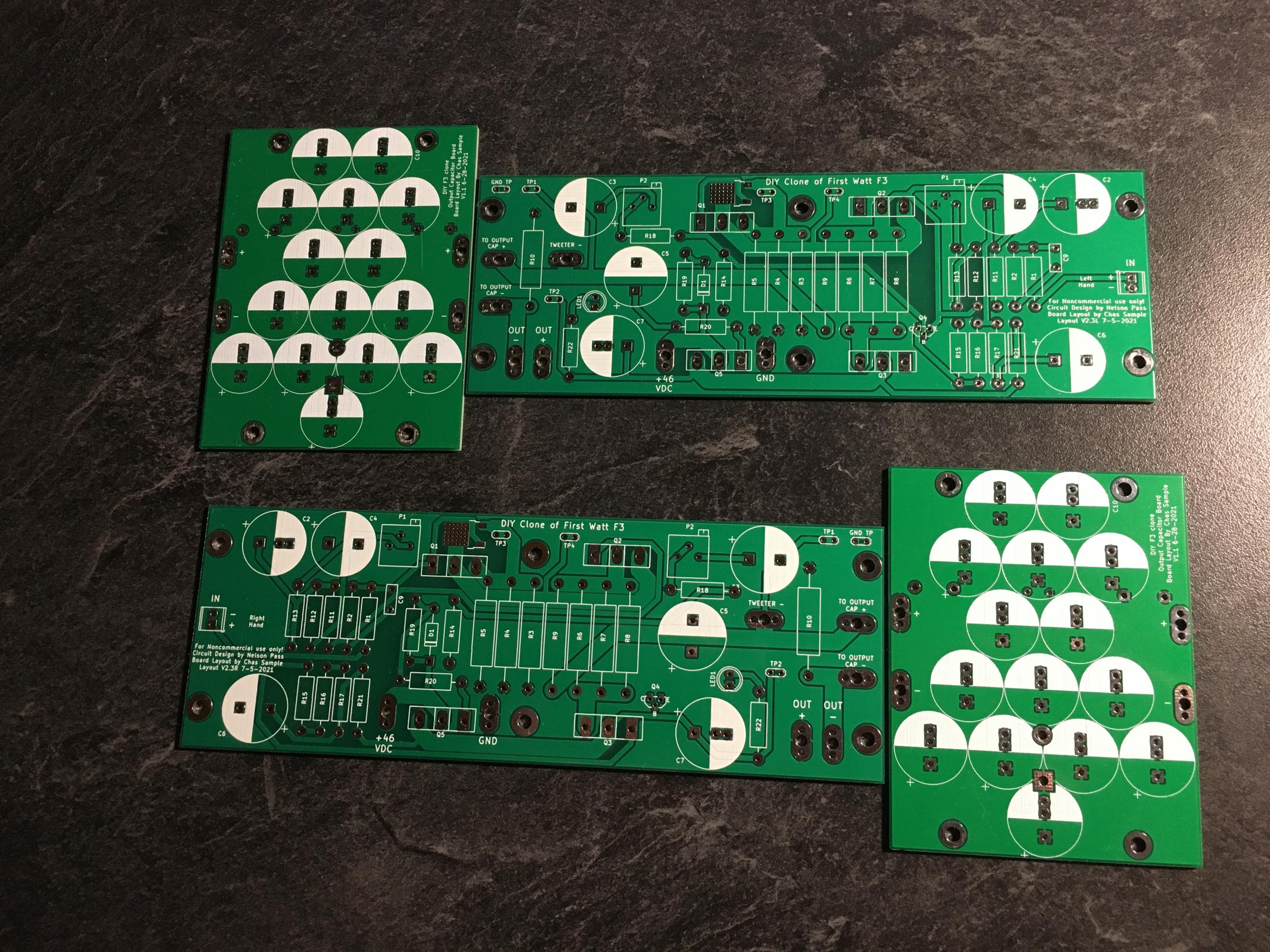

7-21-21 Update
The test boards arrived last Friday and they look good. The test boards do not have ENIG finish to keep costs low, but the final boards will have the ENIG (gold) finish on all the solder pads. I will be somewhat delayed in building the boards while I deal with some major internal engine problems with my car, but will continue to post status updates to show progress.

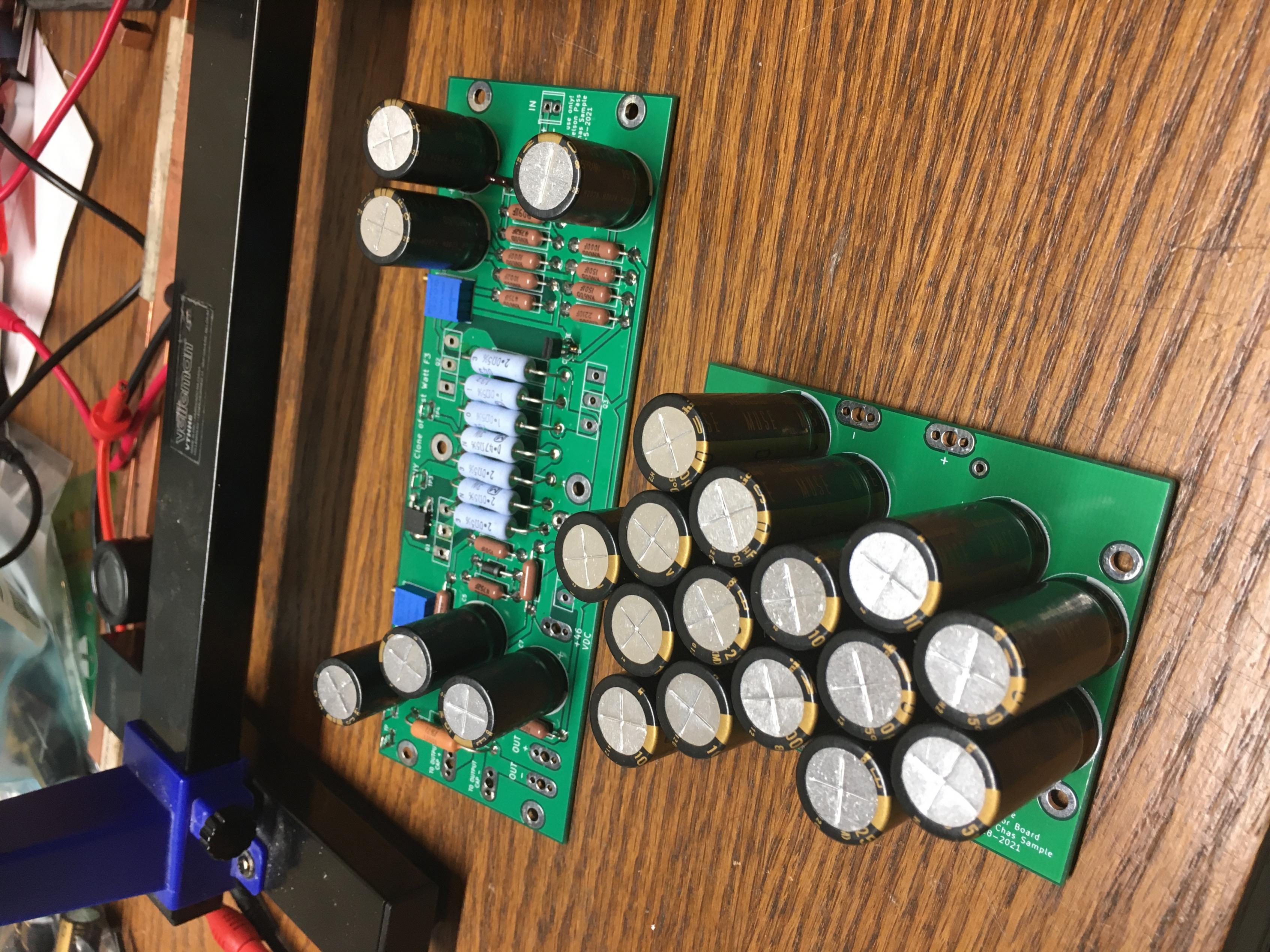

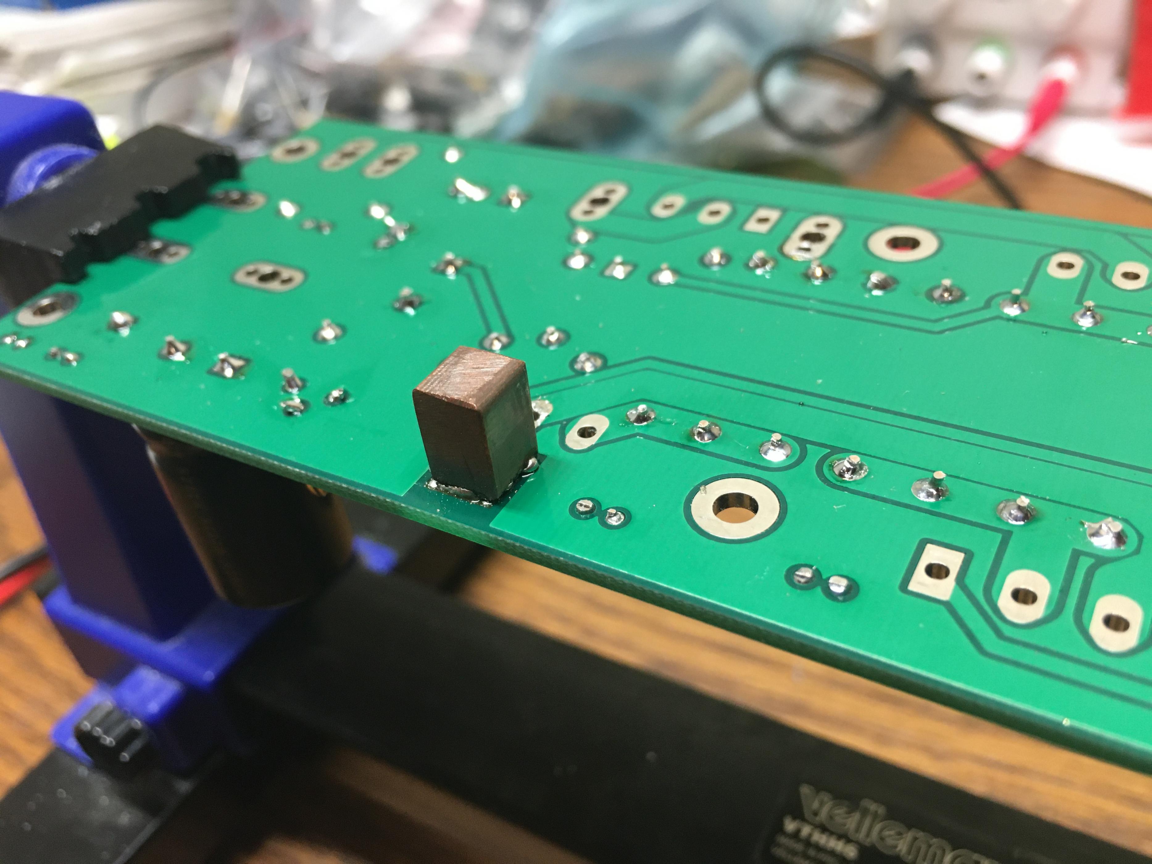

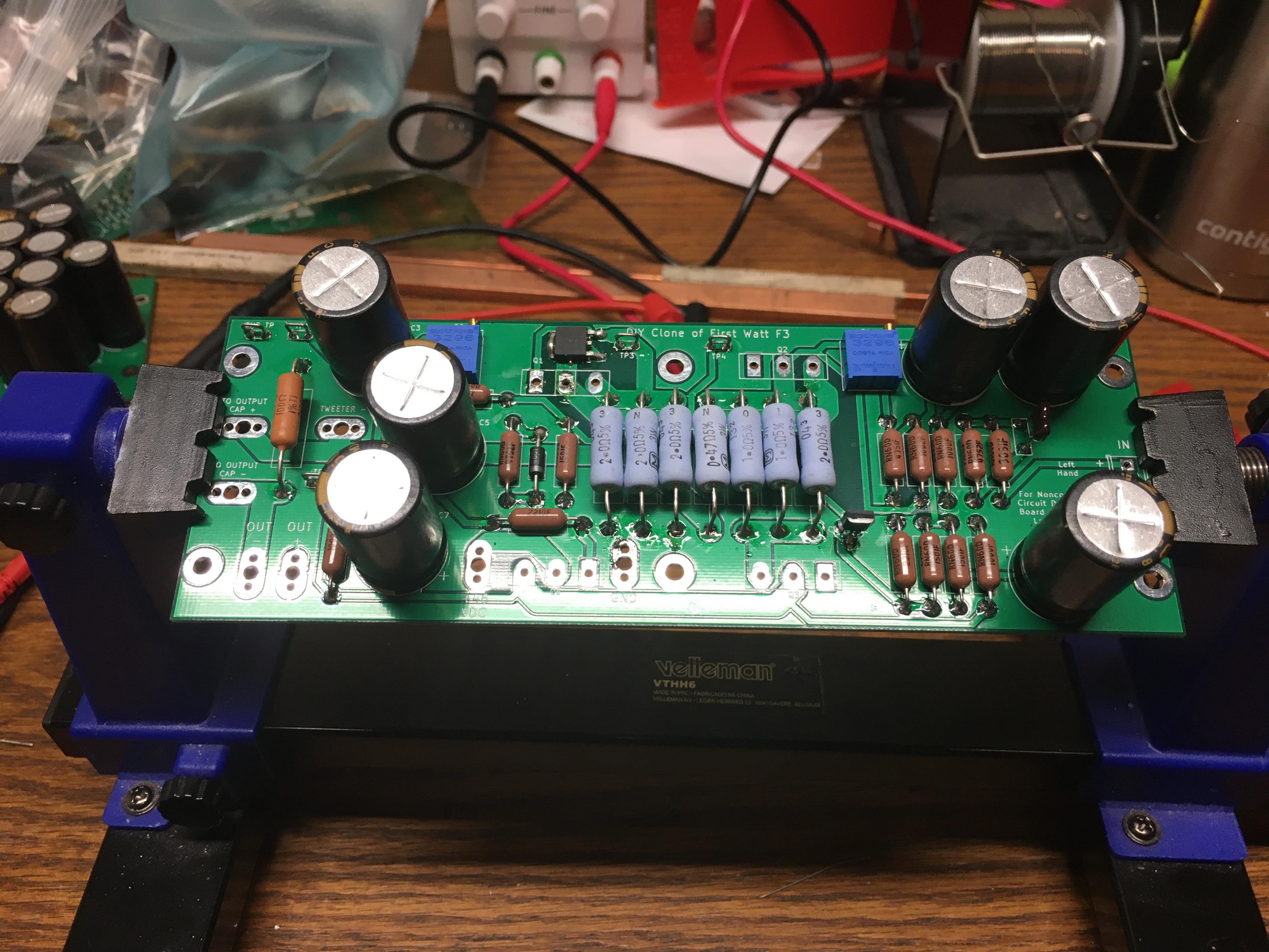

8-8-21 Status Update
I had a little time yesterday and got the left hand board built up. Next step is to disassemble my F1 (temporarily) to use the chassis for testing the F3. The copper block on the back side of the amp board is to conduct heat from Q1 to the main heatsink.
Perhaps a little side tracking but for anyone interested: The board holder pictured is currently being sold for 6.6 euros on Amazon DE, eligible for prime shipping. I have one. It's a steal and super useful for assembling boards like this en masse!
Thanks for a great project! Is there a BOM available as well?
I haven't put together a BOM yet, but I will create one after testing the boards is complete.

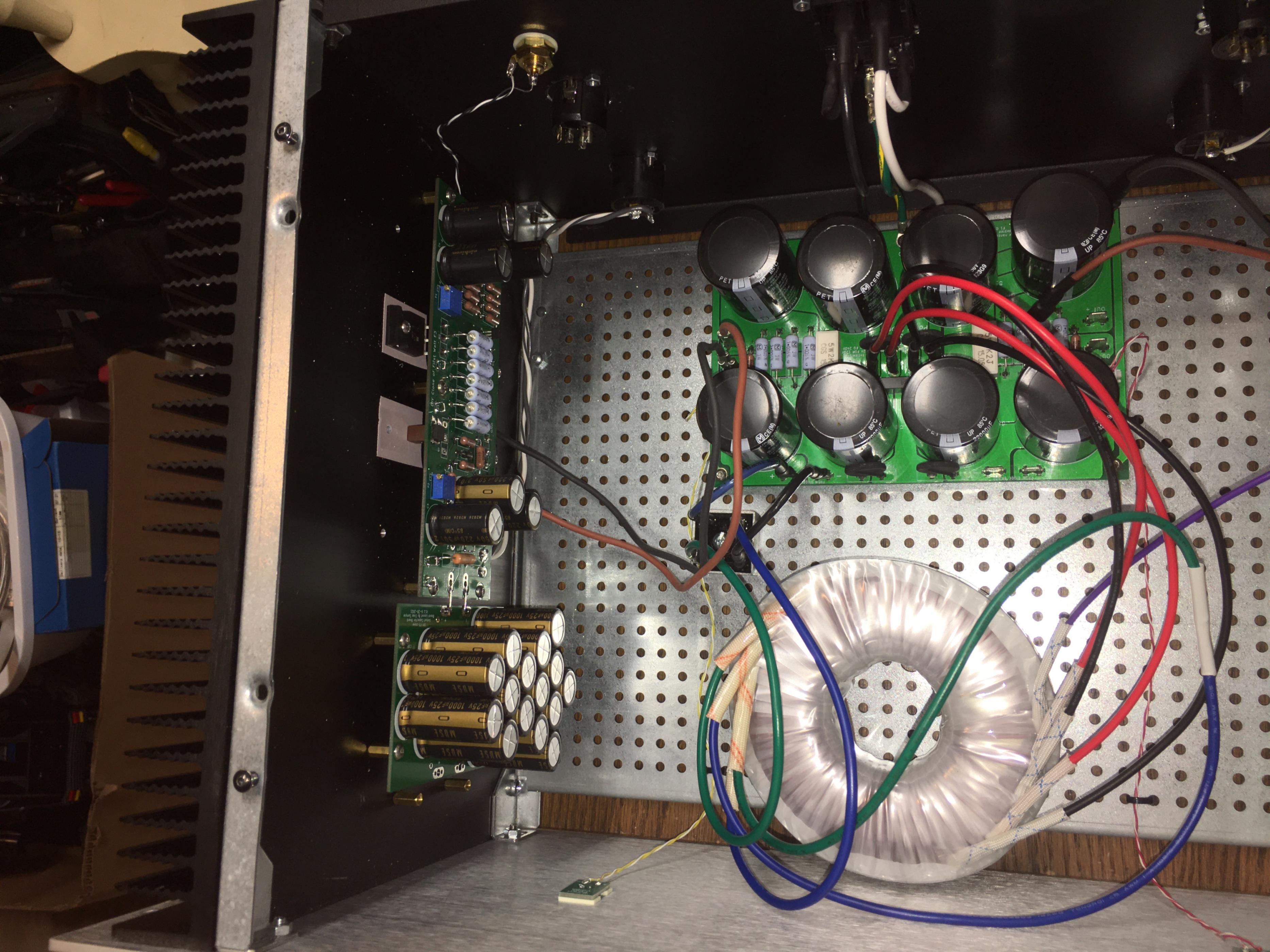

8-15-21 Update
The left channel board has been powered up and for the most part all went well. No smoke, no drama. The bias came in lower than expected at 1.60A vs 1.65A so I need to dig into that. The surface mounted Q1 with copper bridge got up to ~ 45 deg C so that worked. Q2 was a bit hot at 65 deg C; I need to check to see that it has good contact with the heatsinks, although others in the F3 build thread have reported the same. I will post in the F3 build thread to work the bias and Q2 temperature questions.
Nice to see that it fit perfectly the 4U/300 🙂
Maybe better mica+grop for U2, as thought by Adason on F3 build thread?
Same here, Q2 was the hottest. I replaced the keratherm insilator with mica and Q2 temp dropped ~15degC. All good now.
