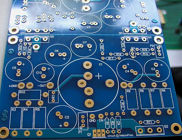

F3 and F4 Clone PCB Reissue group buy, also F5 PCBs
That's how the boards actually look:
