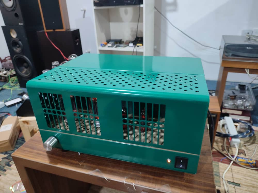

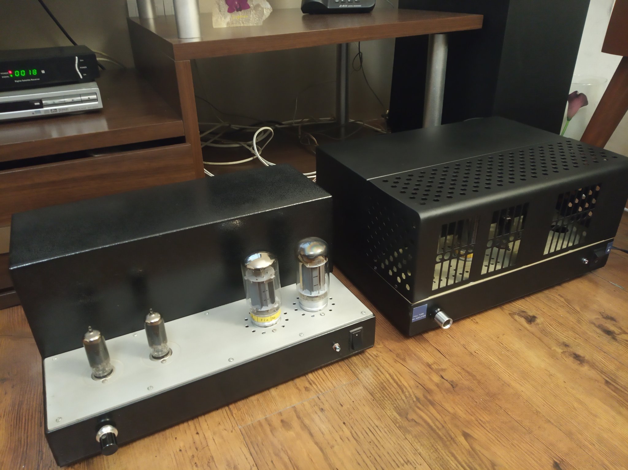

awesome build!!!View attachment 1198327
The left side is the old version and the right side is the new version

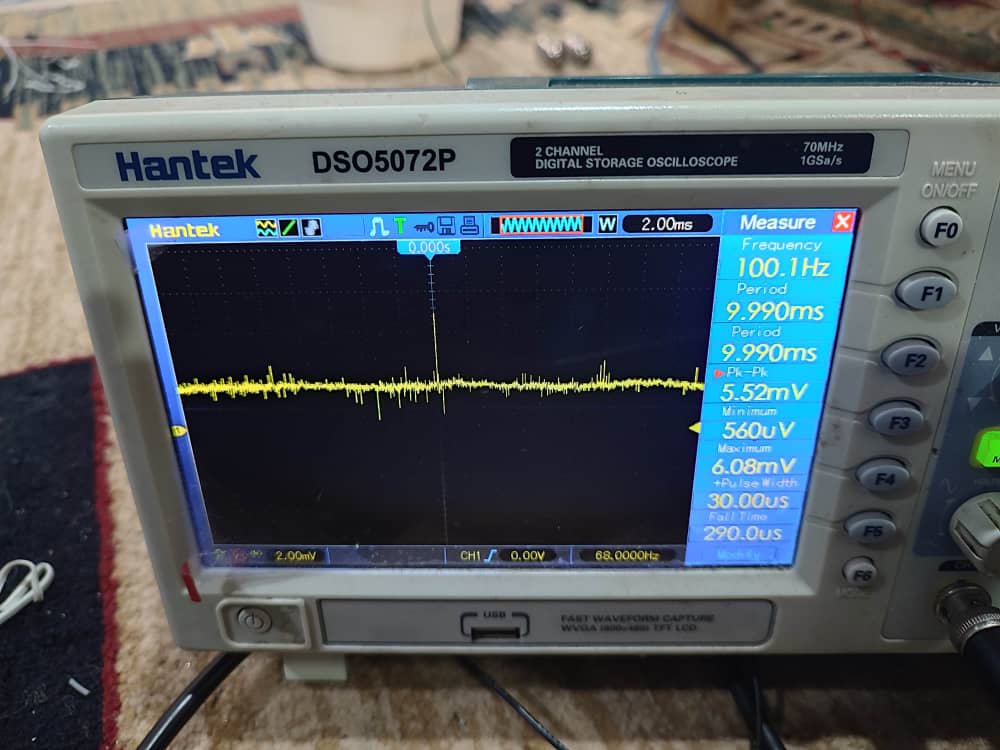

Zero hum : Hum and noise voltage on speaker output taken
with millivoltmeter would be nice to know. In daily life there
is no "zero" - except in our wallet ..
zero feedback......
zero feedback means no feedback in amp circuit?
no ...there is feedback .

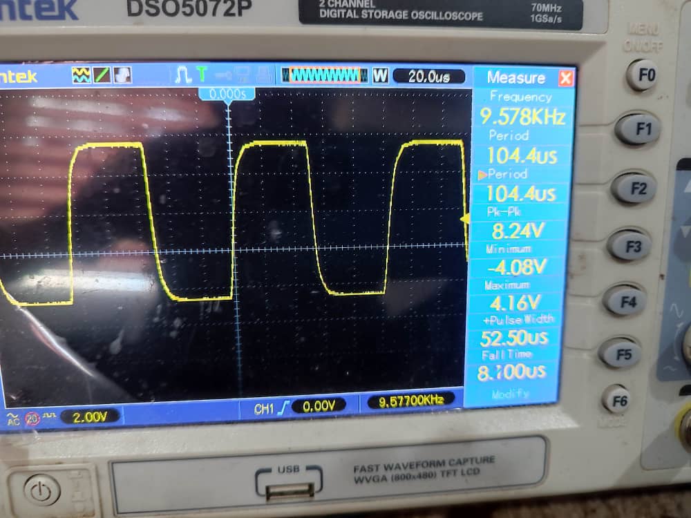

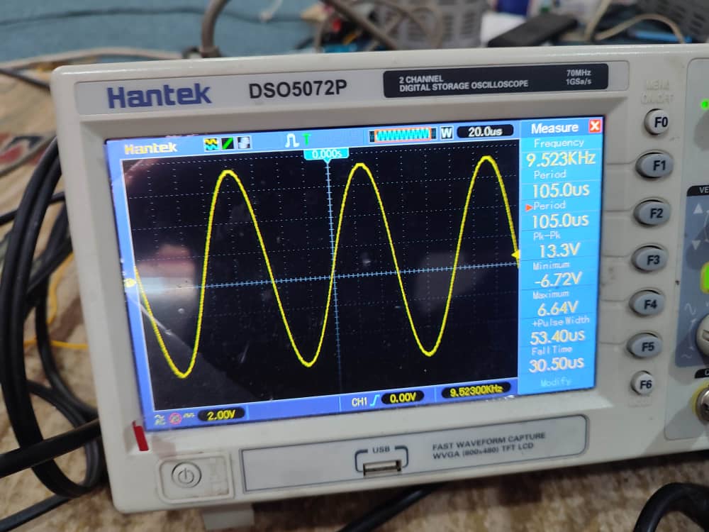

so...low hum = The user thinks will hear a low hum in speaker!! Let's see the real pictures of the scope in f2a amp .
out put speaker terminal of f2a amp . vol=min
Low levels of hum and noise cannot be displayed with a scope, you need a millivoltmeter with ac output as low noise amplifier.
.. and additional amplification. Your trace in post 47 clearly shows that resolution / sensitivity is too low.
