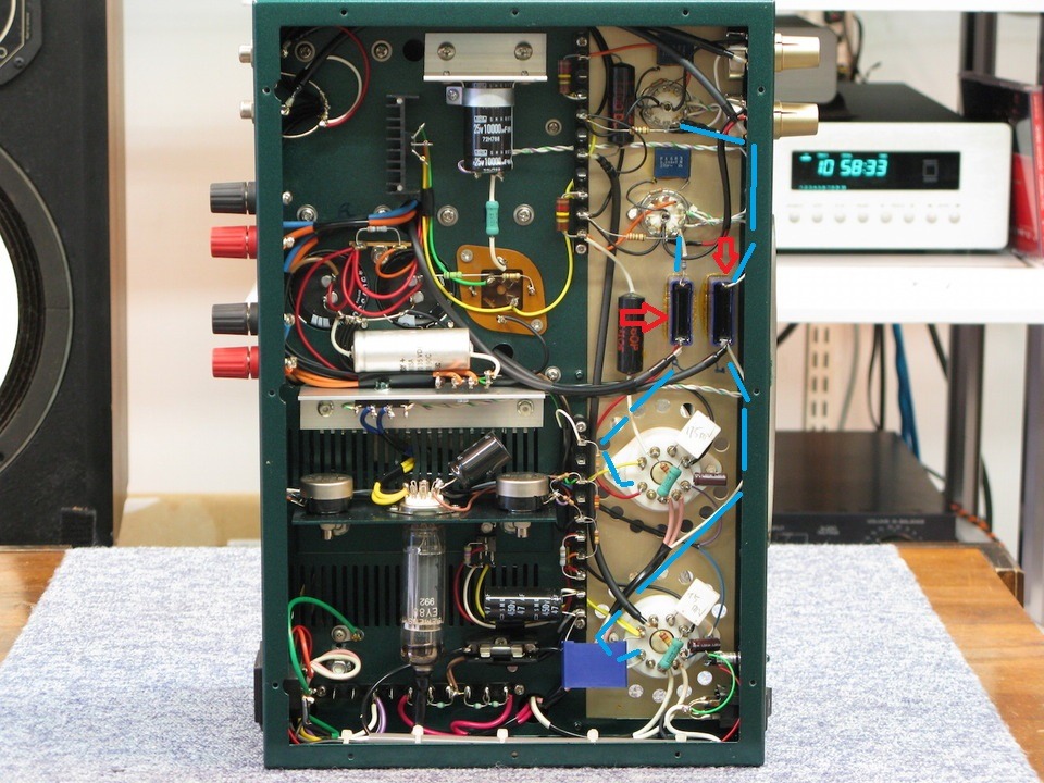

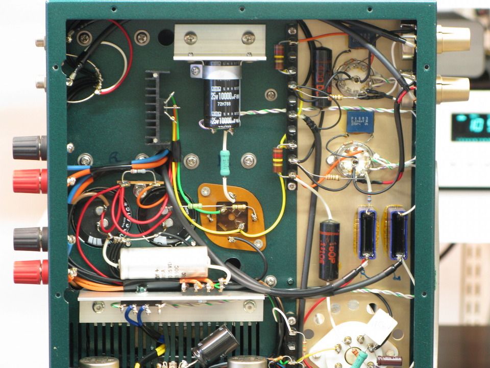

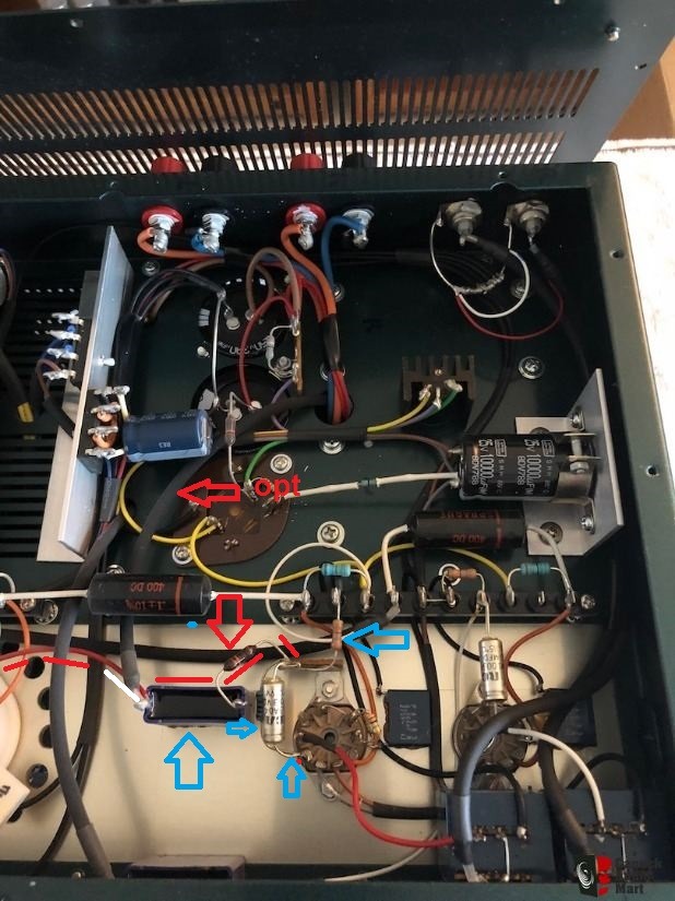

I have already written..... that everything I have built about Shindo... just from Searching the pictures of shindo . I have never seen a Shindo amps . Shindo has not published a schematics . You must know that the orignal manufacturer's diagram is only used for repair. so Shindo assembly pictures are available for you and everyone .I worked hard to be able to sell something.

Shindo built the amplifier based on a tetrode and 10 watts of output. Shindo was interested in local feedback. My clone has taken care of everything. ButThe original amplifier he has cloned uses the F2a in Tetrode but the amplifier has feedback which deals with the high plate resistance.
some time agoI found a picture of f2a with normal feedback from the speaker output transformer .!!!!! Shindo was both working and adventurous in the design process. Shindo's method is a kind of realism and undoubtedly has no equal in sound.
