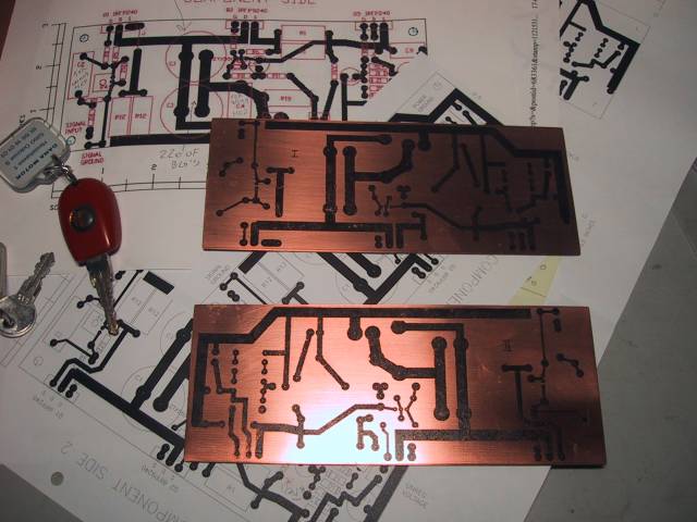

But the real test will be when I can test drive myself this amp. At present I have only been able to design the PCB’s. Its taking so long that first maybe I will make some changes to the original Zen in order to have a taste.
If anyone would like to have the designs of the PCB’s please let me know and will be happy to send the files.🙂 🙂 🙂
Can anyone point to the thread where the F2 was back engineered???
The backengineering isn't an excact F2.
There are minor details that differ from the F2,as NP stated😉
Nonetheless, with the fishing season comming to an end, I am gonna finish these very well layed out boards waiting for the etch
bath🙂 Its the work of Apassgear😎 I just obtained 3 great heatsinks that could produce an "oldstyle" Aleph chassis, and the F2 clone will end up in that particular chassis😎 The sinks were on their way to the scrap container at work! But a friend of mine saw them and knew about my DIY thing. Great!
Here is a pic of the boards, waiting to be etched, thanks Tony 😉
Steen😎
They are indeed minor. The biggest of them is that I loaded
the output with 15 ohms to get a slightly higher damping factor,
if you call .5 higher, and my Source resistor was more like 1 ohm.
That's correct; originally it was set at 15 ohms as per Nelson tips. But I recall him saying that that was somewhat an arbitrary value since it will depend on the speaker load/characteristics it was used with. This is also related to Nelson's Current Source Amp/Full Range Drivers paper.
So one should experiment with this value for best performance and taste
I was referring to the Source resistance of the Gain device,
where the N channel on the bottom is set more around an
ohm, which set the gain to X8 or so with an 8 ohm load.
The higher bias is certainly nice - at 2.7 amps it's higher than
needed, but increases the linearity of the device.
