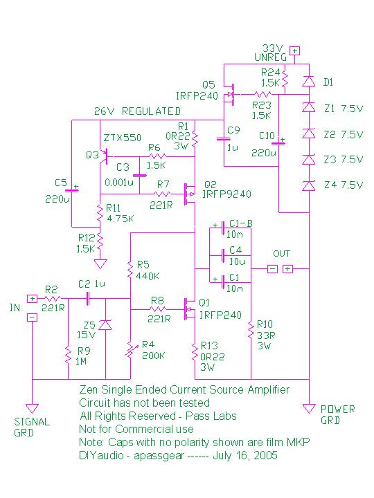

There can be a misunderstanding ;
2 x 22 in series = 44 ohms in parallel to Fostex FE206E
