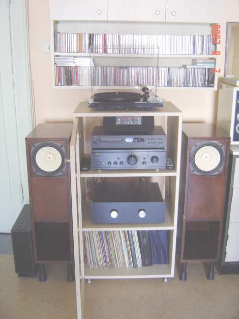

During this summer i have built three of F2 Clone Amplifier . Even the electronic parts are not top quality the sound of the amplifier is near to high-end systems . I am driving Fostex Fe 206 full range speakers with the F2 , the details of mids and highs are quite well . You can hear every detail of the sound track . Really nice . As you know FE 206 needs some time to break-in . During the break-in period mids are above normal and it is of course undesirable . After the break-in period still the vocals are sometimes above normal . I have tried notch filter but it is not so good because of lowering the mids. Some time later i will try phase plugs . Will see what will happen with the phase plugs.
As of my experience F2 ampli with Fostex Fe 206 is producing very good mids and highs . Deep bass also is good . By the way i have tried Transmission Loaded box and also front loaded horn box for the FE206 . Transmission loaded box is better than Horn loaded as of bass sounds . What i can say for the weakness is the absence of the violent bass sound ( between 100hz - 300hz ). And of course undesirable high vocals . But as a summary the overall sound of F2 with Fostex FE 206 is no doubt a highend sound . I coudn't hear the same details in other "good hi-fi " systems priced between 3000-4000 usd.
Attached is my friend's system ( The below black ampli is a F2 built by me )

As for some details i have used a single 500VA toroidal transformer with thermistors in the power supply . Because of large capacitors the initial current is too high . To limit the initial power-on current i have used PTC thermistors as the current limiter . 47,000 uF x 2 Jamicon and 10,000 x 2 Daewoo capacitors used in the power supply board and also there is another 1000 uF at the amplifier board . I am not sure 104,000 MF total is enough or not ? And also different capacitors is good or not ? May be having too many small size capacitors is better. I didn't used metal oxide resistors in these amplifiers but now i think i should. ( Small differences come together and makes a difference )
I have tried wooden phase plugs on Fostex Fe206E . Phase plugs no doubt improved the sound quality . Harsh sounds on vocals gone . And there is no absence on mids and highs . I can suggest to use phase plugs for the FE206.
On the other hand i have noticed a resonance on 40hz-70hz sounds. Deep basses seems boomy. To understand better i have tried the Fostex's with other amplifiers such as Roksan Caspian and Classe Seventy, they don't have this problem , there is a noticeable difference with the Clone F2 . Is there anyone noticed this before .
I am suspecting the output stage of clone F2 . May be the Bleeding capacitors and the 15 Ohm resistor together with the Fostex impedance creates a resonance . Or this is a transformer problem.
Anyone have an idea ?
Thanks for your helps,
Actually i added 2 x 22ohm in parallel , it sounds better now . But for the highs i think there is nothing to do, for me this is quite fine . Mids and highs are very detailed and smooth .
On the other hand the tone of the amp is very similar to the Roksan Caspian M1 integrated . The only difference F2 is more sweat and warmer .
Fostex speakers are very transparent .If the amp has something different you can here the difference . I have tried a lot of amps with Fostex , until now i found Caspian and F2 are the better than others
Thanks Again
