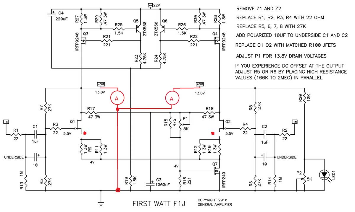

like this?

in that case , both CCS-es are OK
connect just one SSouth back in circuit , fiddle with P1 and report what you're getting (voltage vs. gnd) at that output side
re-check values of R15,R16 and P1
Ok, that's great. Re-checked values for R15, R16 and P1. They seem to be correct.
Reconnected Q2 first. Fiddling with P1, min/max drain voltage is 22,10 -> 22.15 V, i.e. only 50 mV difference.
Disconnected Q2 again, and connected Q1. Fiddling with P1, min/max drain voltage is 5,73 -> 7.93 V.
Do you think P1 needs replacement?
no , I think those SSouths are in question
from previous experience ,I know that they're hard to damage , but it's possible
pull them out and test - as any other mosfet , taking in account that gate voltage need to be in range of 1V5 , not 4V-oltish as fro IRFP
search at FW site for mosfet testing paper
however , it's wise to include little higher (in value) gate resistor and check voltage across it - to compare their gate currents

however , if you are not having few bits and pieces for proper mosfet testing , I'll prepare another sch. edit , how to test them in circ ...... but tomorrow , must fly now .... 😉

Thank you Zen Mod for your advice, I really appreciate your effort to help me out here.
I checked the mosfet testing paper you referred to. I don't know if I have the parts required to set up the mosfet test circuit as shown in the paper. However, I do have a spare pair of matched Semisouth R100's available, and I guess that replacing the ones currently in the circuit would be the easiest option?
Success!
I'm very happy to report that replacement of Q1 and Q2 made the circuit operate as intended. Quite a big DC offset of about 500mV though, but that's easily compensated by placing resistors in parallel with R5/R6. A very big thank you for invaluable help Zen Mod and generg. :worship:
