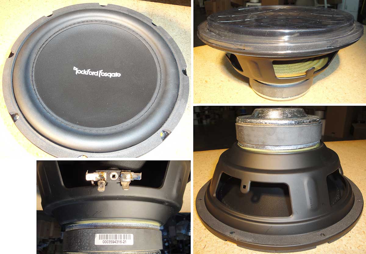

F/S Rockford Fosgate 10" Subwoofer

Considering the business you're in, I'm surprised you don't have a woofer tester or similar. Anyway, I emailed them about this, though after I sent it, I noticed a tidbit in the manual about the drivers being 'application specific/optimized', so might want to measure 'Re' to see if it's really a fractional ohm one.

I just picked up a good quantity of a 300W RMS - 4 Ohm - 10"
Freq response 24-250Hz for sealed enclosure subwoofers
These are just the speakers that fit in the R300-10 enclosures
These are new surplus.
Rockford Fosgate R300-10 Powered Subwoofers - Car Subwoofers at Onlinecarstereo.com
Price $29.95ea

Ooooh. The amplifier may be designed to drive very low impedance loads so it doesn't have to have a switching power supply. 0.36 ohms is probably correct; Kicker (Stillwater Designs) had a similar subwoofer system in the mid 1990's with a 0.5 ohm 10" driver.
I hope I'm wrong, but I'll bet I'm not. 😱
