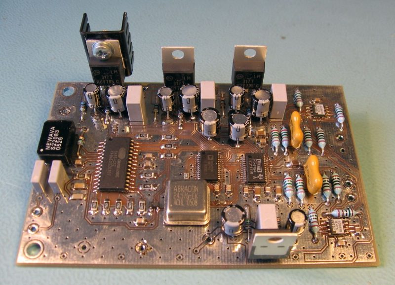

Here are a couple of pics of my EzDAC, still 'under construction'. The PCB is finished and tested, and my first impression is that it sounds very good. I used the 'fancy' chipset: AD1896A and PCM1794A with AD8610 opamps. I'm using three separate regulated PSUs for +/-12V and 3.3/5V; I cut the track between the 12V and 3.3/5V. The clock is going to be generated by a PFM Flea eventually and i'm planning to use a few Black Gates instead of the ZA's that are on the board now.

In the pic the LM317 are mounted, so you are using 3 PSU (+/-12V and 3.3/5V), that feeds the on board LM317/337, right?
What about grounds? Please put some pic of the connections, when finished. I am willing to go the same way, with different PSU for each voltage, but bypassing on board LM3xx.

Thanks guys. The outputstage was something that came to my mind too, when I saw the EzDAC project 😀. I had a quick listen to it for the first time this week and used my modded SA8400 as a source (which has the output stage on-board). I had those analog outputs plugged in too, so I did a nice A-B comparison with my amp's selector switch. The EzDAC was temporarily soldered together with lots of loose wires and PSU PCBs. But it already sounds very good, and is definately of the same level of quality as the 8400 (it uses the CS4397 'Super DAC'). I'm curious what the end result will be, and how it will compare to SACD playback through the 8400's outputstage.
I wonder if a discrete stage with the EzDAC will contribute a lot. There's clearly some HF residue present on the scope, but it's way outside the audioband and doesn't seem to affect performance. So more filtering may not improve things much. It has a nice differential input though, maybe if you use it without the passive filter, or use a simplified 2nd order version of it. The signal should come out cleaner and the circuit is very simple, so that may be an advantage to the opamps.

Yep, the three PSUs put out 9V and 2x 15V and feed the on-board regs. I used a simple 78xx circuit and two 7815's for the +/-12V section. I just wired one 15V output to GND to generate -15V. I used the local ground-plane to connect the PSU to ground, so it's closer to the on-board input capacitors. Here's a few pics.
