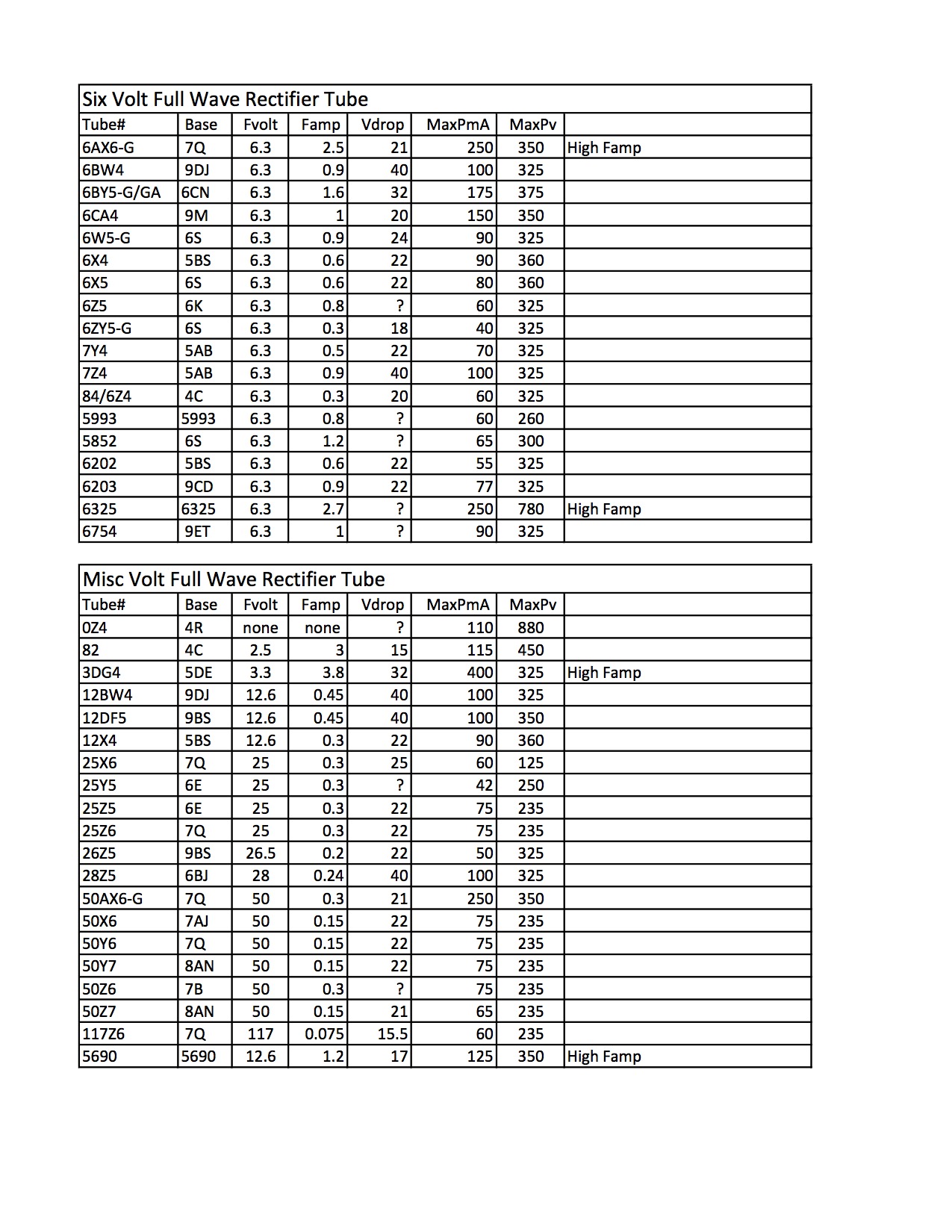

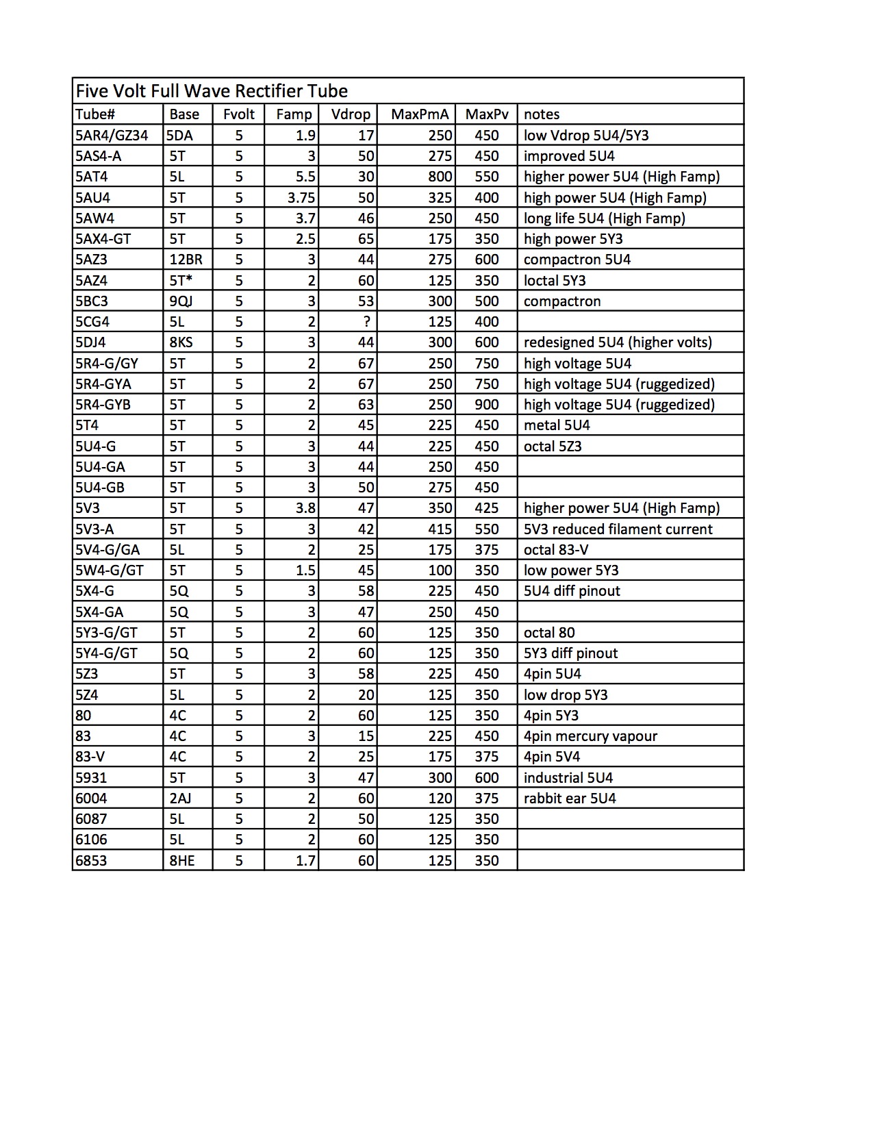

For all those whose time is too valuable to ponder OH Schade's tome covering rectifiers & filters. here it is summarized from RDH4.

You could use a pair of thyratrons for a regulated power supply. Thyratron's are still available and cheaper than valve rectifiers and most can handle a lot of current, the T41 for instance 500mA peak with a Vdrop of 40v.

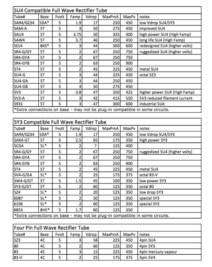

Did you complete that project? Working OK?Is it possible to use a pair of EZ81 valves in parallel for a 300mA HT supply?

I think 300mA with a pair of EZ81 and capacitor input is probably pushing it, you can do better with choke input. I had a pair of EICO HF-30 (IIRC model #) which used a pair of EZ81 in parallel and a quartet of EL84 in the output stage, idle current was 200mA total - I think that is a reasonable upper limit for a pair of EZ81

Ian, it depends entirely on how you deploy the EZ81's, as one configuration will surpass even the 500mA wish-list requirement.
