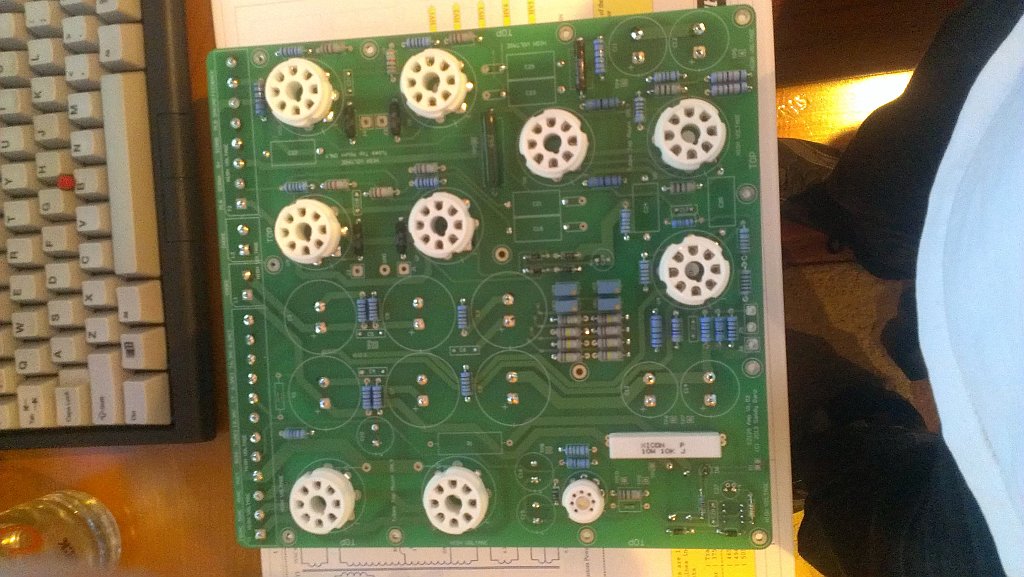

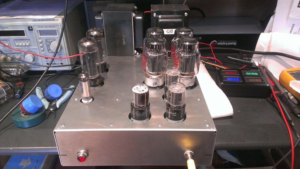

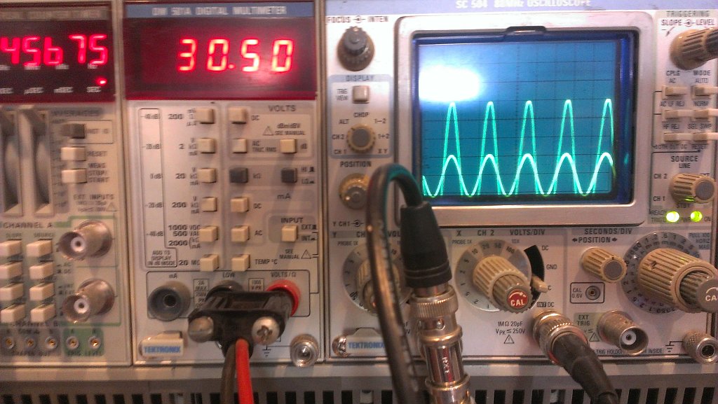

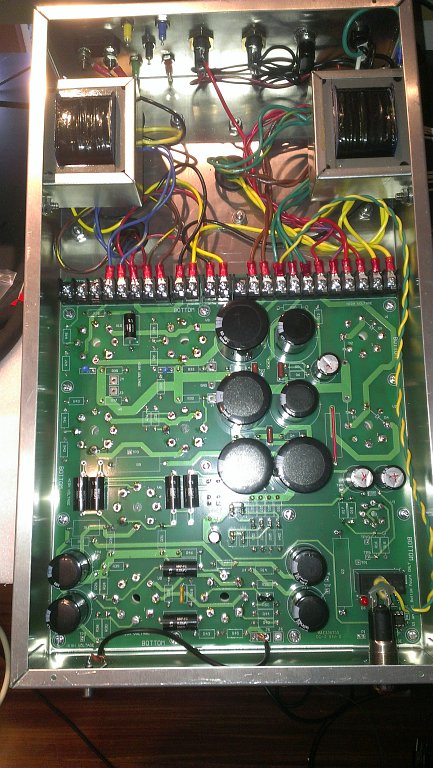

Test amp is built and running. At first I thought it was unstable, and turned it off and went to sleep. Then the next day woke up and forgot that it had the same odd behavior as another amp I built but has the the screen/plates flip/flopped so it changed them around and it worked!
Amp is very clean and stable with no signs of waveform ugly across the audio spectrum. Begins to flattop at about 116 watts with solid state rectifiers and about 80 watts with a pair of old 5U4's.
This is with just guessing at some of the part values for the 6SN7 stages, and I'm sure their are some that would require changes between the voltage drop of the tube vs. the SS rectifier.
Need to get voltage readings and start working on the 6SN7's operating points...

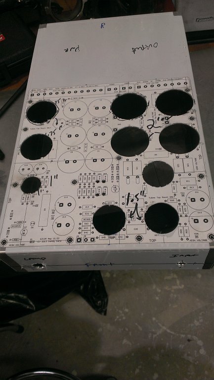

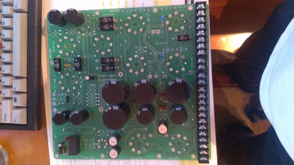

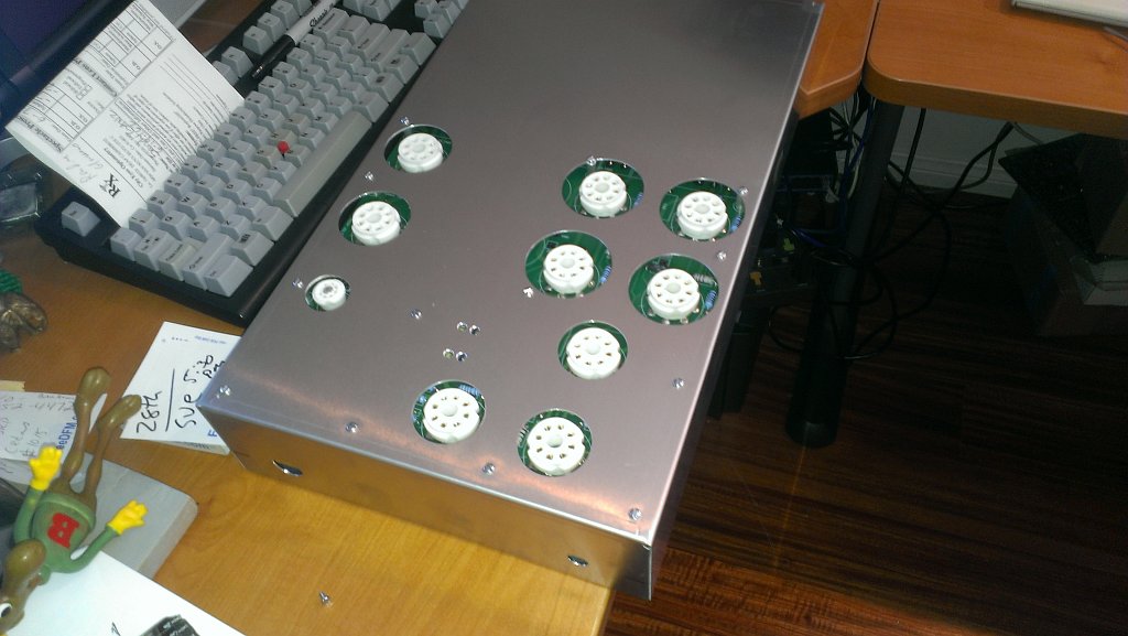

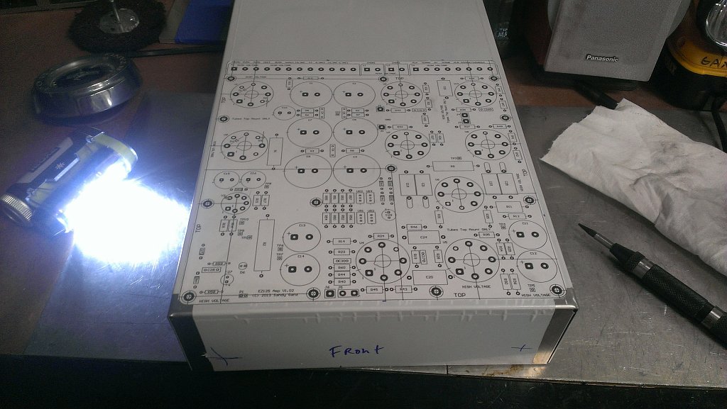

Pics below of some of the build.
The amp definitely needs some refinement.
On my PPP amp, I obtain around 130 watts RMS at 0.25% THD at 1k. Distortion rises to 0.65% at 10k, and higher at 20k. There is a similar pattern at lower frequencies with the transformer I have.
Are you looking for undistorted power at 120 watts? What is the power goal here?
Yeah, I think it has a bit more to give. Would be nice to clip the 125 Watt mark 🙂 But it makes what it makes!

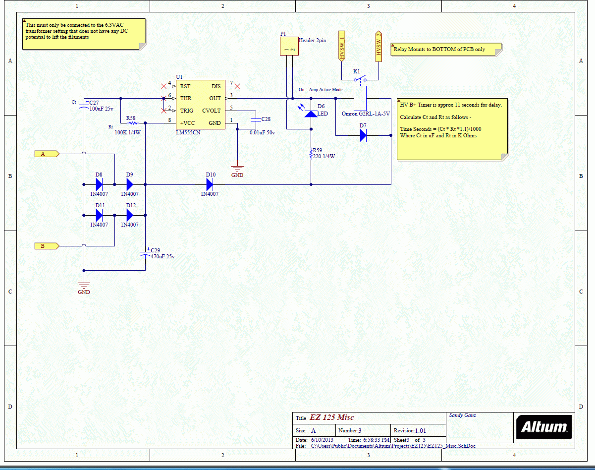

One thing I did measure was the with the 10K soft start resistor that the relay cuts out after startup it looked pretty close in value. With about 11 seconds on the relay delay the voltage comes up to about 300 vdc with the solid state rectifiers. So the relay is switching 200vdc.
I could make the voltage come up faster but in looking at the voltage on the 450v 56uf cap that is on the cathode follower it briefly clicks about 469v then quickly settles to about 434v which is OK. I think if I change the resistor from 10K to a lesser value it doesn't give enough time for 'things' to start drawing power and keep the 450v caps in a safe area.
Optimally might just make the delay a bit longer and that will keep things well below limits. Didn't see any heating issues with the 10w 10k resistor either.

Updated schematics (Minor changes) but the amp schematic has the measured voltages.
These were taken at a bias of about 50ma/tube.
Now to do some calculations...
