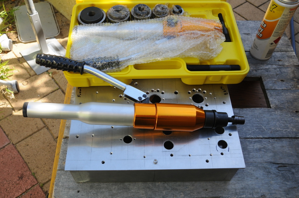

The punch easily goes thru 4 Mill ali. Leaves a very clean hole.
I also have a 15 ton one that can punch up to 114mill, holes easily in 3mill ali to mount fans on the bottom plate.
Much easier and safer than using saws and a big drill.
Phil

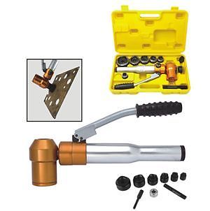

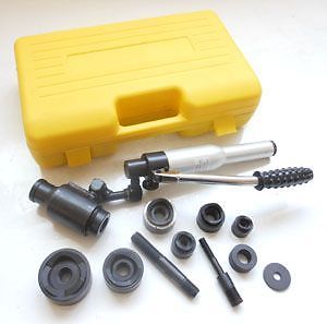

Punch sets
These are the sets I use:
TPA-8 hydraulic hole punch driver tool
TPA-8 hydraulic hole punch driver tool, high quality hydraulic hole punch tool
1, Tool head rotated 360 degrees.
2, Tool body made of aluminium material, super light punch tool.
3, Japanese rubber O rings set.
4, complete kit, plastic carrying case packed.
5, Tools factory standard setting for six round holes: 22mm, 27.5mm, 34mm, 43mm, 49mm, 60.8mm. Other sizes available
Similar hydraulic hole punch tool, TPA-8, WK-8, TP-8C:
phil
you can buy these sets from Hare and Forbes in Australia

Just got some one of the Hydraulic 15T punch kits, as usual my expectations for the Chinese tools were too high 🙂 Biggest problem is that threads for the hydraulic ram are cut so bad that the stud holding the punches feels like it's loose enough to pull out. I did punch a 3.5" hole in 1/8" aluminum with no fuss at all and overall not too bad. I'll posts some pics when I get a chance.
Again, it works OK, but when all said and done I still have to drill a large hole for the punches and it's about as much work as using the Rotabroach which don't at all distort the metal and leave a perfect hole.
I will use the kit for some larger holes, but for tube sockets, I think the quick and easy rotabroach is a better option for me.

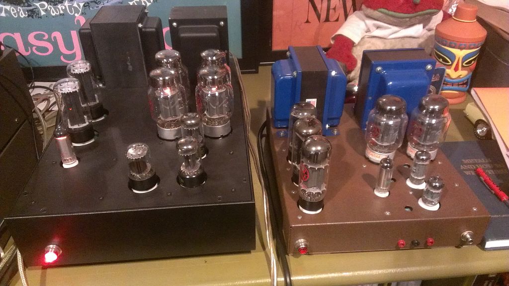

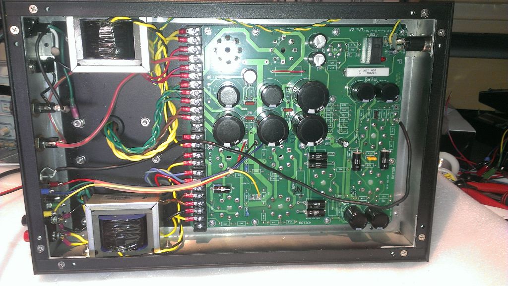

Here are a couple more on progress on the EZ125. I have just about got both amps completed and biased up. Will post some clean pictures shortly. I have set these up to use 5U4GB's instead of solid state with a reduced power output in the 90 watt range due to the big drop in voltage vs. solid state. Rest of the tubes are NOS Raytheon 6SN7GTB's with NOS Raytheon 5U4GB, Raytheon OB2 and for output a quad of JJ KT88's
Sandy

Hi Sandy;
Don't you have voltage sag using the 5u4; i find they have terrible voltage regulation compared to solid state; very noticeable when playing loud organ music. I suppose you get away with the voltage drop with very large caps.
phil
Yeah with the 5U4GB tubes it's pretty bad, but given that I'm no where near 90 watts when listening I think that it's part of the 'charm' of the tube sound... Well I have a bunch of NOS 5U4GB's and needed to use them 🙂 The glass looks nice too.
Hpw - Yeah I could try also to phase my resistors to (note carefully chosen word) 'CHANGE' the sound, but I don't buy into any of the divining rod type of tuning. They sound how they sound and get ready for this one, I have tone controls on my preamp so I'm pretty sure I can make the sound enjoyable no matter the source. Poking a bit of fun with some of my truth mixed in 🙂
Ran the amps all day with a bunch of different source from Crystal Method to Enya with some Johnny Cash in between and these amps have some punch. They sound very good with string instruments and anything with heavy base. I thing the way they are set up they roll off the top pretty quickly due to output transformer and feedback network, but it's clean and best way to describe it - TUBE ENJOYABLE which is the point. In comparison to the EZ260's that are my favorite sounding amps these sound similar but with a bit less high end.
Do I need close to 100 watts? Nope, I think a real well done pair of KT88 should be enough for my systems. Sadly with all the glass and heat that comes from it here in California it's a warm 82F day...
