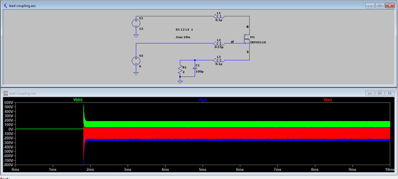

Lead coupling
This simulation illustrates the potential problem with transistor lead coupling. This example deliberately exaggerates the problem but the point remains. Changing the coupling polarity and inductance can be used to simulate the ferrite placement.

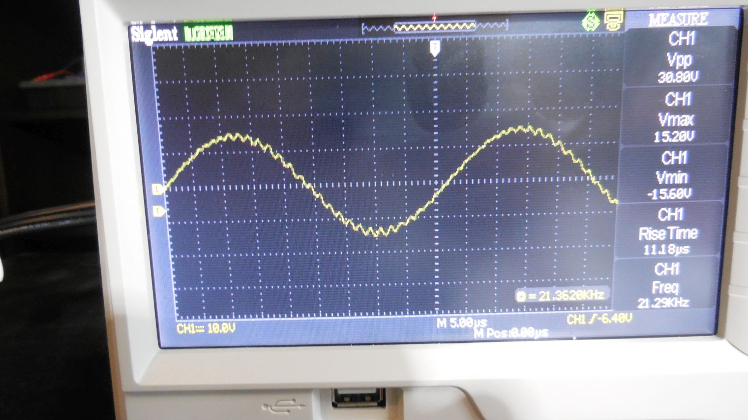

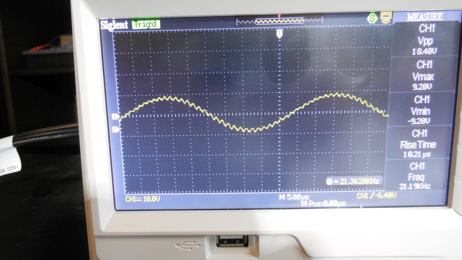

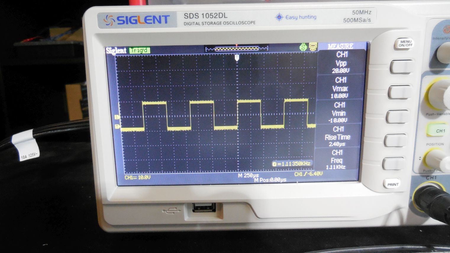

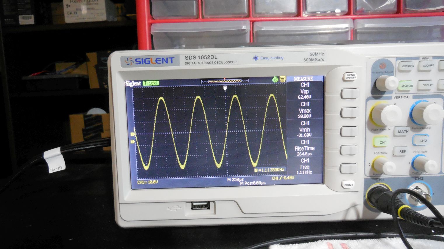

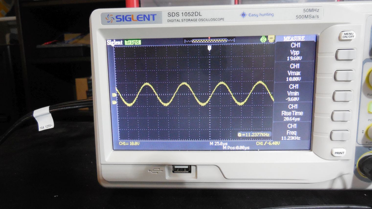

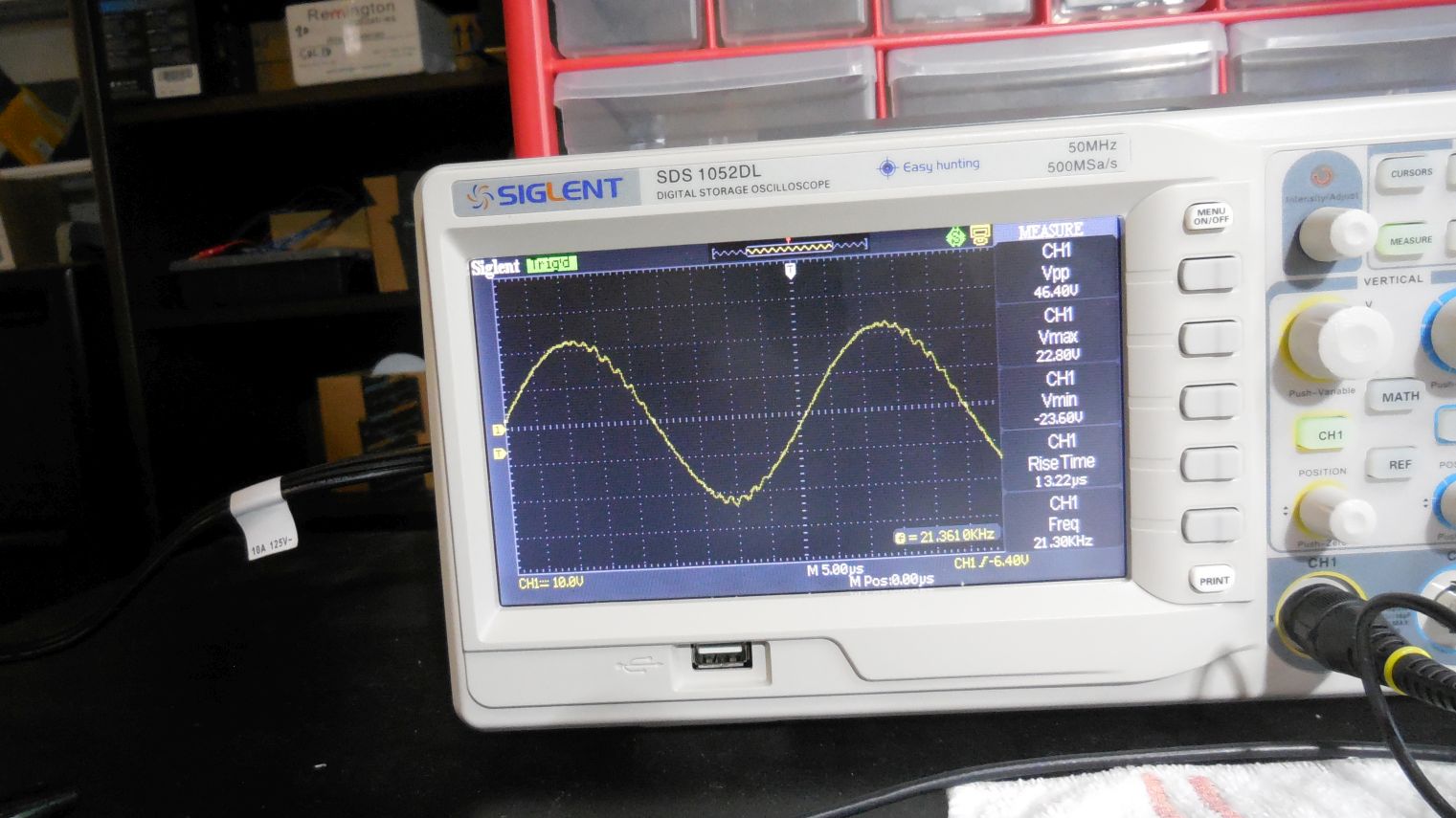

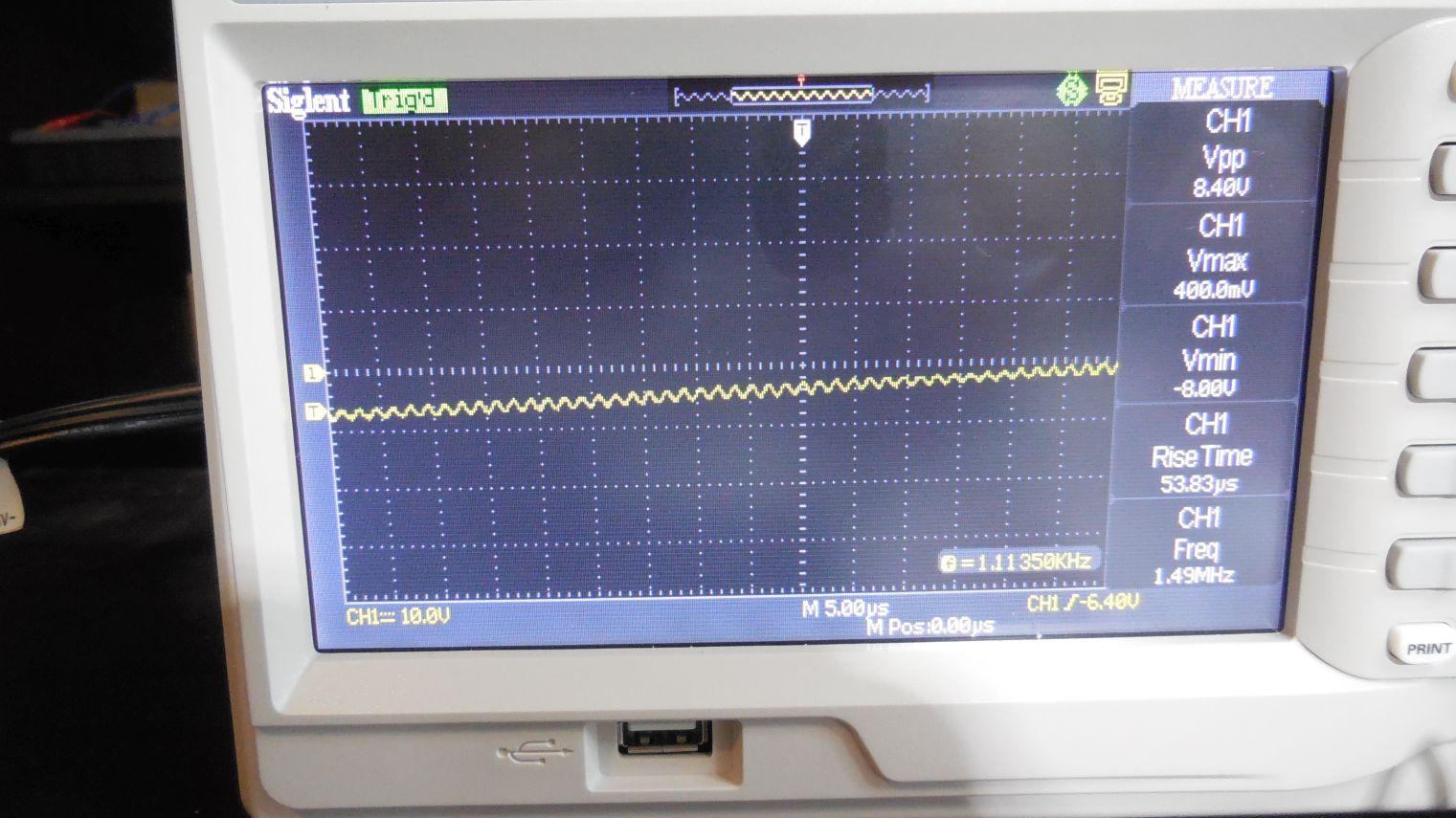

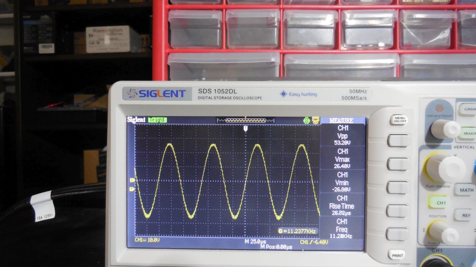

Elvee,
Have this amp (passive version) up and running.
All smooth, but - small problem with waves - there is some modulation on every wave. I noticed that all waves looked 'thicker'.
All with 8 Ohm resistive load, 42V rails.
Same output devices as before: MJL21193/4.
And with two 22nF caps for 2nd opamp (LF356) to +Vcc frm pins 1 and 5.
See images.

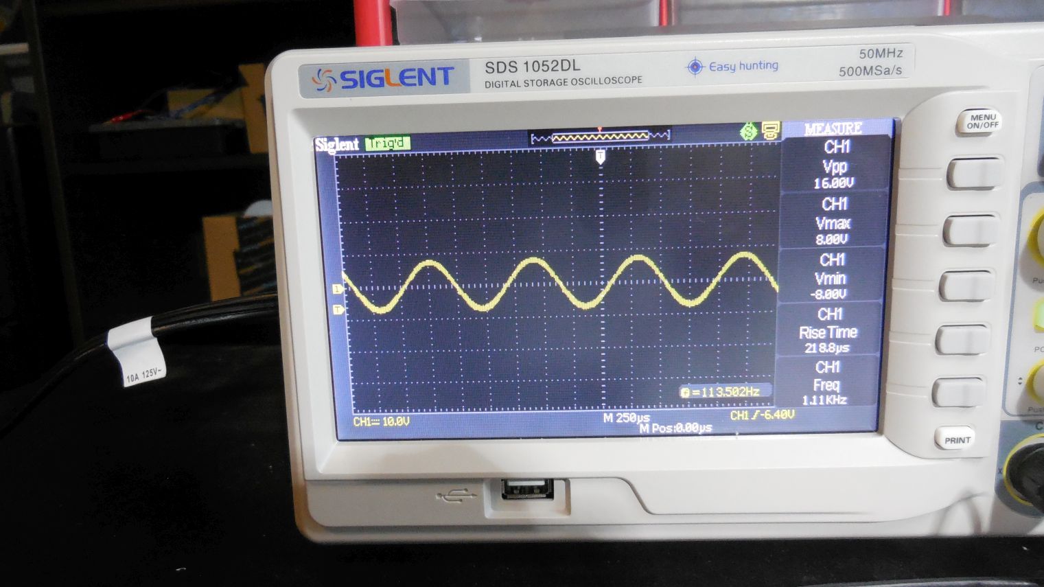

Most interesting are the last three photos when I zoomed to show the modulation.
Last image is a zoom at 1kHz sine.
See images.

Tried with LT1056 - same thing, but amplitude of oscillations is bigger.
These oscillations are present at the output of the 2nd op-amp,
but not on the output of the 1st op-amp.

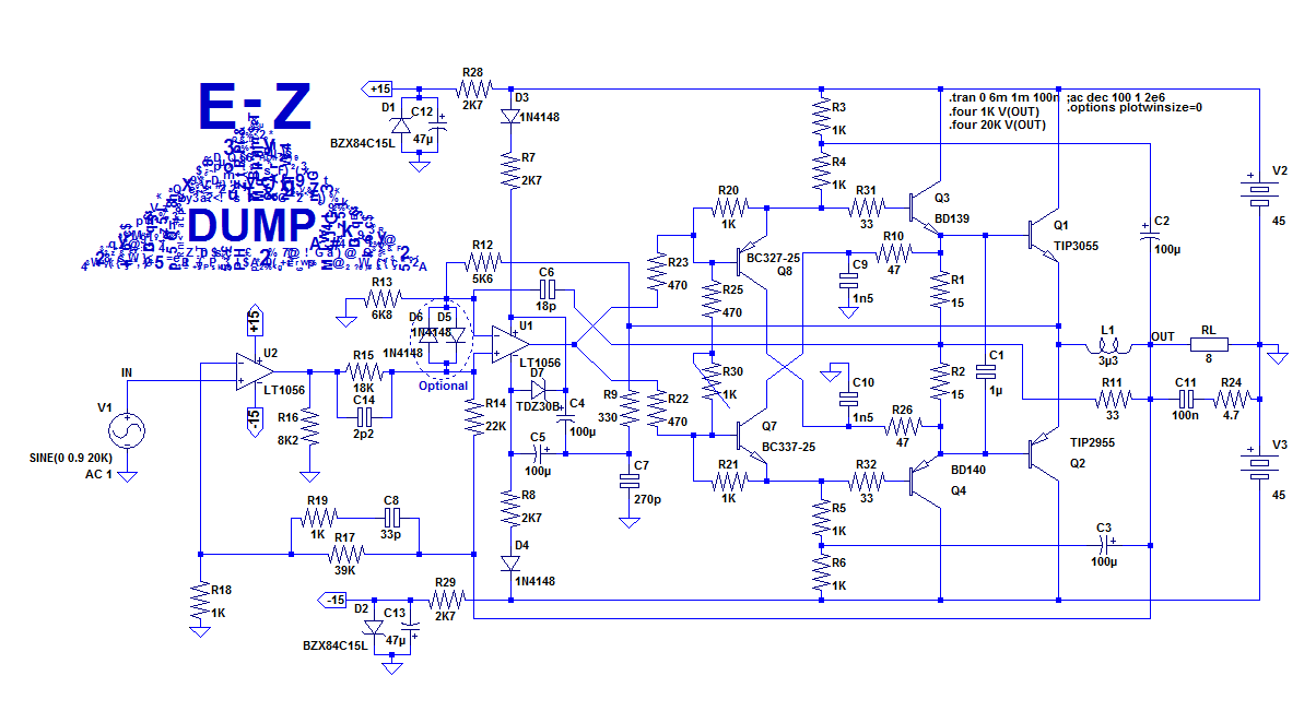

Also - 270pF capacitor (C7) is going to signal GND on my pcb.
That was my guess - to use signal, not dirty GND. Maybe it should go to
dirty GND?
There is also another difference between my previous (active EZDump) build and this one:
shifter transistors in 1st build were BC327/337 - same as in your sim.
In this build I used KSA992/KSC1845 - and when I was re-trying the sim this,
it doesn't work. When I tried to sim with BC546B/556B - this also doesn't work - oscillates in strange way.
I thought any small transistor pair will be ok for shifter transistors, can you confirm?
dirty GND?
Correction: BC546/556 work fine in sim, but KSA992/KSC1845 - don't.
No idea if this is related to the oscillations I'm having..

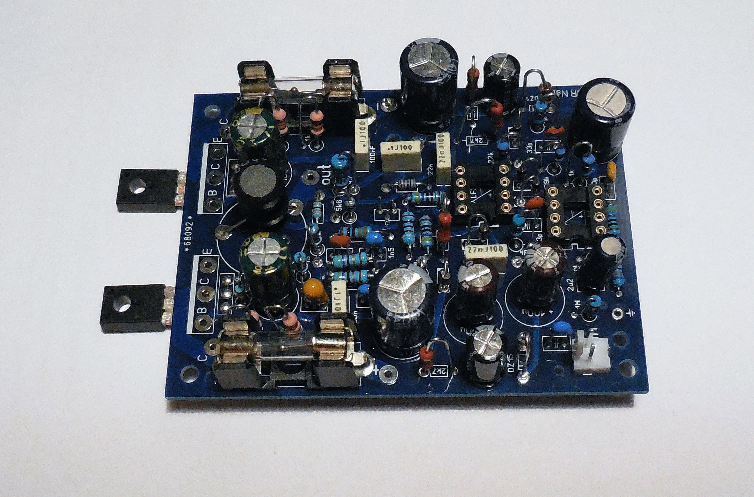

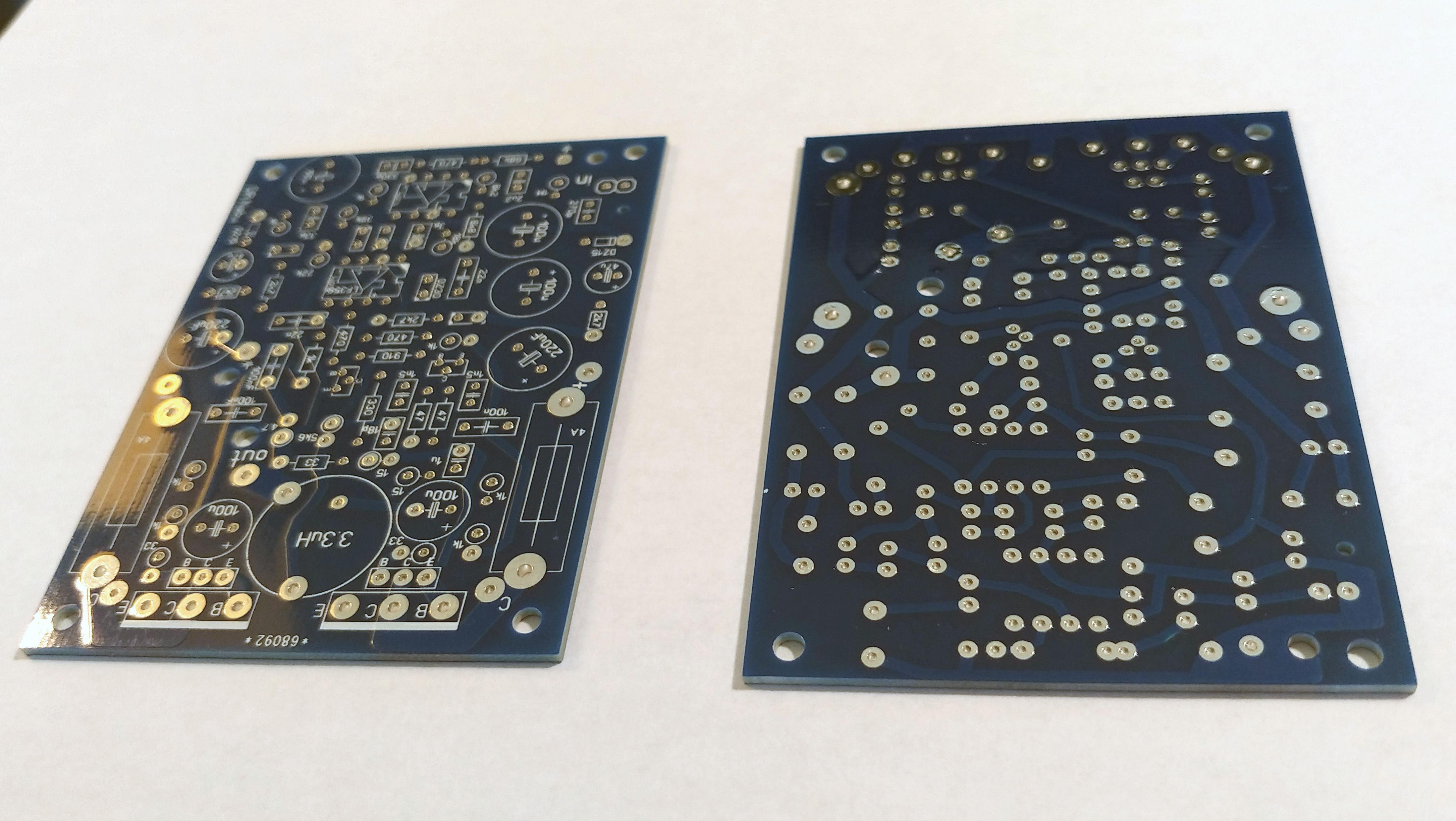

See images.

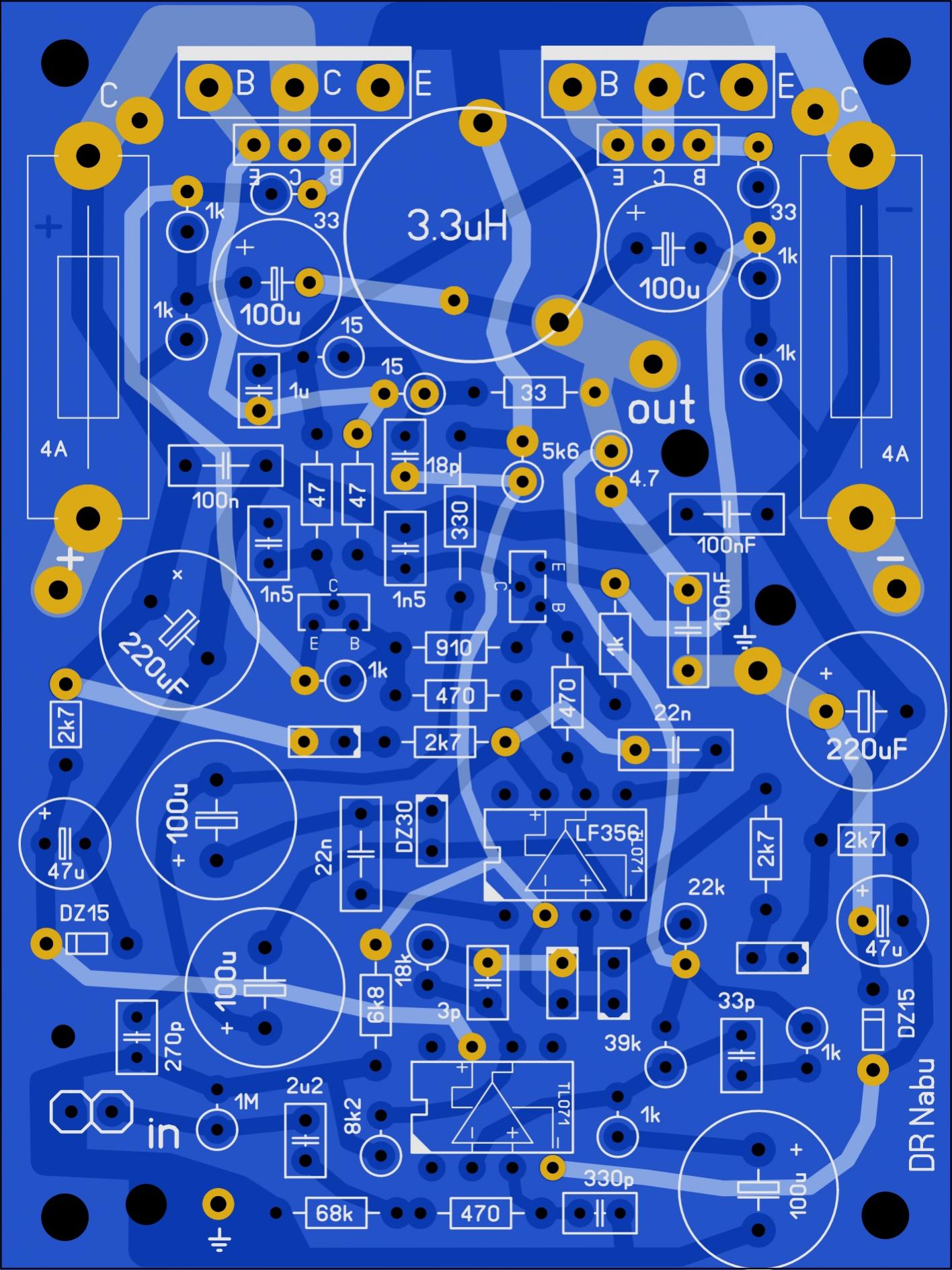

PCB is almost the same as for the 'active' EZDump amp built several months ago (and still working perfectly) , small changes have been made to acomodate simplified 'passive' scheme.
Asc file attached.
Asc file attached.
