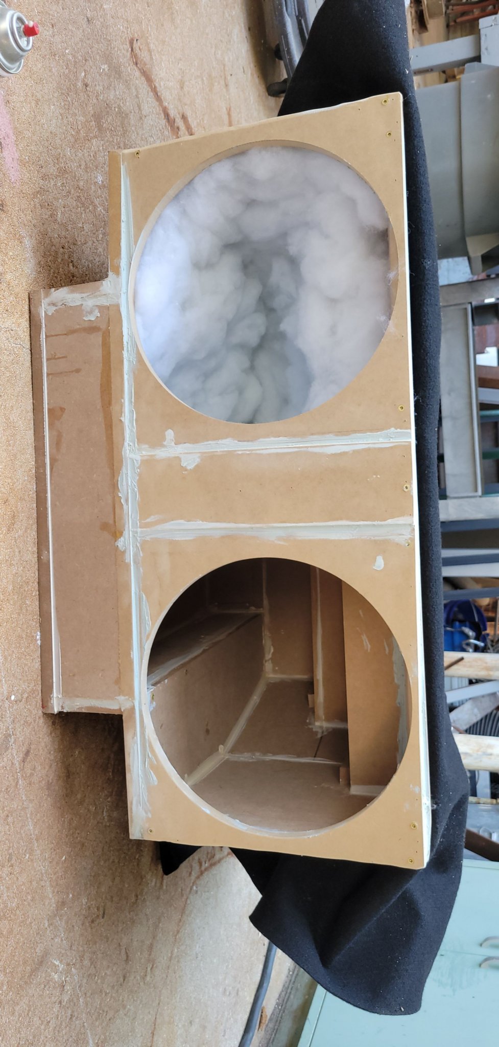

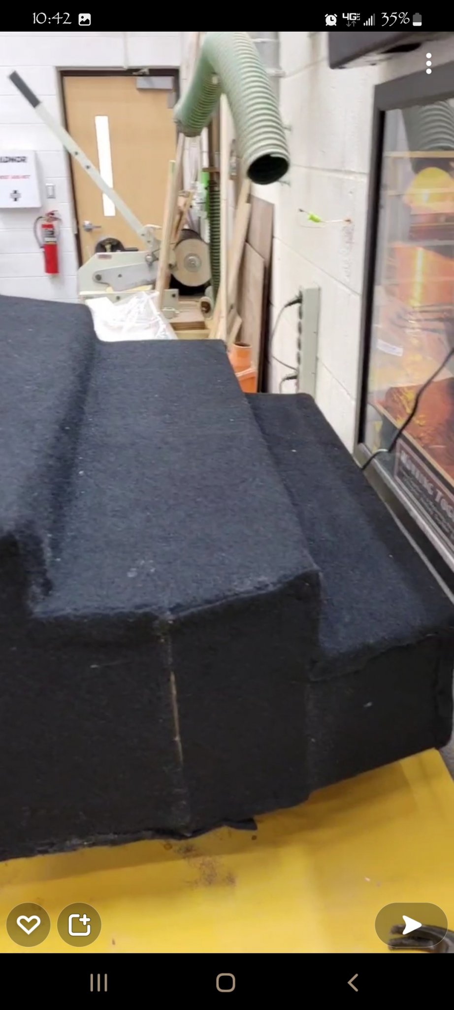

Would reinforcing all of the wood bonds with screws have any adverse affects? There's a few points where the wood doesn't join up flush, so if I could just add a few and reinforce it without any worries then it's just about done after the carpet and filling arrives around Friday-Monday. Will be uploading a new post once it's done showing all the steps I took!
It's good to use fasteners. The glue only holds to the surface of the MDF. It's fairly strong but it can be torn off.

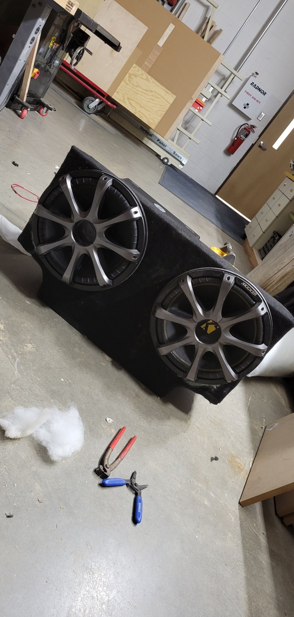

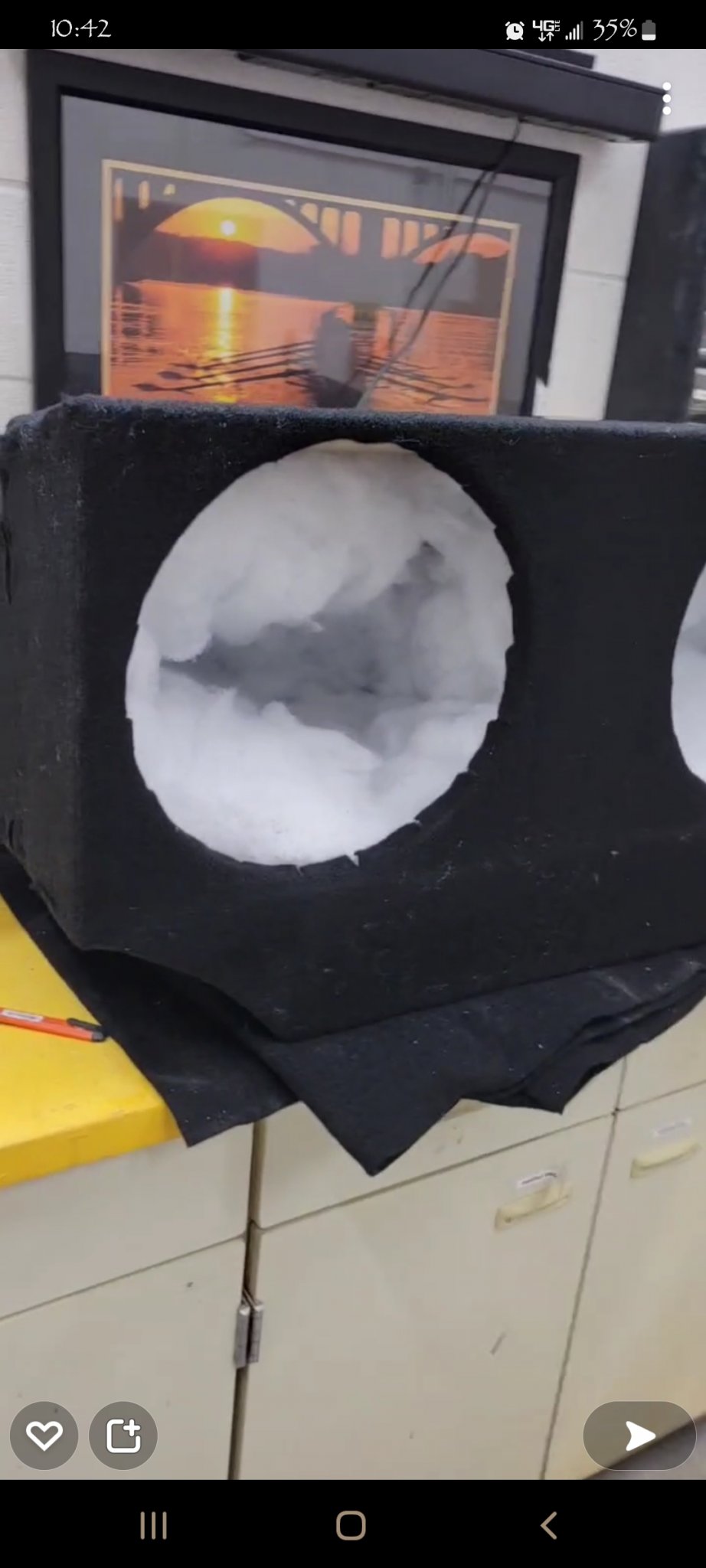

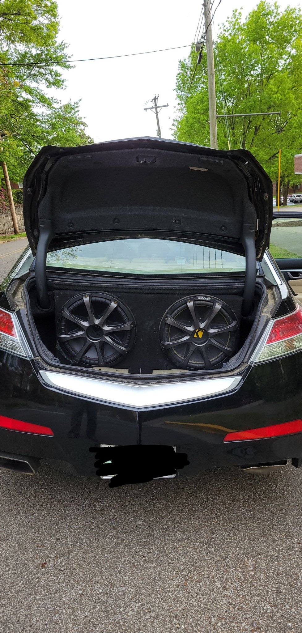

Enclosure is built, amp is setup, build is in place in the trunk! I really appreciate all of you helping me design and figure it out, it sounds absolutely incredible!

Well throughout the build, I measured and ensured it would fit with each cut. Hell, I spent a whole day reshaping the original design till it slid nice and clean into my trunk. It's a little late now, it's all said and done, but I did have slight difficulties with the 15's, but nothing that I wasn't able to figure out and resolve.Custom Enclosures in AUTOMOBILES.... MY experience?.... Build the BOX first... THEN buy the proper speaker for your end result. GOD KNOWS what the internals will be in regards to building a custom enclosure, THUS... build the box first. And yes I know you want 15's...... LOL.... but a pair of 10's will surely perform much better in that space my friend. Said that to so many customers..... and in went 15's...LOL... Customer's always right... As your box goes, it should be removable in case of emergency. Well unless you use a FORK LIFT to install yer 800 pound enclosure. THEN ya will surely need AAA.... On the way. Once ya get the box built and fitted and its good, THEN do your internal measurements... Buy the correct driver for that space ya created. So goes custom enclosures. Can't remember the last time I built one.... 2006?.... PRE MADE enclosures... Came along. Up to that point I was making good money building one off speaker enclosures. Rumble them cars.... BDBD/2022
It weakens the wood at the join.Would reinforcing all of the wood bonds with screws have any adverse affects?

I've never seen an enclosure fail at a point where there was a screw. If you don't pre-drill, it can split the wood but a screw that had a pre-drill and a countersink for the head is incredibly strong.

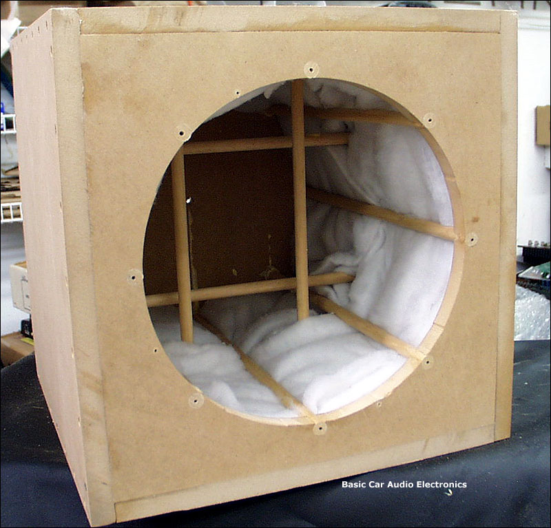

MDF is not very stiff, and heavy. This means any panel resonance is going to be lower in frequency. In a subwoofer the goal is to push potential resonances up above the speaker’s bandwidth. This is much easier to do with quality plywood. A woofer built of 15mm quality ply that dramatically outperforms a similar box made of ¾’ mdf. And it will weigh a whole lot less. At home that weight might not be important, but in a car it certainly is.

There are too many variables to generalize. This enclosure was used in my shop and hammered for about 15 years. It never needed any repair. The only thing I changed was that I used t-nuts a few degrees off of the dowels to mount the woofer.
