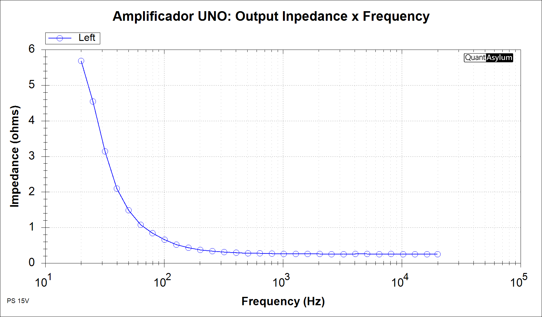

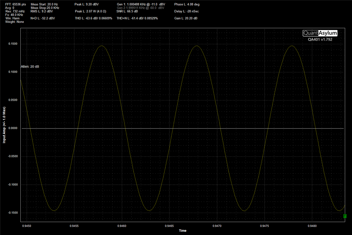

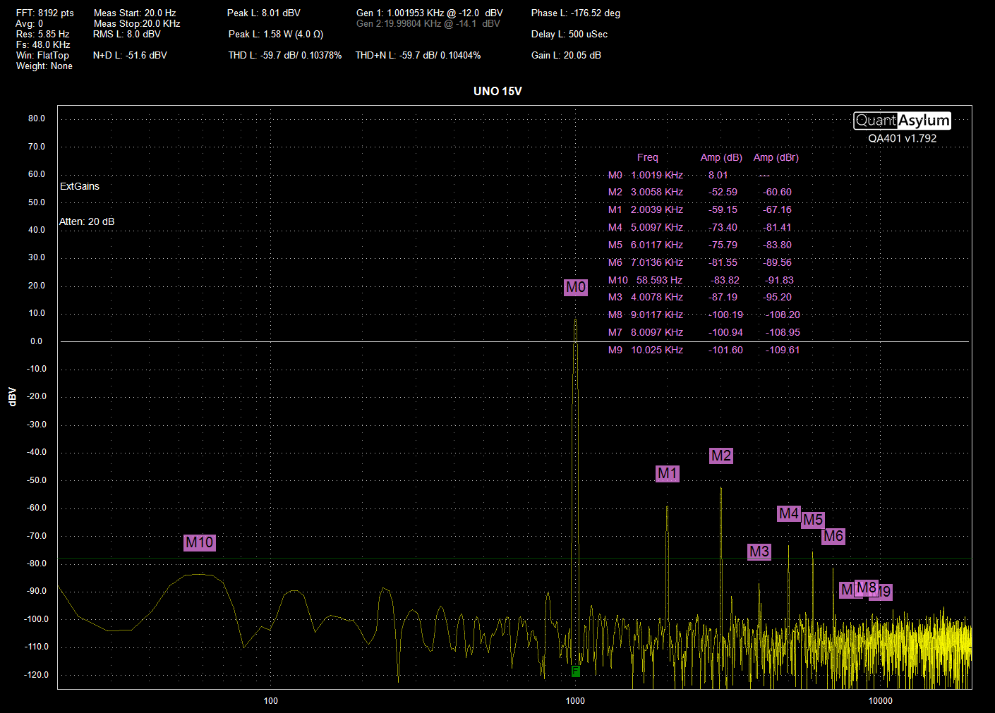

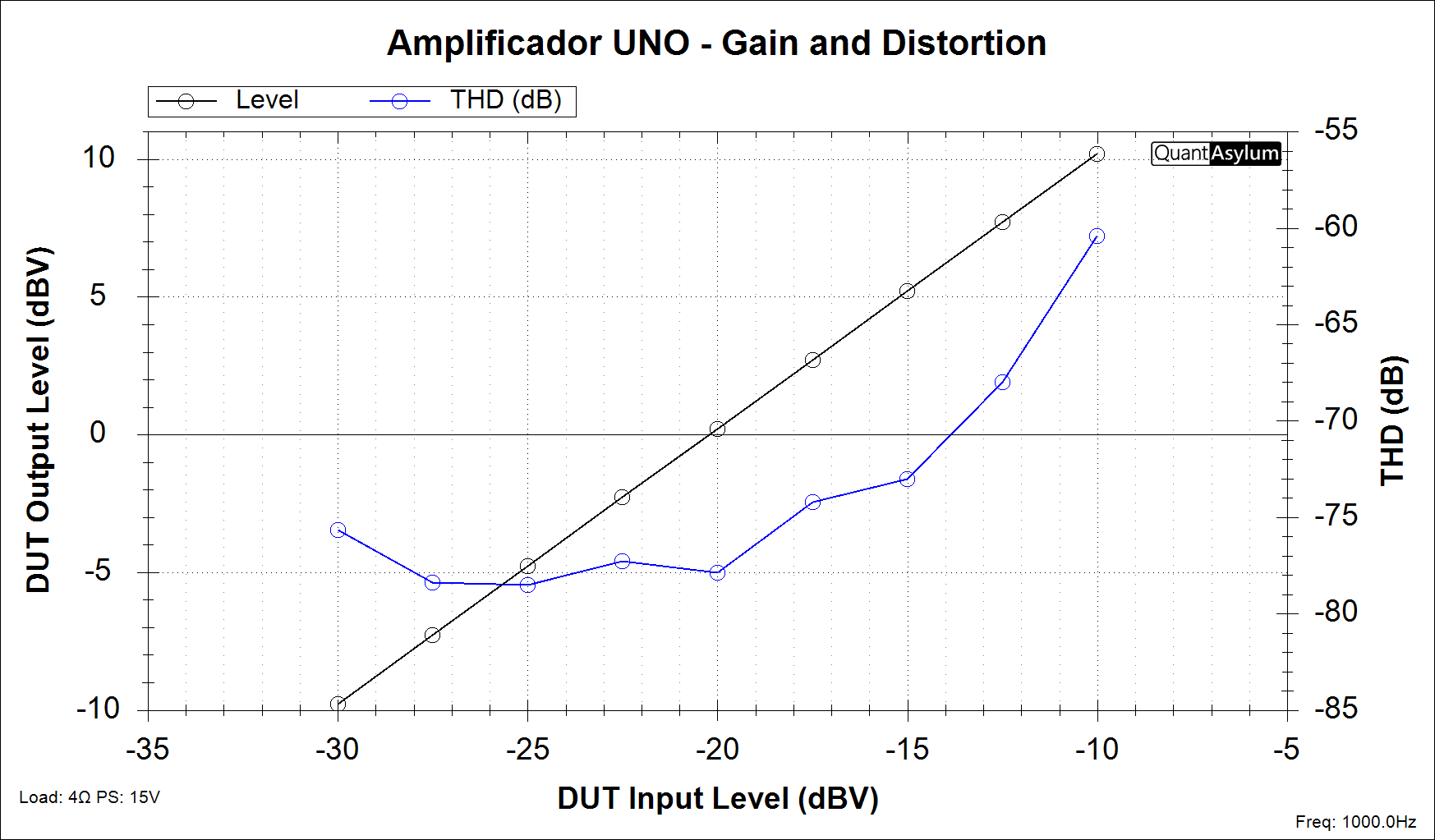

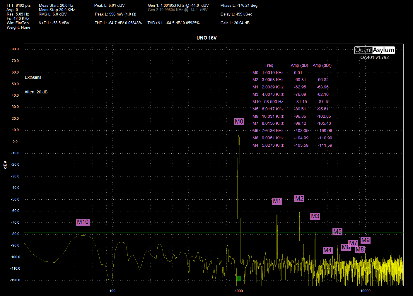

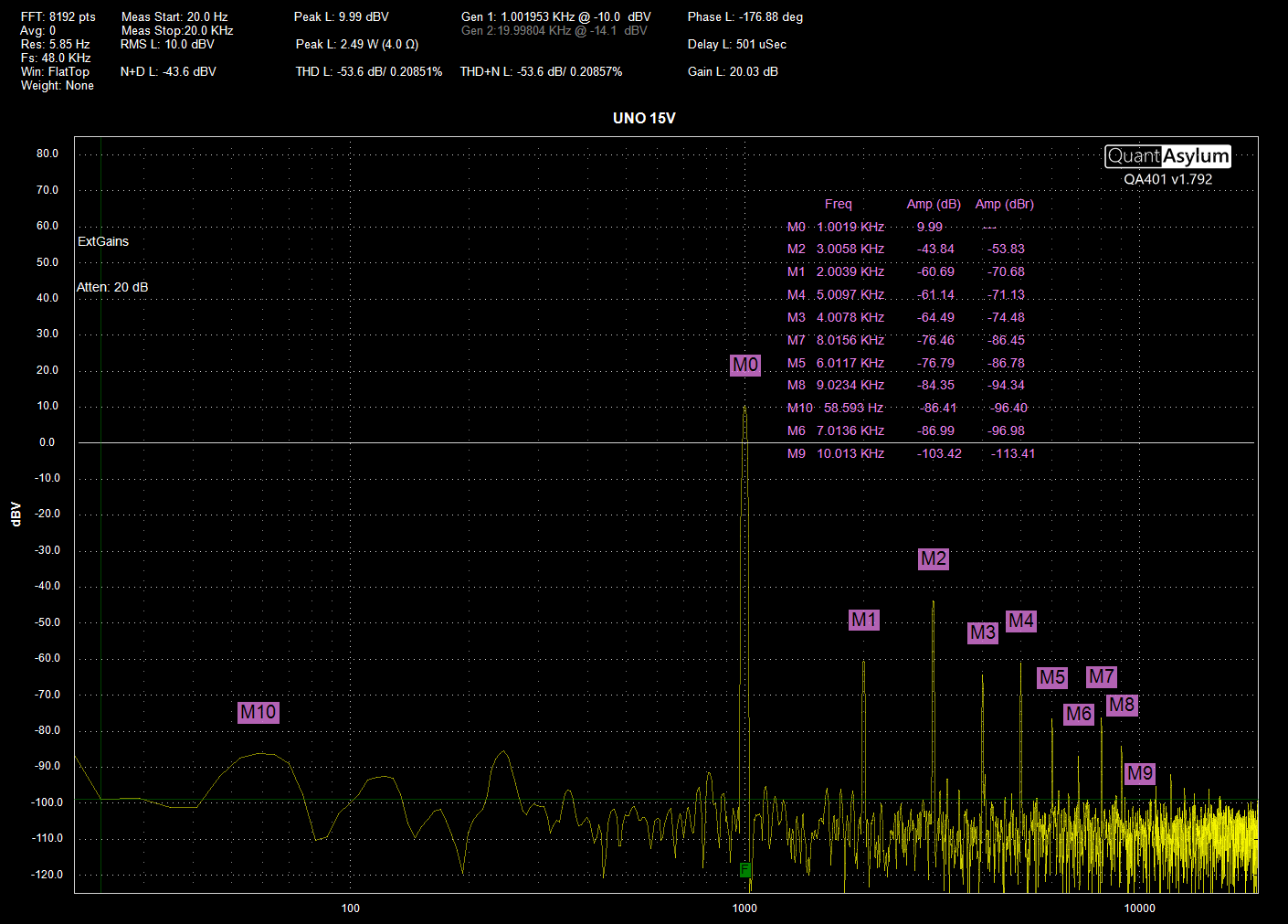

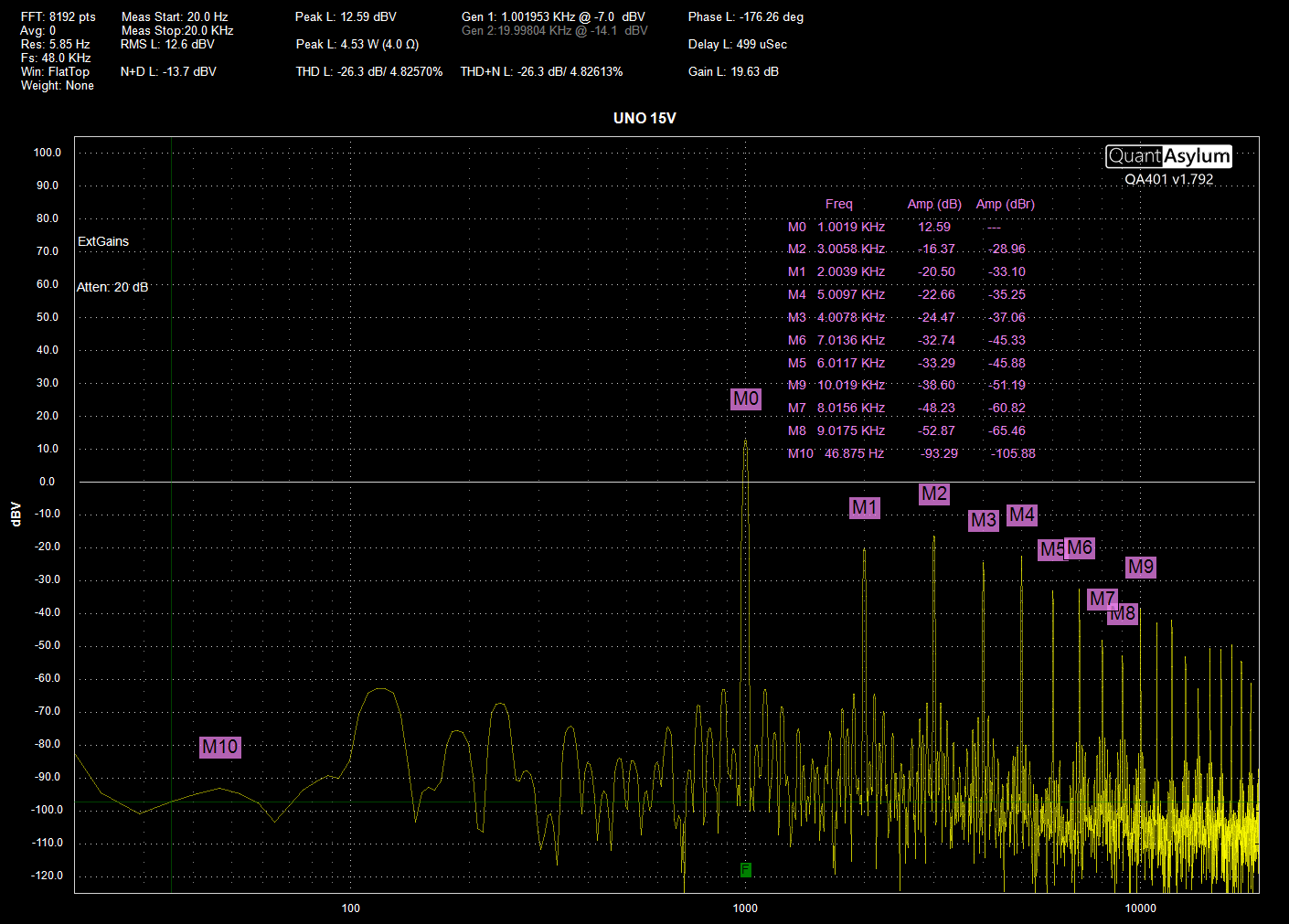

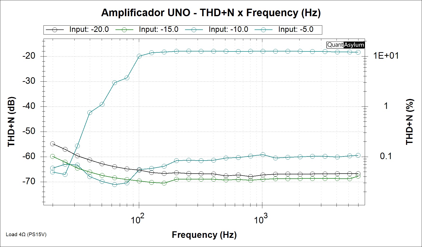

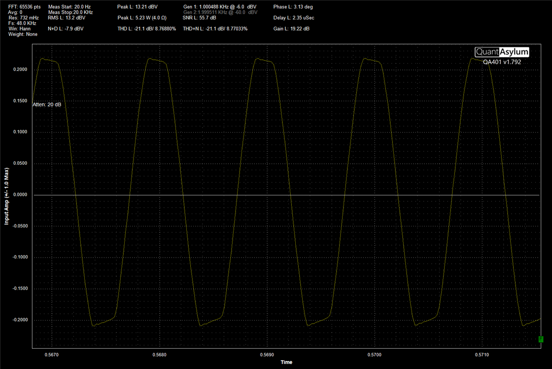

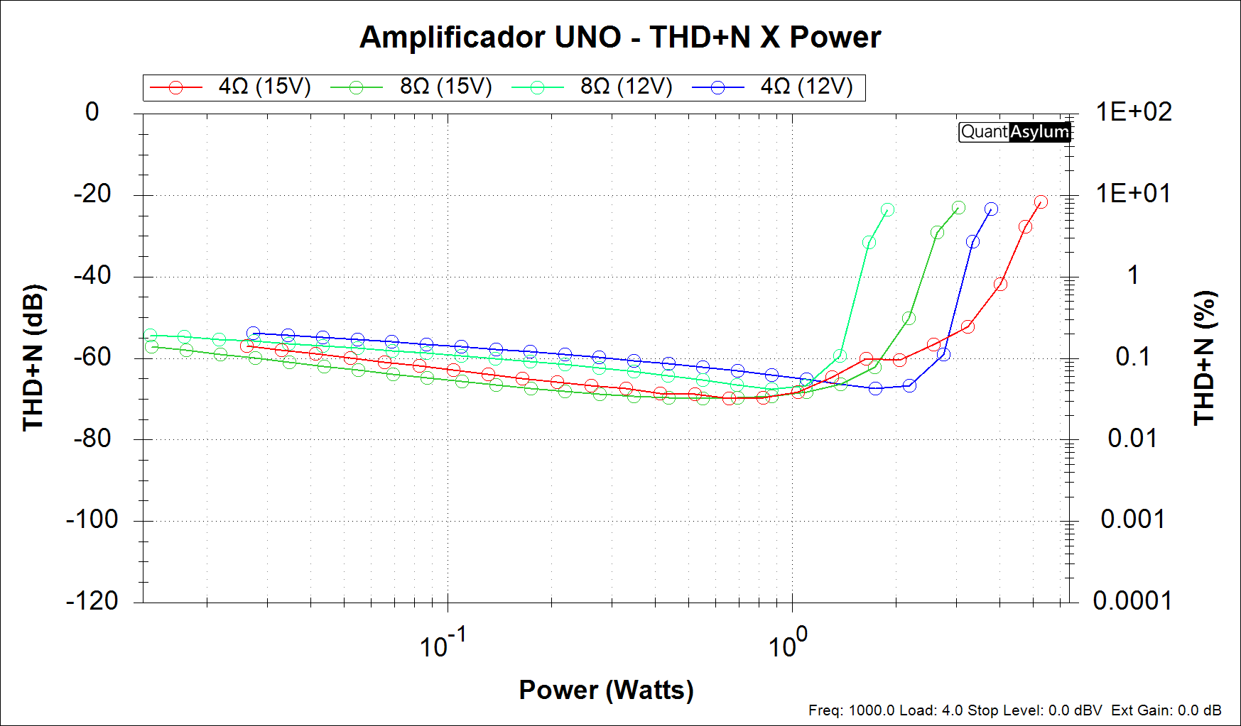

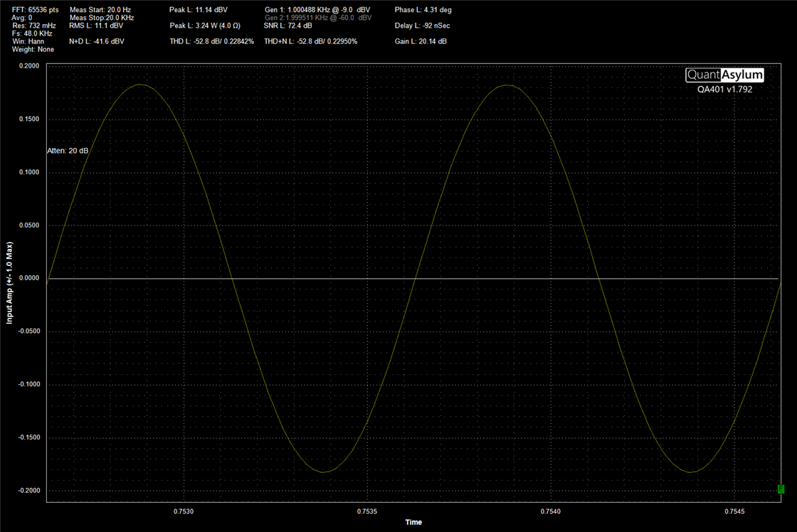

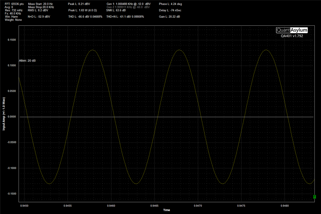

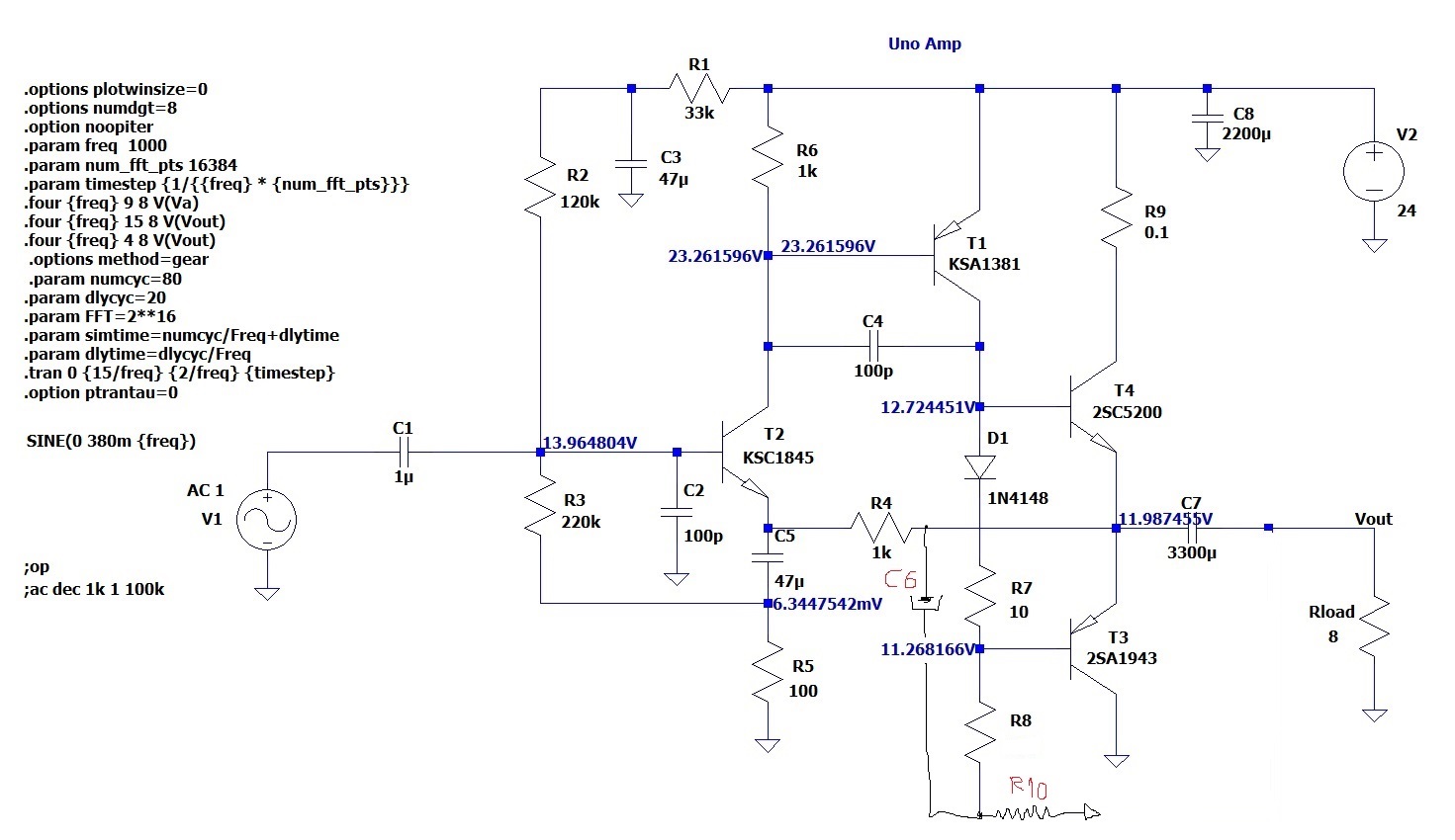

Extremely simple amplifier (4 transistors) with low THD.
Yes, but JLH did not have push pull output.
One thing I noticed with this amp that is unique: despite having output coupling cap, there is a slight 500mV DC offset due to the connection from the base of the PNP to the output after the cap.
This offset is not a good thing as voice coil will heat up a bit.
JLH A-class amp is also with push pull output ,
to avoid that output DC offset bias network need to be slightly modified by adding one more cap(C6) and one more resistor (R10),
this simple amp will sonicaly outperform many other solid state amps for sure because of his very specific THD spectrum .

> 40mA or so DC through the speaker? That's about 300mV offset voltage for an 8 ohm speaker.
Yeah, not top-shelf performance.
But it is only 5% of the peak output, so speaker excursion is hardly used-up. 1/10th Watt DC dissipation should not bother the 2+ Watt speaker needed. And it IS just 4 transistors, 3 stages. It seems a tolerable trade-off.
