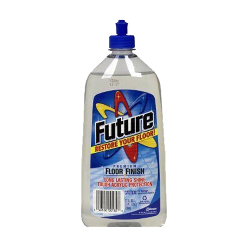

Seeing as I will be coating the entire interior surface of the speaker I picked up some acrylic floor wax. (The small bottles weren't going to cut it) A quick spray of polyurethane in a can... (the plaster rectangles might not take to kindly to being slathered in floor polish.) and we should be off to the races. 🙂 This is the same stuff made by Johnson that the guys use on the model airplane forums.

Hey Bud,
Is this stuff the same as the micro gloss?
http://www.buxnie.com/images/Product/large/238568.jpg
Alex
Alex
Honestly, I don't know Alex.
Many years ago ,when I contacted Micro Scale about buying quantities they indicated that the Gloss was an industrial strength acrylic floor wax, that they purchased in 55 gallon drums. I did not ask who made it at the time.
They are more closed mouth about it now. There has been a change in chemistry, about 10 years ago. I still have some of the earlier material and of course some of the current also. When I used a lot of the material, the earlier product sounded slightly better and seemed physically more flexible.
To find out, all you really need are a pair of silk dome tweeters, as cheap as possible.
Bud
Bud
Bud
Can you elaborate, Bud?
Silk dome tweeters are very susceptible to EnABL and Micro Gloss. A stiffer material will raise output and may introduce obvious FR peaks. A softer material does less damage.. So, if the material under question matches the Micro Scale Gloss in performance change, then it is for all intents the same material. Easier and cheaper than messing with wider range drivers.
Bud
Bud
