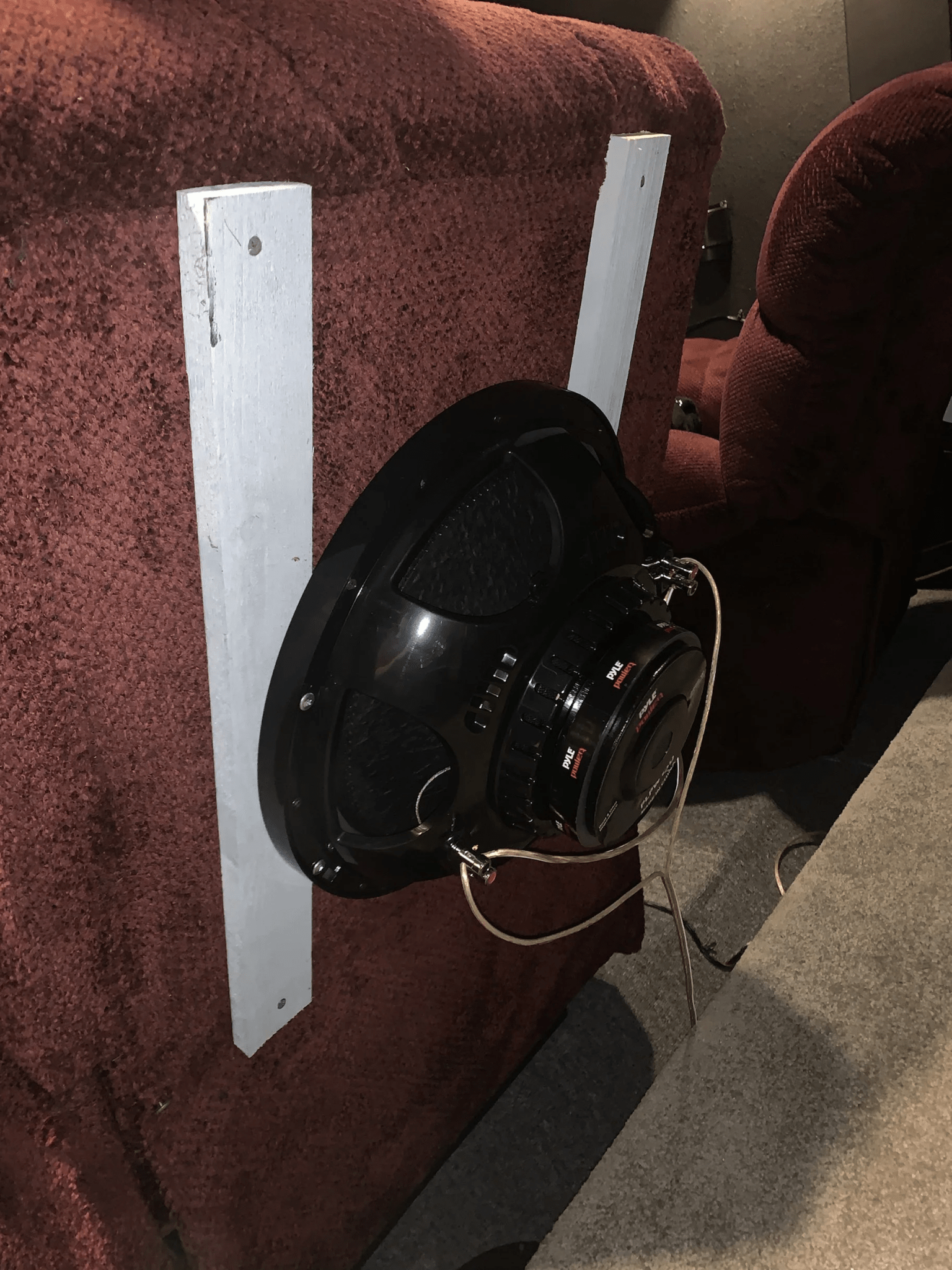

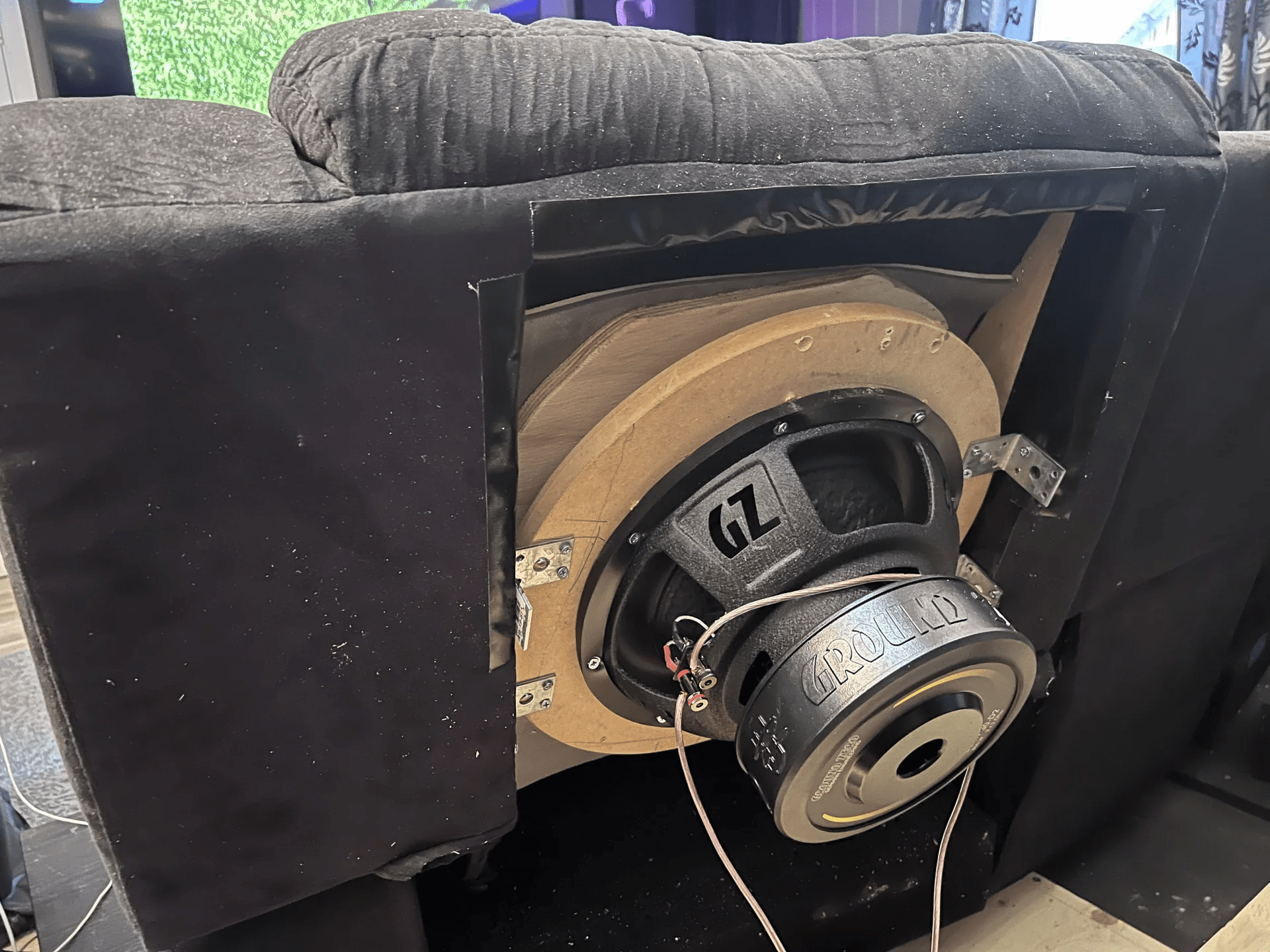

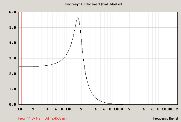

The HoverEzE inner tube actually creates a small sealed chamber, not an open baffle.Since the HeZe leaves the back side of the woofers as open baffles, depending on your listening level, you might use your existing 12" and be able to dispense with anything else between the HeZe and the 8" drivers.
For it to work as intended, that is, shake what it is attached to, requires a leak free seal.
Unlike an open baffle, the small chamber volume raises the box resonant frequency (Fc) to many times that of the driver's Fs, resulting in ~12dB per octave drop below Fc:
The small variable volume chamber limits driver excursion, and increases the impedance to around double it's Re (DC resistance).
The simulation above is using a LAB12C with a Re of 3.11 (4 ohm nominal impedance), Fs of 22.85Hz, 13mm Xmax, rated for 500watts (EIA 426A free-air) or 1000watts "Music Program".
120 volts into 6.22 ohms is ~2300 watts, below 40Hz excursion would be limited to ~2.5mm even given that power:
That said, if the "Hover" chamber would (or could) expand to double (from 5 to 10 liters) on the compression stroke, excursion would also double, but at that point the seat would be thrown up 50mm (2inches), which would be a real tactile experience 😉

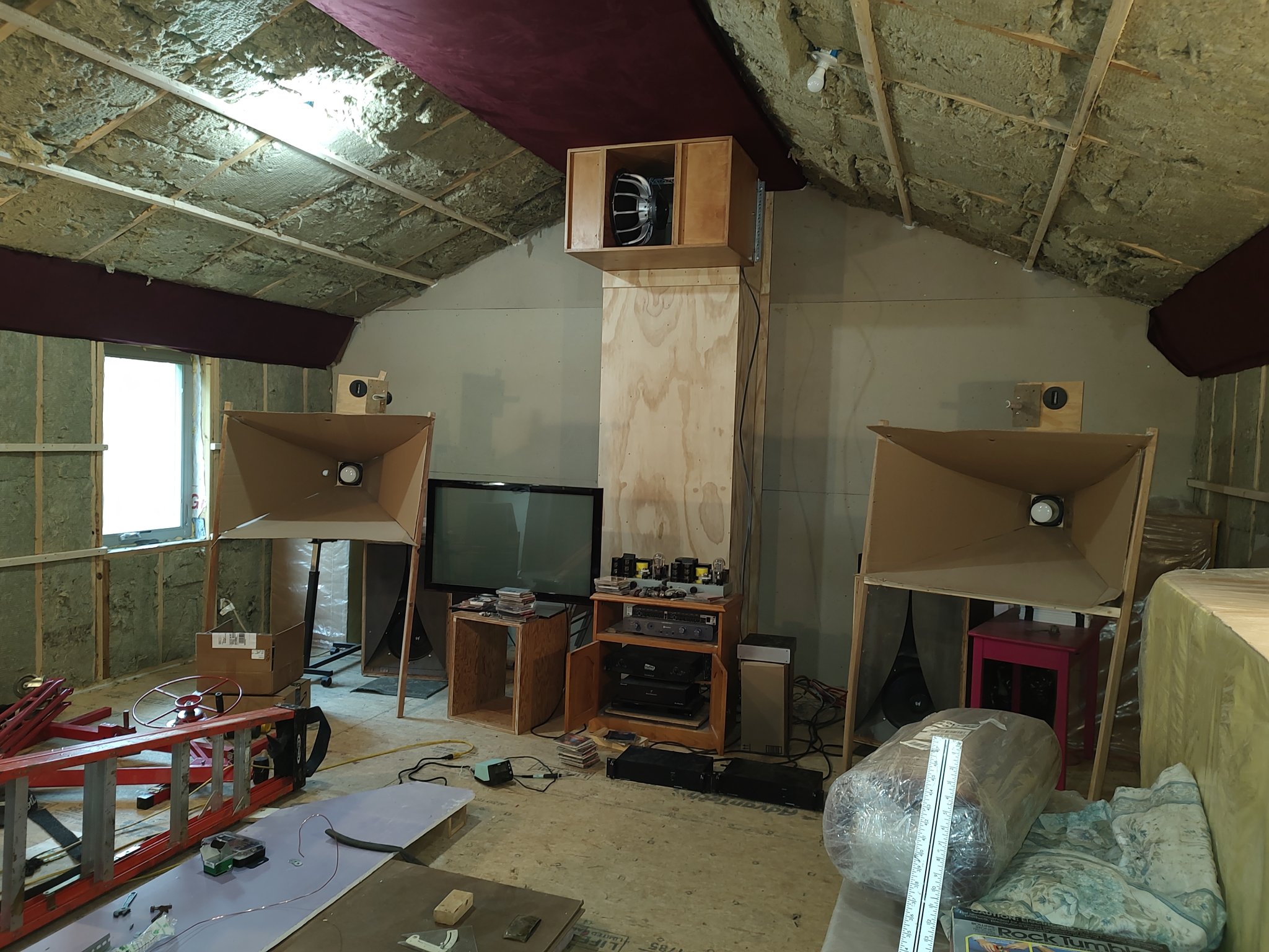

Here is my audio room still being constructed with my audio system set up in it. You can see the large, tall, tapped pipe subwoofer in the center back side of the room. I mounted the subwoofer drivers near the ceiling to make more floor space. There are two subwoofer drivers, a pair of 18 inch Avalanche woofers (27mm xmax) mounted in push-pull arrangement and the pathway from the backside of the driver to the front side is 22 feet, although my plan is to add an extension to the mouth of the opening extending the path length to 30 and potentially even 38 feet. This subwoofer is intended for a home movie theater and of course can handle any lower frequencies for music with ease. I have a frequency peak at 20 hz, which is not surprising given the length of the room (26 feet), and by adding the extension and venting the subwoofer into the middle of the room, I hope to achieve a flatter frequency response.
I chose a tapped pipe arrangement because tapped horns are really for high efficiency, emphasizing bass in the 60 to 100 hz range, while tapped pipe subwoofers are less for the upper bass frequencies, and more for creating a flatter frequency response. These Avalanche drivers have an FS of 16 hz, so designed for very low bass frequencies. I have a 1000 watt Hafler amp driving them so quite capable of loud, deep bass - its impressive!!!!
This tapped pipe subwoofer handles below 60 hz and I use Karlson speakers for 60 hz to 500 hz, and Lowthers in front waveguides for above 500 hz, and supertweeters for above 8khz.

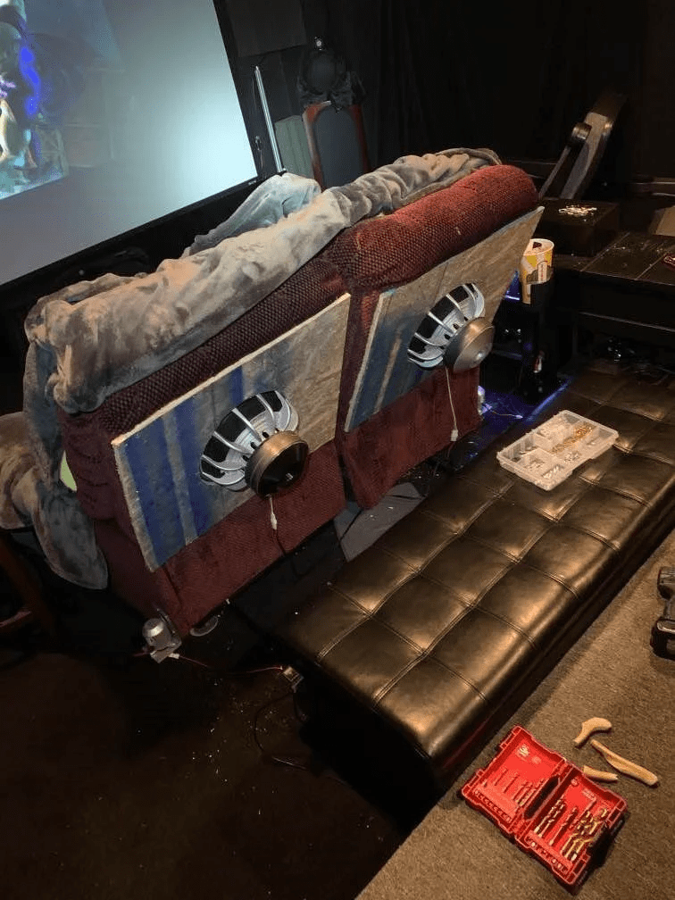

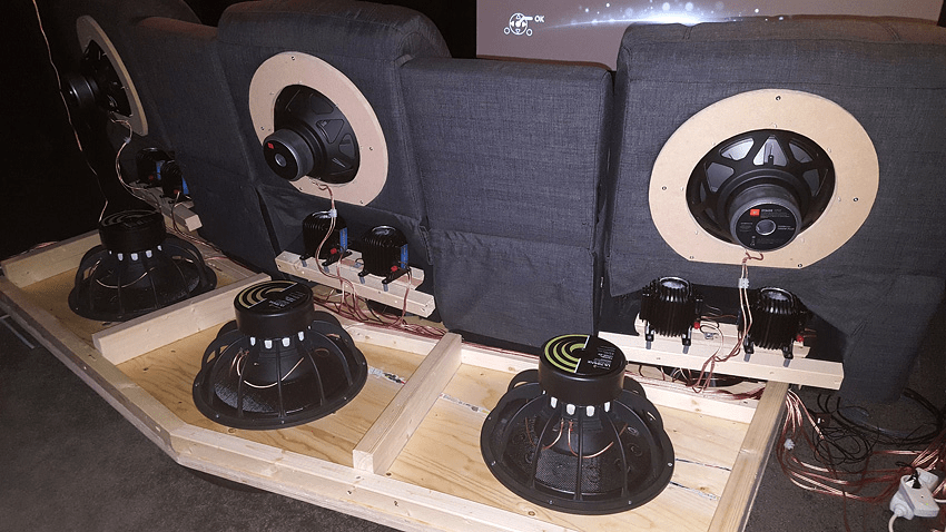

And brown notes! 🤣One thing I would like to note is that anything vibrating a structure like a couch, sofa, love seat etc will cause distortions.
For an experiment I would buy four Dayton Audio UM18-22 18" Ultimax and a big honken amplifier that has output in the infrasonic region, then put the drivers in a sealed or IB enclosure and equalize them to produce output in the 5-20hz range. This should get enough infrasonic output for experimental purposes without breaking the bank. Also, you can stay away from ******* off the Mrs by screwing woofers to the back of the couch. Seriously, do you drop a quarter in and say, “ Hold my beer!”hello all,
