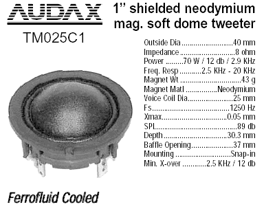

Swan (i think its them) build a little "pod" tweeter, and there are neo tweeters from Audax* (Morel too IB, probably others) that aren't much bigger than the dome that would be ideal for mounting in a small, minimum diffraction housing.
*TM010A1, TM010A7, TW014B5 & the TM025C1 pictured to name a few

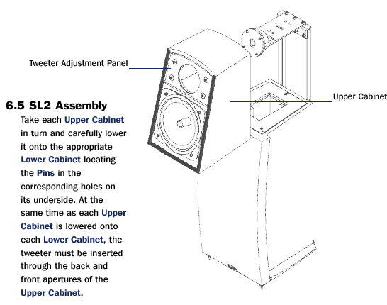

About Tweeter Mounting
Here is how Naim has done in several Loudspeakers.
This allows adjustment of the the tweeter direction.
And I imagine it avoids the tweeter to
be affected by resonances in the frontbaffle.
This is a flexible solution - to a degree, at least
Picture is from Naim SL2 user manual

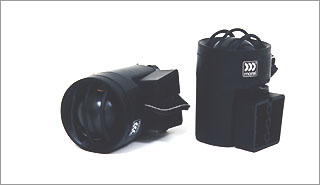

Morel MDT 38 (41, 43)
pinkmouse suggestion 🙂
Morel MDT 38 is a Top Mount Tweeter with chamber.
A very good alternative for separate, adjustable tweeter.
Morel is high quality.
They have several tweeters on this page
both with very small diameter and normal 110mm fitting.
MOREL Tweeters - Features, Data & Specs
Picture shows MDT38
Picture shows MDT38
