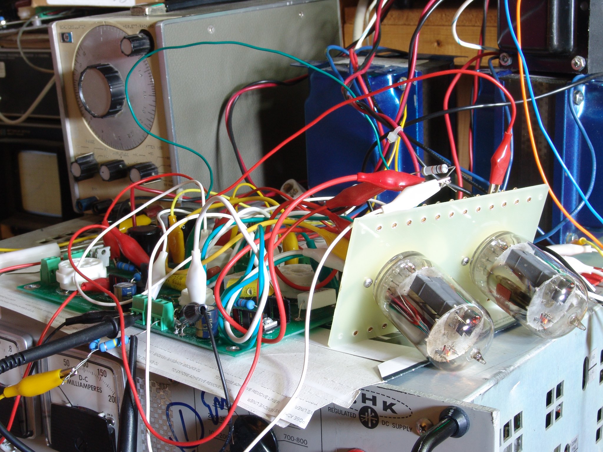

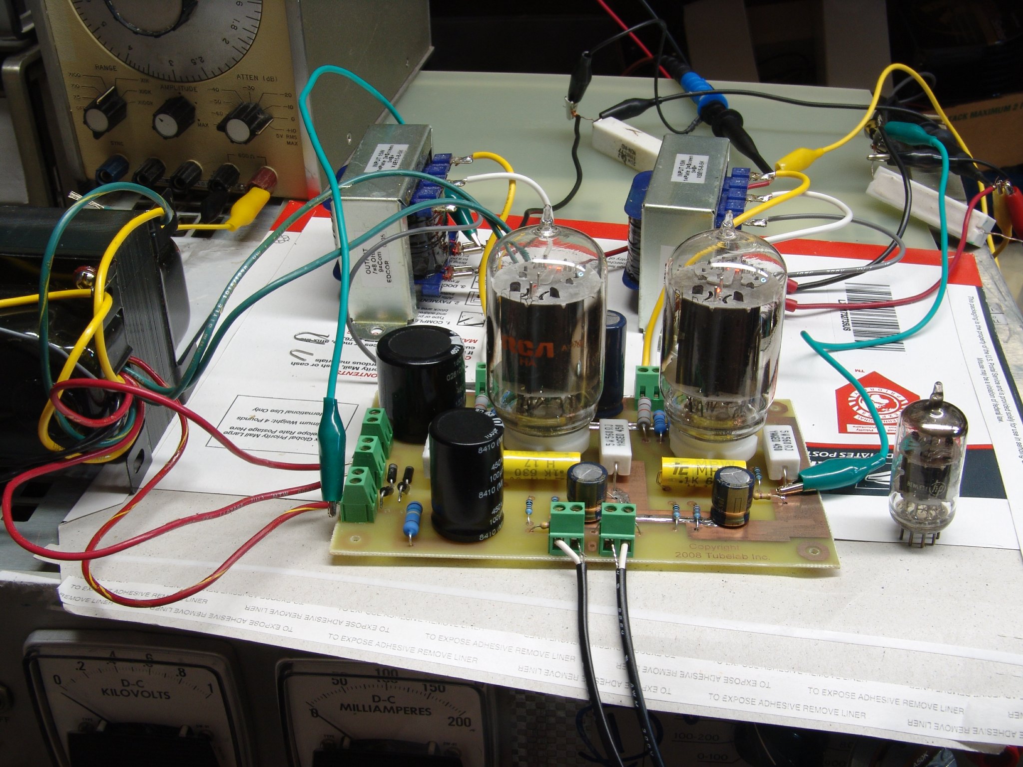

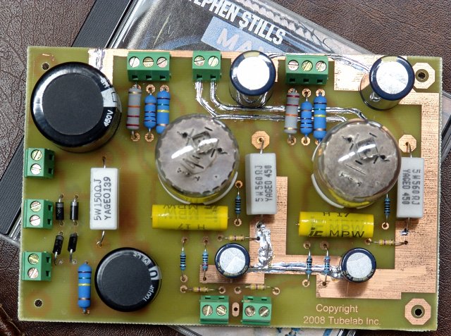

It could be made to work, but even with proper insulation there will be possible issues. We know that the SSE is tolerant of sloppy wiring. I expected a nasty humming, howling mess of noise and distortion when I made this clip lead furball with the tubes and OPT's offboarded, but it just worked at first power on. It was however driven by the test oscillator seen behind one of the OPT's and then a CD player. I guarantee that it would not have worked if driven by a turntable and phono stage. The furball of wires was eventually distilled down to create this SPUD board.

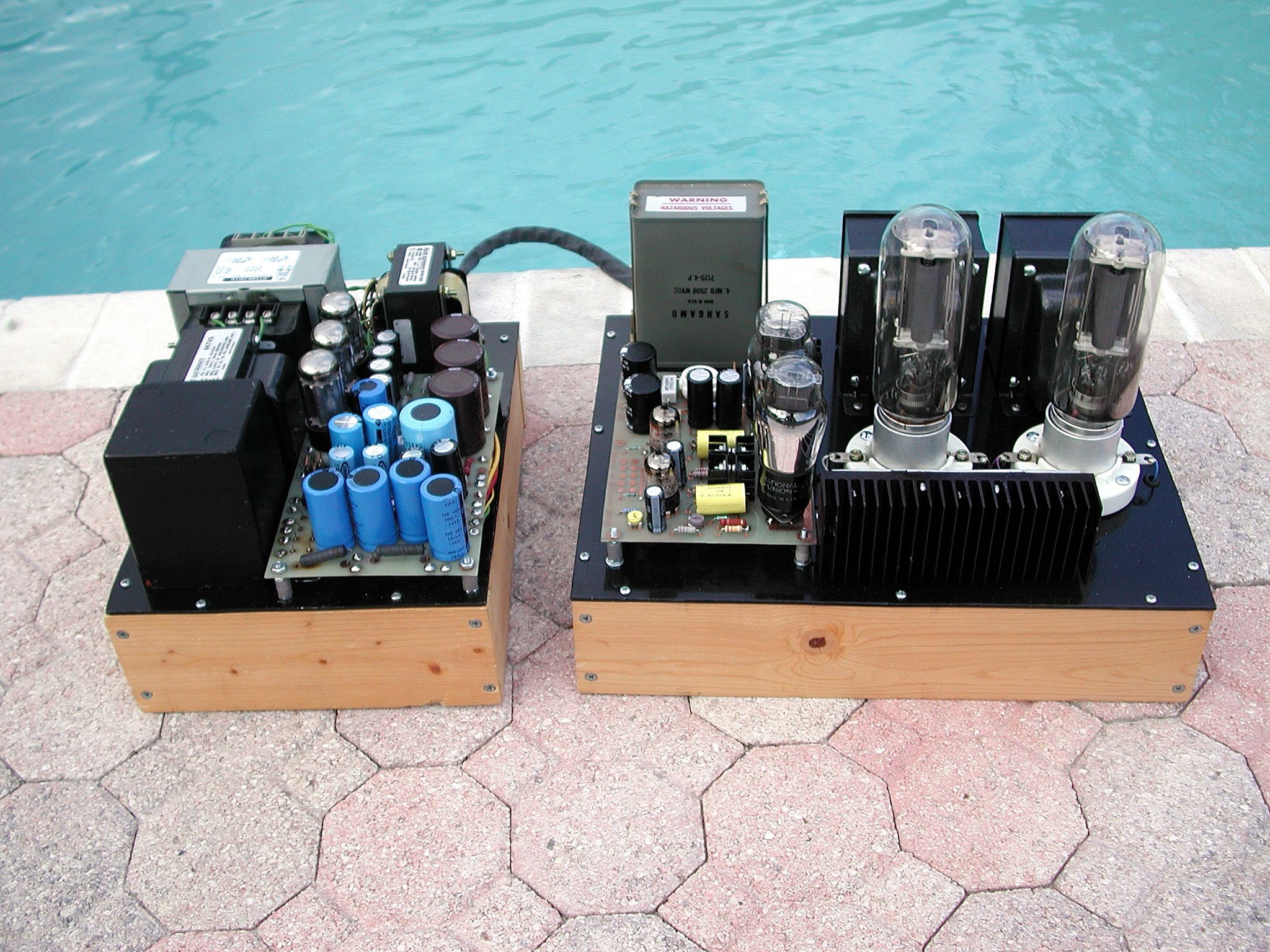

I built this 211 / 845 amp about 20 years ago using a separate power supply design. The amp uses an early prototype of the original TSE to drive a pair of 845 tubes which run on 1100 volts. There are two power supplies in the small chassis, one runs the TSE board, and the other runs the pair of 845's. The connectors are "Cinch Jones" connectors which used to be in available at Digikey. I still see some listed at Mouser. The published voltage rating is 250 volts. I used a connector with more pins than I needed, placed the 1100 volt pin at one end, and left all adjacent pins unused. The amp was used often for several years, but fell into disuse when I started building powerful sweep tube amps that ran on 500 volts or less. It was robbed for parts and the remains were sold at a hamfest a few years ago. The buyer just wanted the OPT's.

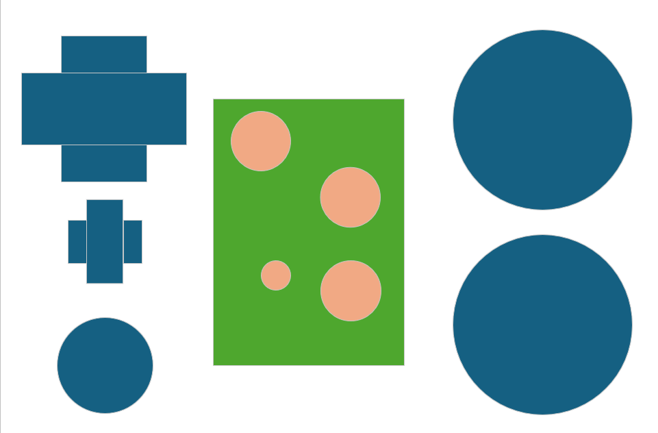

The max dimensions of the laser cutter are 12x24. I was going to use the laser to cut pieces of plywood, then stack and glue to make a chassis plinth with a nice radius on it, so that means the top plate can be a max of about 11x23. I was going to make a trial plywood top plate, just to test the fitment, before sending the SVG off to a CNC place to have a sturdy metal top plate cut.
11 X 23 is quite large. One option is to rotate the board 90 degrees, have the rectifier and power transformer one side, then the output tubes and OPTs on the other side.
Do you have a drawing package? Can you show us where it is cramped?
Looks like plenty of space.
This is the format I think I will use next time. The rectifier to the back, OPTs on the side.

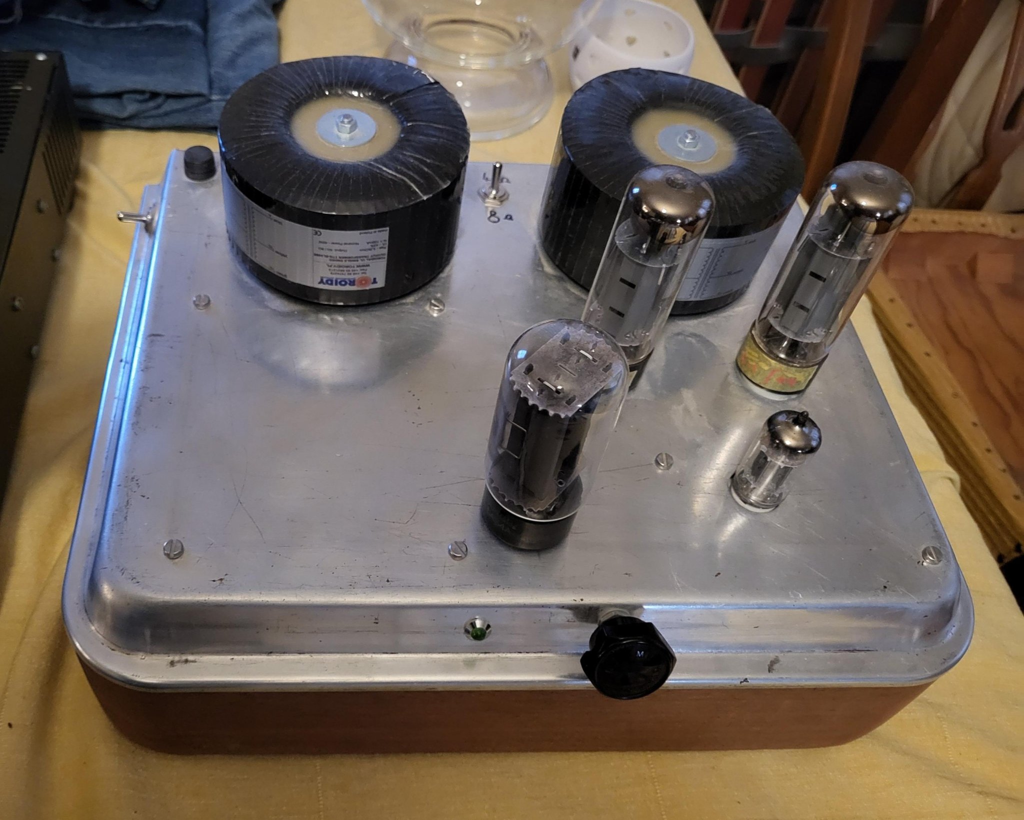

My current one is built on an old cooker tray and is similar to your plan. I chopped the wrong side off the tray, so it is a bit congested underneath. The power transformer, choke and supplementary notor run capacitor are inside.
