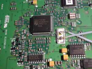

Let's try a bigger picture of the detail.
Note that the crystal has been destroyed while trying to pry it away from the PCB. I simpley soldered the 'clock out' from Elso's clock onto one "leg" of the crystal while the ground went to the ground of one of the capacitors on the PCB.

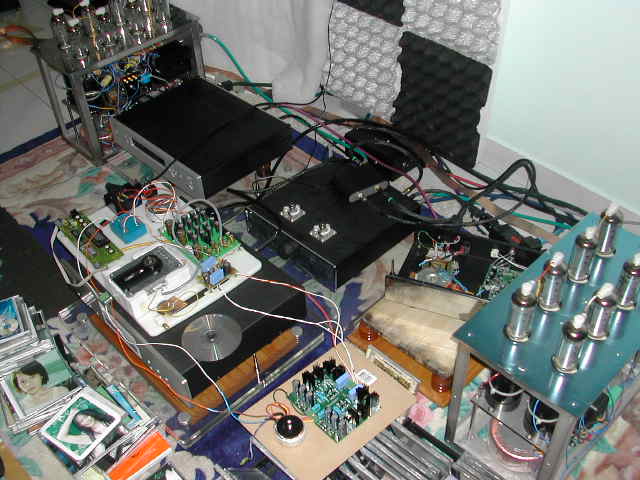

joeling39 said:Here's a general view of the whole setup.
CD Pro module on the left, Elso's clock in the middle & power supply for Elso's clock on the right.

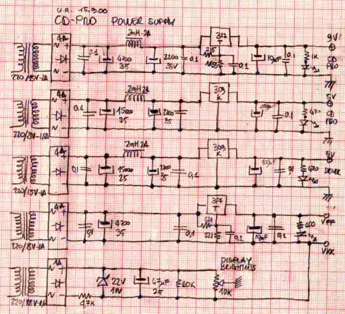

Joe,
Can you post your schematic that you are using for your power supply for the cdpro II? I am in the process of planning out a cdpro II project, and I am not sure what to use for the power supply.
Brian
