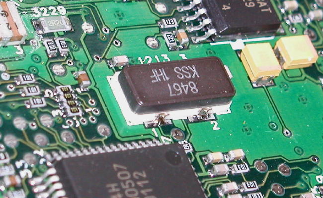

joeling39 said:Another picture
Hi
From the picture I see that they did their utter best to place the crystal supporting capacitors as far away from the chip, well done boys, now the RF currents flow all over the board..........
Once you have measured and investigated these aspects, it is so easy........
regards,
Cutting Traces
Great idea Peter!
Maybe it is a SMT crystal, I have never seen a thingie exactly like this before.🙂
Peter Daniel said:What about just cutting traces, insted of removing?
Great idea Peter!
Peter Daniel said:Here's the better look, for everybody interested. It is SMD and shouldn't be a problem desoldering it at the 4 points.
careful guys, this SMD can be glued as well
Re: Crystal???
The glue is evil. But the Sony SCD1/777 one is real easy. Solder wick the joints, and use a 35W iron on the body. Came off straight away and still worked perfectly!!
-------------------------------------------------------------------Elso Kwak said:Hi Joe,
This looks more like a SMT crystal-oscillator to me, just as in the Sony SCD-1 or 777ES. Very difficult to remove!
Best done VERY carefully with a hot air gun.😎
Were some posts on AA on this issue.

Sorry for my late reply - I was offline for a while 😎
Indeed the input clock pin is CRIN - 16.
Yes I modified more units type vae1250 which uses the same SAA7324. The simplest way is to desolder pins 15 and 16 from the pcb and feed clock into pin 16.
I will use CDPRO2 in my future cd-project and I'll be glad to share some results.
The overall sound was pretty good 😉 I recommend this modification.
A picture with cd-player that used this approach can be found
here
The product is no more available 🙁
here

I am sorry Elso and Guido
The reason why the SAA7324 fail with your clocks is this:
Your clocks give out a 5 V signal but the SAA7324 is a 3.3 V chip. (Absolute maximum rating for input signals are: 3.6 V)... (See datasheet from above link).
This and other 3.3V chips will be destroyed with the KWAK clock even if correctly mounted........
And there is really no way of attenuating the clock signal without degrading the jitter performance on this type of standard CMOS oscillator.
Good luck guys .. ;o)

Hi Lcaudio,
Don't be sorry, thanks for the hint.
May I suggest using the KWAK-CLOCK in this particular case with +/-3.3V supplies? This can simply be done by changing two resistors:
Make R5 8k66 and R8 12k. All other values remain the same. Best check the supply voltages before connecting the clock to this sensitive chip.
Except the one failure in this thread, possibly due to connecting a clock to pin 17 instead of pin 16, I have never heard of any failures.
Hi Lcaudio,

Oh, I never got into this part of the discussion. Ofcourse a 3V3 circuit should be fed with a 3V3 clock......
Destroyed: I doubt, at least, when series resistance is used (what i do) as the clock input very likely has ESD protection diodes, able to handle 10mA, if my memory serves me right (I think that chip was still made in Philips C075 process)
Anyhow, we should respect the voltages
