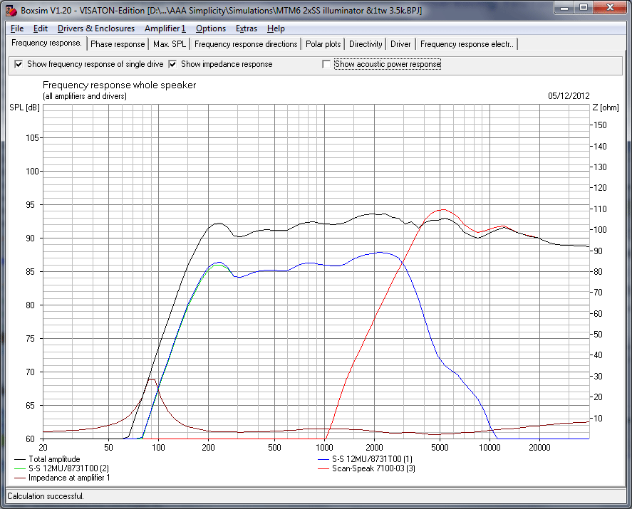

Added Scan-Speak 12MU/8731T00, a lovely 4" with very extended bandiwth.
I would loose 2dB (more respect to the PHL), but the actual simulation of my favourite tweeter results in about 93dB from 5k up, therefore it doesnt look too bad at all.
Attached the simulation with two 4" in parallel and 150hz active highpass.
Note that the valley around 3-4k is intentional and will stay 2-3db depressed in the final speakers.
