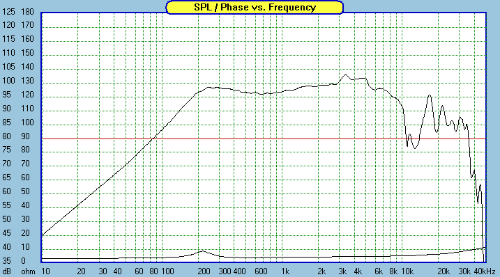

No I haven't decided, but the 4" illuminator looks the best in my sim. Why the 3k dip? Because I'm sensitive to forward ness/shouting. If I have to notch to have a flat response vs having a little dip without EQ I prefer the latter. Note that our ears are sensitive to peaks while compensate naturally for dips (if not too wide).
Is the alpha 6A still in production? I checked all eminence catalogue last week, but I'll do it again. Please note that 200hz with an active high pass under it is my target low end band. I have found at least 2 drivers capable to go this low, so I will not settle for drivers that are not.
The Audax looks pretty weak in the low-bass, but I'll sim it anyway.

This unfortunately puts the AD TD6 in the same pricerange of the 4" Illuminators for me, the FR is also similar, so the choice is in the crossing (a 4" beams higher ofc) vs my preference for larger cone area to reproduce a lively midbass.

As you see, the best unit is the discontinued one, the 170Z0 - more extended FR, damped breakup and better off-axis at 2-4khz.
I dont think it can match the response of the TD6H, but I'm gonna check and compare with it. For a higher XO point, if you can get the Z0 version it has a very good reputation (but also PHL has, or Volt going to low sensitivity). Ok, I simulated it, very efficient, like the PHL needs some equalization in the low-end. IMO it can be crossed at 200hz, but I haven't seen the distortion profile. The PHL was ok from 250.
I had to discard the TD6H due to the huge dip around 800hz, which comes in the middle of the usable range.
Also I decided not to go with 4", of which I would need 4 units per speaker to get similar cone area, and that would be too expensive and change quite a bit of the layout.
After more simulations and thinking, these two comes always on top: the PHL 1130 and the Supravox 165GMF - I'll get a pair of each and test in mono, and resell the one I like the less.
