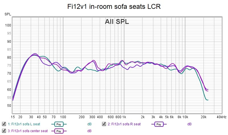

I am joking of course, maybe. Recently I have been exploring what my PTT6.5s can accomplish using bi-amping and DSP based crossovers. After two years and several different enclosures I thought I had heard what the PTT6.5 was capable of (overachieving) in the bass as I wrote here:
PTT6.5W04 and the evil twins PTT6.5PR want to explode your speaker box https://www.diyaudio.com/forums/mul...ifi-woofer-speaker-builds-48.html#post6383932
With the high level inductors and other filter parts out of the amp to speaker signal path replaced by amp direct connect to PTT6.5 in a bi-amp rig with upstream DSP EQ applied for baffle step correction and to extend deep bass expectations have been completely reset. Here is a plot at the listening position with just one of the stereo pair active.
This has been great fun to listen to although I suspected I have a bit much bass dialed in. Chasing that while setup for near field measurements I took the above readings at the sofa where one sits for serious stereo in my room. The sweeps are with the microphone at ear level left then center then right seating locations. We find the lovely flat nearfield responses now include a -5 dB drop at 150 Hz then a 6 to 7 dB boost at 35 Hz, yes the bass has been banging! I am rather proud that if we call the overall mean of these curves 75 dB the -3 dB bass point is 22 Hz. No wonder the very low frequency content of music and video has become so apparent since this DSP’ed iteration of my rig has been placed in service. Yes, next time I have the programmer out I will take a few dB out of the 30-70 Hz range but too much bass when it is so deep, clean and clear is BIG FUN.
Experiences like I am presently enjoying is why when Lars joins us to announce the PTT8.0 is nearly ready and the responses are “how about a 10” then “I want a 12” I just shake my head. On Purifi woofers the Sd and Xmax are just part of the story. When I read ‘Purifi 8’ I make the comparisons to anybody else’s 10, or 12, or 15. The Purifi voodoo in the magnet system and soft parts of the suspension and surround makes all the difference. And then as I am asking 'who needs more than an 8” Purifi' the joke is on me as Lars starts speculating about a servo controlled 10”. This journey is big fun, I am so glad to be a Purifi early adopter enjoying such great HiFi the last two years.
