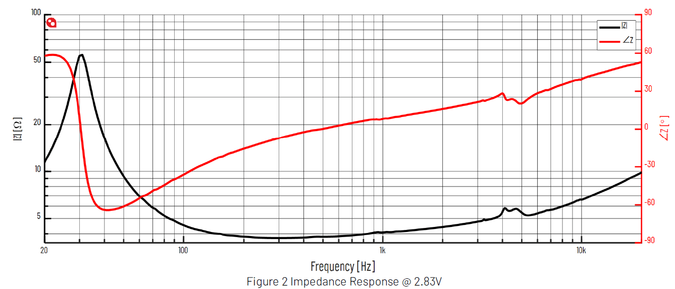

This and Re, Mmd and Sd -> LEAP .tsl model . . .here you are. inductance is lower thanks to a 2 layer coil View attachment 1021877

Hello Lars.here you are. inductance is lower thanks to a 2 layer coil View attachment 1021877
How far would I be if I´d guess something like Re=3,1Ω, Mmd=50g and BL=9,4Tm?
My figures comes from the graphs and drawings...
Mms around 40g and fs at 28Hz - then you can figure everything out 😀Hello Lars.
Ok, thank´s.Re more like 3.5R
With 3,5Ω and 37,9g I´d guess BL=8,14N/A - assuming Sd=237cm² is close enough. If so, the rest is clear 😉

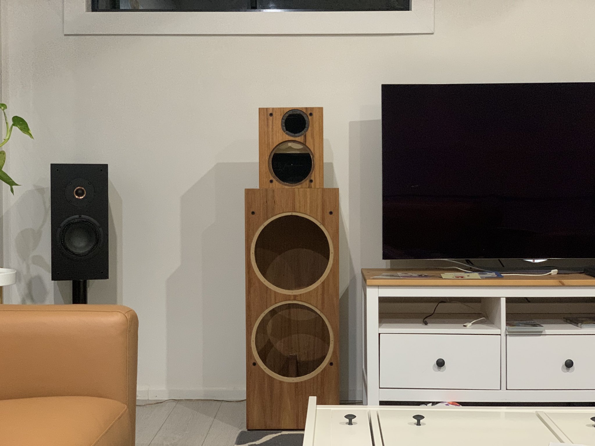

Friends I have a pair Purifi PTT4.0W04 woofer can we make FAST speaker or it doesn't make sense. Application is speaker in my office so will be on my desk its a small room. I love basss dont like too much highs. I listen to mainly electronic EDM music. In Fullrange I have Visaton B 80 3.3" Full-Range Driver 8 Ohm and Peerless by Tymphany TC9FD18-08 3-1/2" Full Range. Please suggest what should be the idea way to go. Amp I have Hypex Ncore 250 watts per Chanel and also Chinese TPA 3255 2 channel 2 boards and Minidsp 2x4
You can certainly build something with those components, but I'm not sure the PTT4.0 will provide you with the bass you desire (below, say 40 Hz). It might be best to add a subwoofer. As to the choice between the B 80 and the TC9, both are good drivers. I'd try them and see which I like better. If a subwoofer is out of the question, you might consider using this passive radiator:
