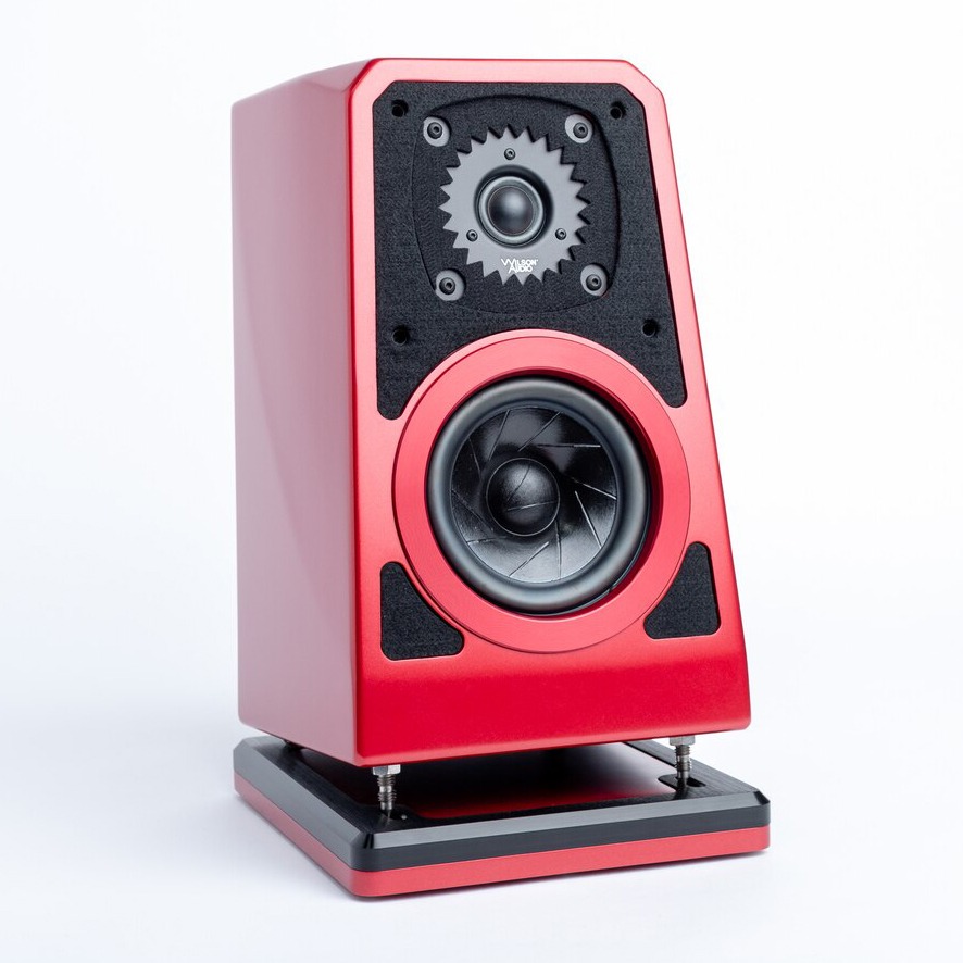

At the risk of encouraging this thread farther afield, am I understanding correctly, that DSP can be used to control directivity? How does that work? Is it just via phase adjustment? How much impact can it have? Specifcally, can it help match a 6.5" driver to a 25 mm tweeter? I'm currently planning to use a midrange between my PTT6.5 and my T25B, pretty much solely to help with the directivity mismatch between the two. I am not interested in trying a waveguide on the T25B due to fear of damaging the Be dome either during assembly or in use.
DSP isn’t used to control directivity. That’s done by the baffle shape, waveguides, absorbent treatments etc.

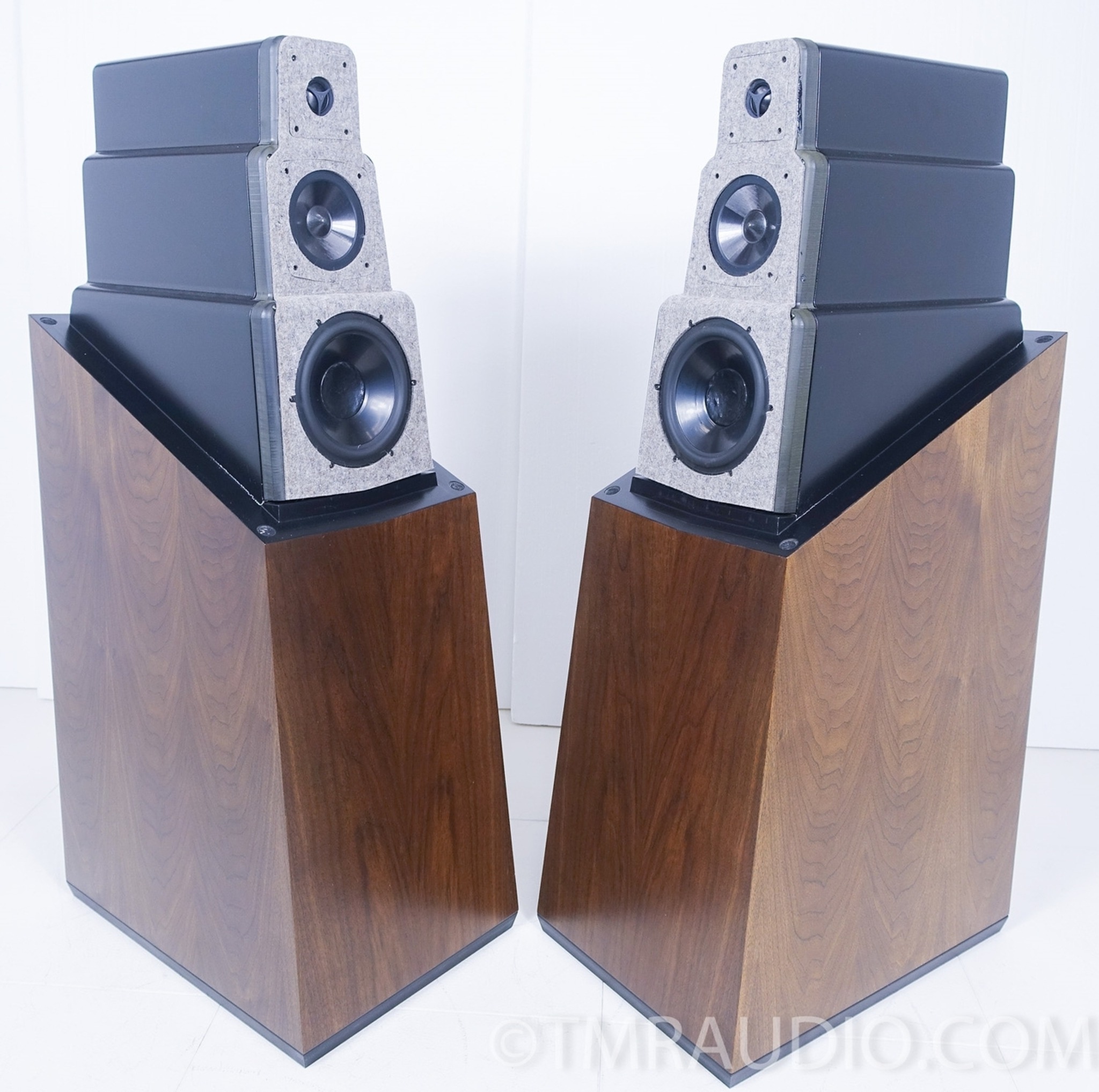

An alternative to a waveguide is baffle treatment such as what’s used on this speaker.
Thanks for clarifying and mentioning this approach. I'm planning to use this window (while I wait for availability of the Purify small midrange, measurements for the Bliesmas, etc.) to investigate meta-material absorption of in-cabinet backwaves. Maybe I should add baffle treatments to the research.
No problem. Also if you’re making a passive speaker consider stepping back the mid and tweeter for time alignment. Makes a massive difference. And without DSP you must do it in a similar way to Vandersteen. This speaker uses both baffle treatment, and physical time alignment. This approach helps with lobing, directivity, and time alignment.

Any crossover will have an effect on the directivity in the crossover region and the shallower the slopes the wider range it can have an influence. It is limited to making the best out of what already exists in your example. If arrays of drivers are used then positioning and DSP together can have significant control over directivity.At the risk of encouraging this thread farther afield, am I understanding correctly, that DSP can be used to control directivity? How does that work? Is it just via phase adjustment? How much impact can it have?
No DSP can "match" directivity electrically that was mismatched acoustically.Specifcally, can it help match a 6.5" driver to a 25 mm tweeter?
Be careful what felt is used as much of what is available that looks similar to the Wilson is actually very reflective and would just introduce reflections rather than absorbing the off axis. Also possible that the star shape with reflective felt makes a diffractive spread on purpose or by accident.An alternative to a waveguide is baffle treatment such as what’s used on this speaker.
