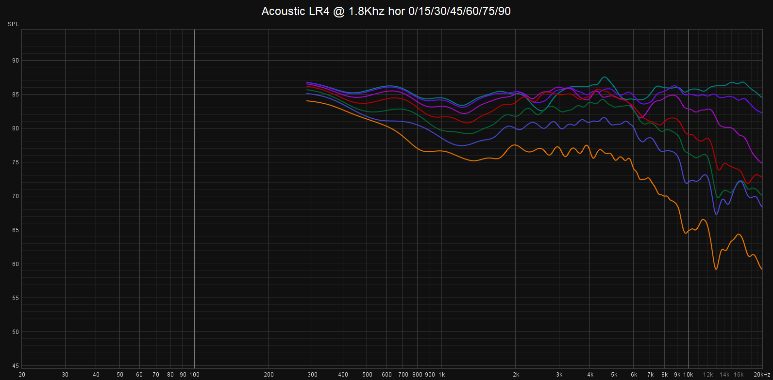

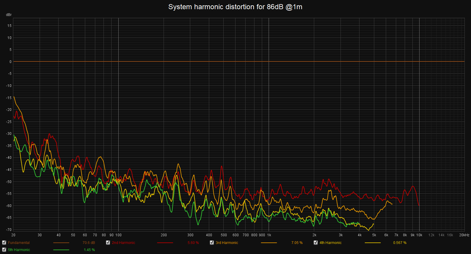

Hi James,
No the opposite,
Non-linear distortion, which includes harmonic and intermodulation distortion, is dependent upon volume displacement below the excursion limited frequency.
So a larger driver will have higher SPL and lower distortion below the excursion limited frequency.
The advantage of the smaller driver is the dispersion.
For instance, relative to on-axis, at 60 degrees off axis, the 4" PTT is ~4dB down at 3Khz, whereas the 6.5 PTT is already 10dB down.
So in designs where I want to focus on good and smooth dispersion/power response/directivity, in a 2 way with a larger mid-woofer I need cross as low as my tweeter will allow. In the case of the PTT6.5, I used LR4 1.8KHz. See attached gated (unsmoothed) measurements of my 2-way with the SEAS Millennium T25-CF002 tweeter.
This is as good as it gets with a standard flat faced tweeter. It's all a matter of geometry.
For an even smoother transition in the 700-2Khz range, one would need use a smaller mid-woofer drive unit.
Or add a midrange driver (3-way)
Or use a waveguided tweeter...

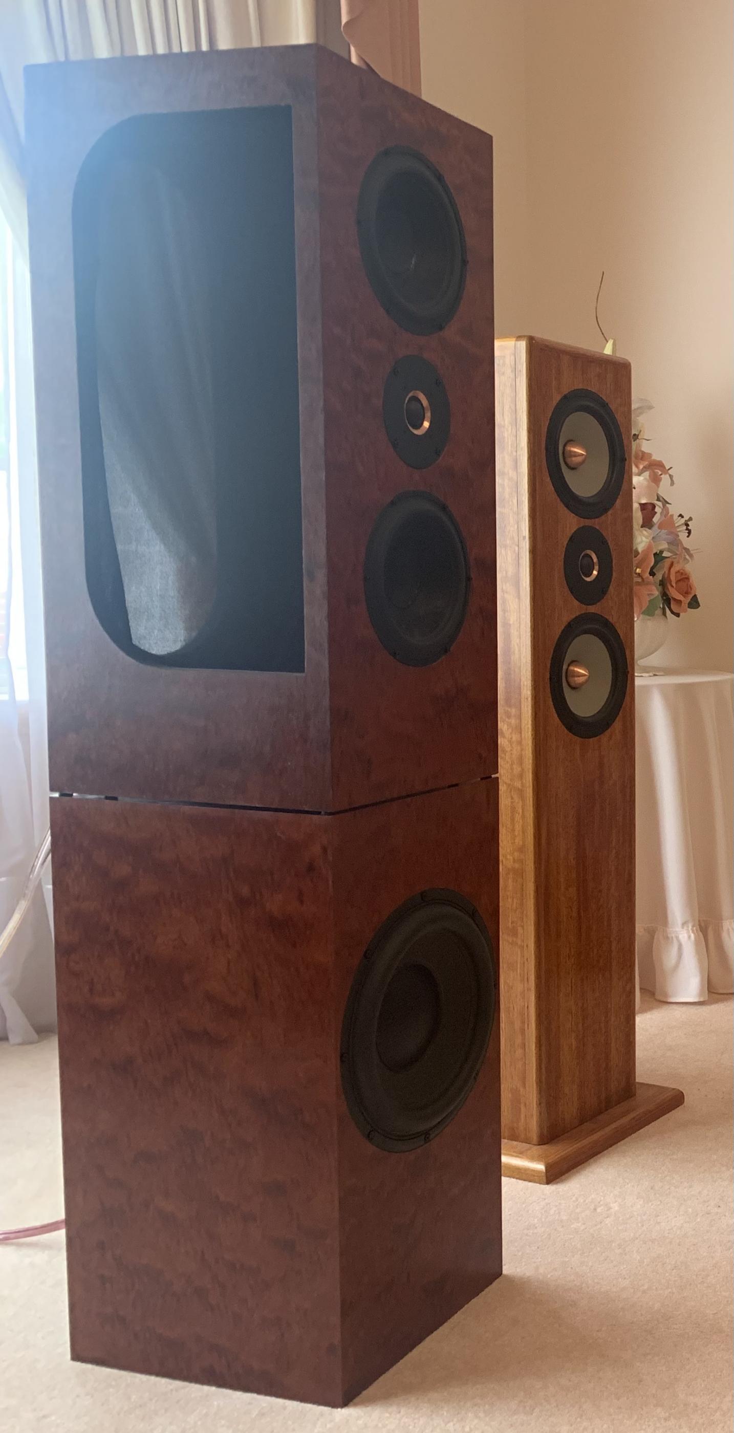

Purifi business case support: customers would almost certainly want two drivers per side .. AND an 8 inch for for the upper bass-lower mids
Imo, would be the marriage of SOTA drivers and SOTA speaker design. I've never read a review which wasn't super impressed eg

Reading that I though "mandatory is rather absolute for a field as wide open as HiFi speakers, Joseph D'Appolito offered a nice solution in 1983".
AES E-Library >> A Geometric Approach to Eliminating Lobing Error in Multiway Loudspeakers
Back to our specific topic. It occurs a D'Appolito array using Purifi PTT6.5s is a path we have I believe yet to explore. Certainly in 2021 D'Appolito architecture is not as popular as its heyday in the 80s & 90s but dang a 30ish liter box with a pair of PTT6.5s flanking a high output tweeter would certainly be interesting. And by 'interesting' I mean enough output to rock the house and stun small birds at 20 meters.
While I agree and interested, I only have a pair of 4 ohm ptt6.5.Reading that I though "mandatory is rather absolute for a field as wide open as HiFi speakers, Joseph D'Appolito offered a nice solution in 1983".
