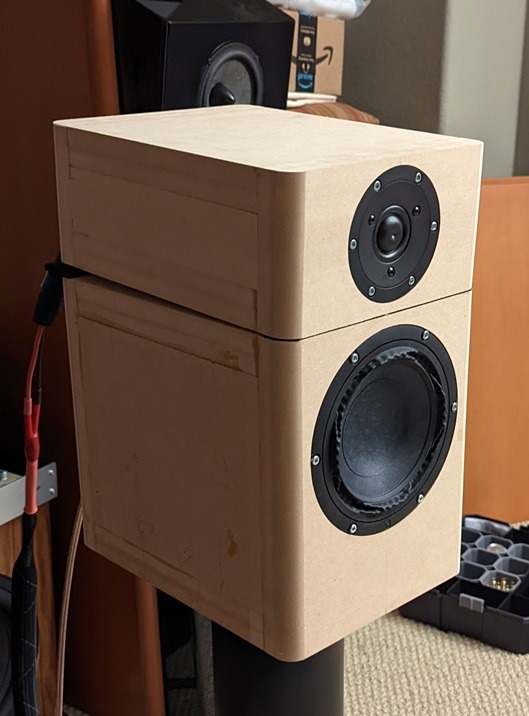

Hello, I am just starting off on a Purifi stereo build with a three-way active set-up. Kinda like a Pure Acourate Sound "Junior" (Pure Acourate Sound). My “little” system would have just single 10-inch subs sealed in 55L boxes underneath. And then 6.5-inch mids sealed with a tweeter in 10-15L boxes above.
Then I happened across your 2022-01-11 post #1233 and picture about using a Purifi 6.5-inch in a sealed box for surround sound.
It so happens that my stereo system is embedded within a 9.2.6 set-up. I run a mish-mash of surround speakers at present. The notion of building a ring of Purifi 6.5’s really appeals.
Are there design plans available for the units in the picture, mid and tweeter? Did you use any particular lining or stuffing for the mids? Thanks for any advice or pointers!

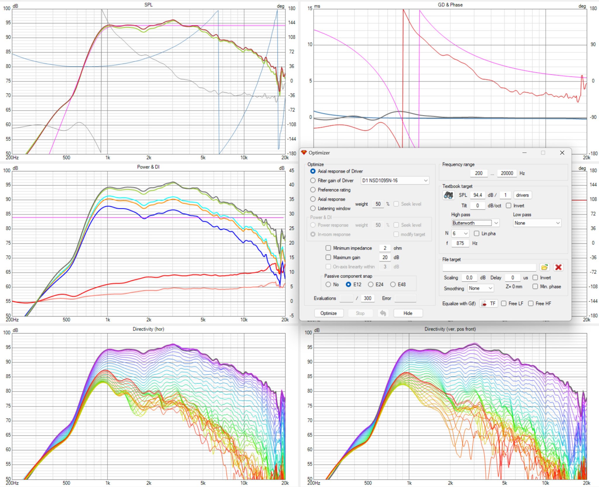

Have you considered taking the IB trace(s) and simulating it in a cabinet of your preferred dimensions?@tktran303,
I've already the 30 & 60° curves that Purifi kindly provided to us mais I don't think it's enough to decide it is worth it to buy a pair at that price for testing... By the way my target Fc is 1250 Hz probably LR8 linear phase
Honestly I have not done this, so I’m not sure how close/far off it would be.
Yes I agree the simulation is not the same as real data. Hence "real" data and simulation.
But based on my simulation, at 1250Hz, at 45 degrees off axis it is -6dB compared to on-axis, for flat piston of 25cm on 35cm wide baffle.
Are you sure you need to use LR8? What HF unit are you using?
In my experience, with sharp filters like LR8 and beyond, although it can make on-axis look very nice, can cause big directivity mismatch in the off axis angles.
My HF unit will be a NSD1095N on a 25 cm rectangular X-Shape horn. Natural acoustical cut off looks like a 6th butterworth order at 875 Hz, measurements were made free air (no baffle) at 1 m from the mouth.
I guess thatat least LR8 is a necessity
For the waveguide it looks like acoustic LR4 at 1250Hz is possible.I guess thatat least LR8 is a necessity
You are right LR4 is possible but as I plan to test FIR I thought that additional electrical slope would be beneficial for the HF driver
You wrote necessity which made it sound like you didn’t think it was possible 😀
It might be the woofer that would benefit from the steeper slope, the waveguide still seems to be going strong.

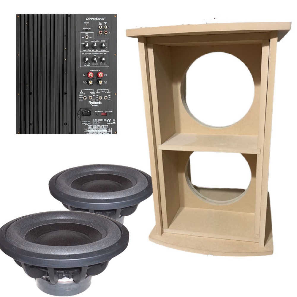

@lrisbo What about completely open in the back? Something like this Danny Ritchie Open baffle Servo Sub but with two PTT10 drivers? Seems like an easy enough project...? How would they perform in a dipole setup like this?The more box volume the less hard the drivers have to work (ideally backside venting to the outside atmosphere).
