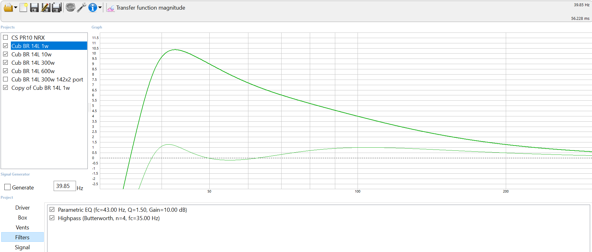

Anyway lets place the ZR6.4D into a WinISD 14L BR tuned to 42Hz and see what happens at 1w, 10w and 300w
And then repeat that with some parametric eq with a bit wider Q set to 1.5 and 10db boost at 1w and 10w and see if the z623 numbers can be met at all

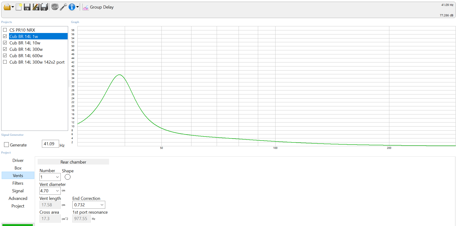

Ready to start some serious sims for the ZR6.4D based desktop subwoofer/bottoms pair. Target is meeting or exceeding 85dB at 1.8m over 40-300hz band flat as well as with a loudness compensation curve. 40L is the max driver volume available. If the sims look promising, then the test boxes will be built from 16mm MDF and with 47mm port diameters. If the design plays ok, then will do a proper build using passive radiators from the DIY project. No urgency on this one but with so much work already gone in, I'll give it a few more days of sims and then start work on the 12". Will use offcuts from that to make the test box for the 6.5" at the same time
The previous post has a major typo. The max volume allowed for the driver is 14L

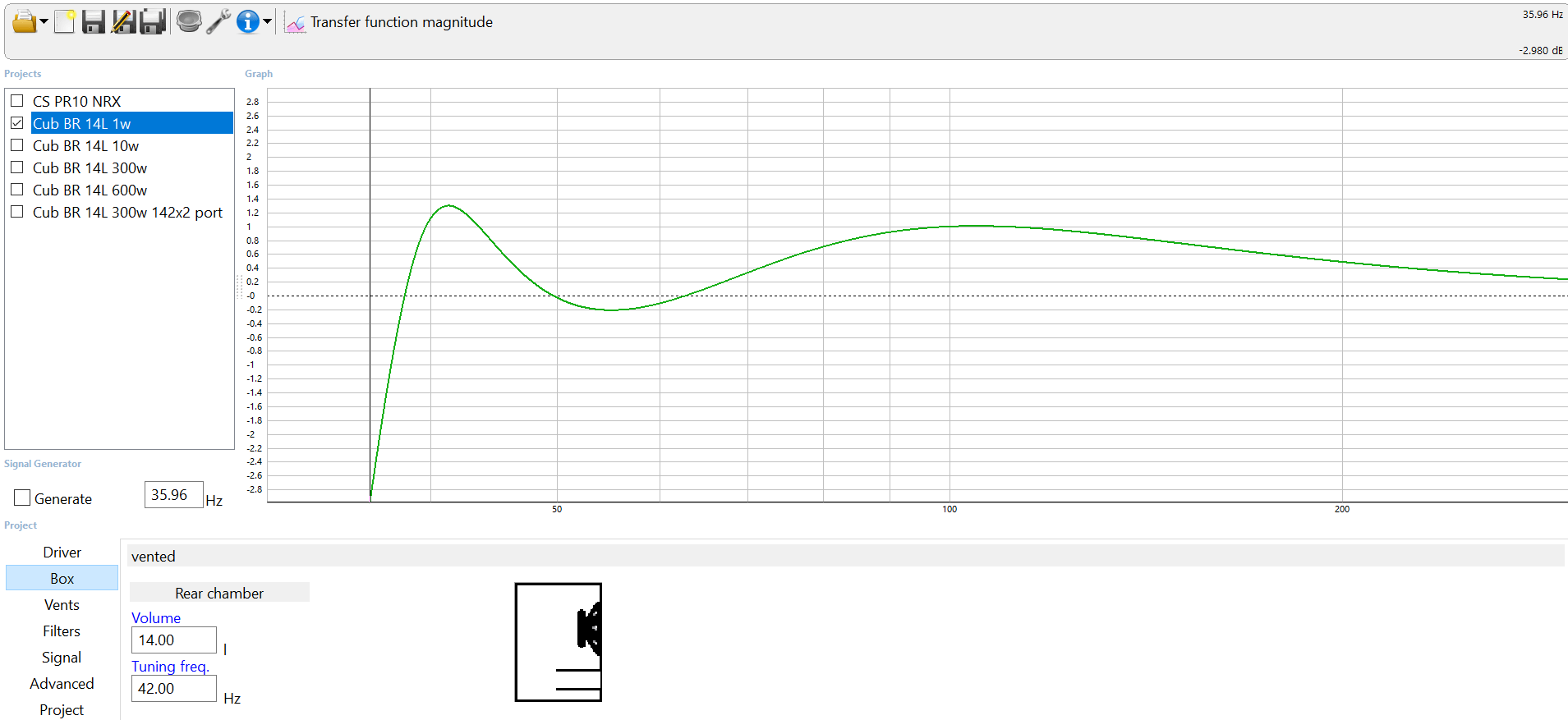

Sims for flattest well under 40Hz
Frequency response
Adjusted the display window to show expanded view of the curve within the targets of +/- 3dB for response and use band from 30-300Hz. Looks so wavy

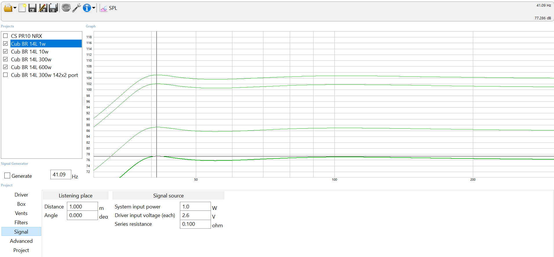

SPL
The lowest trace is 1w and the highest is 600w. The pane on the left shows running and active projects

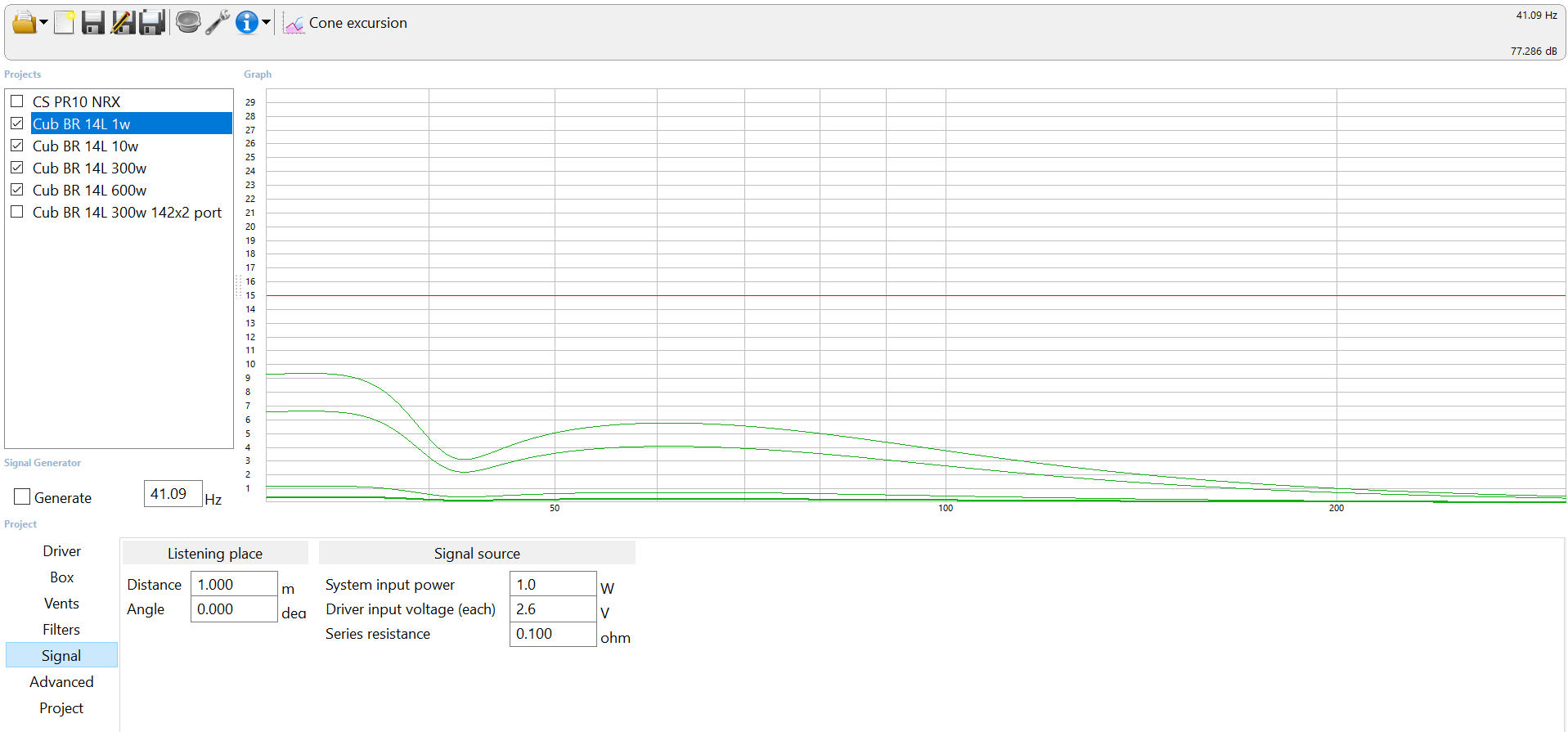

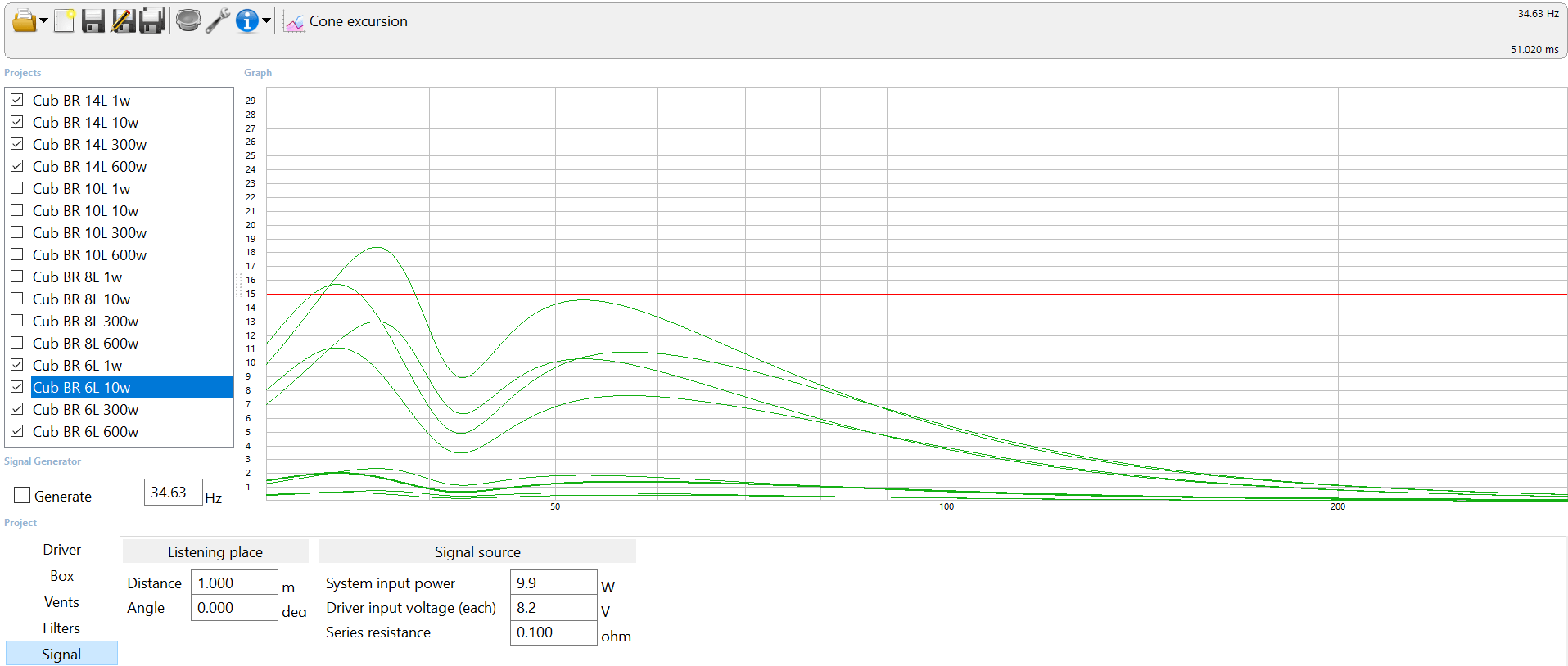

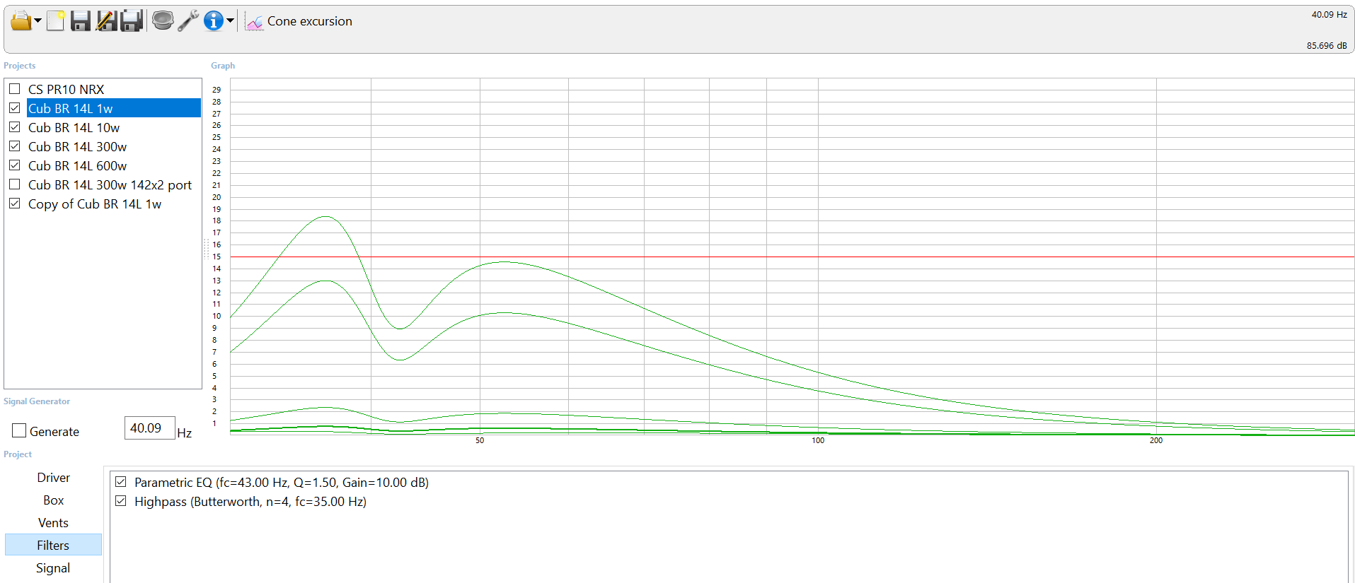

Cone excursion

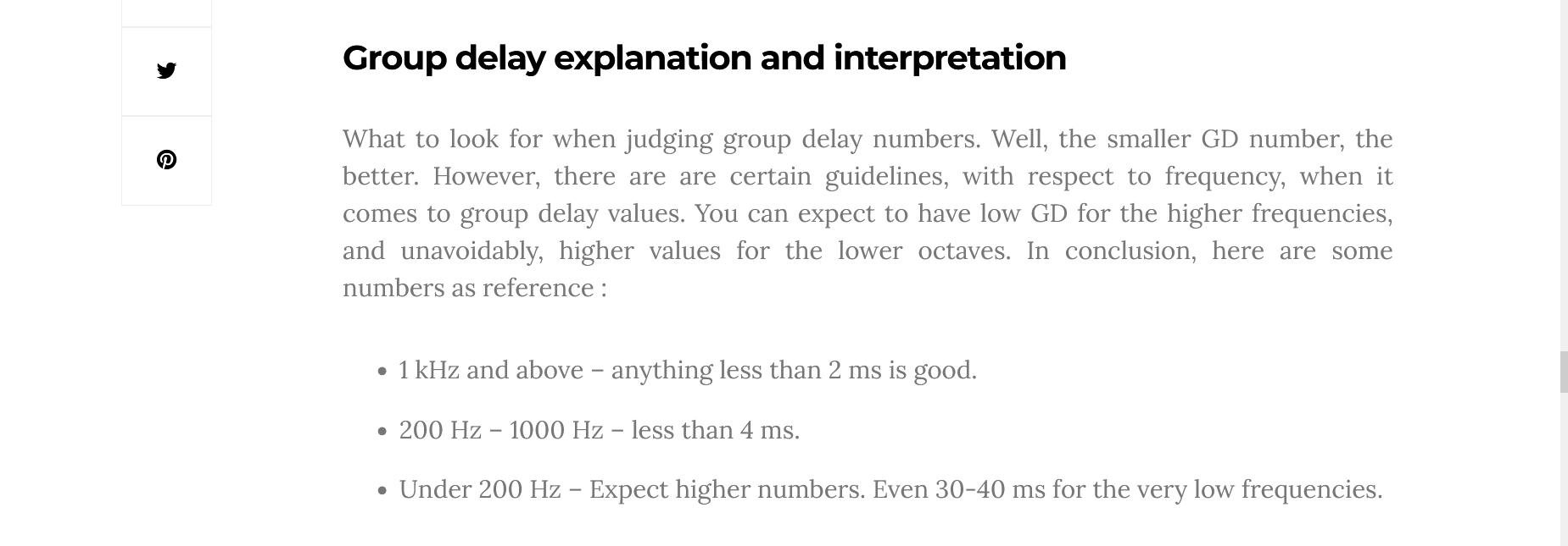

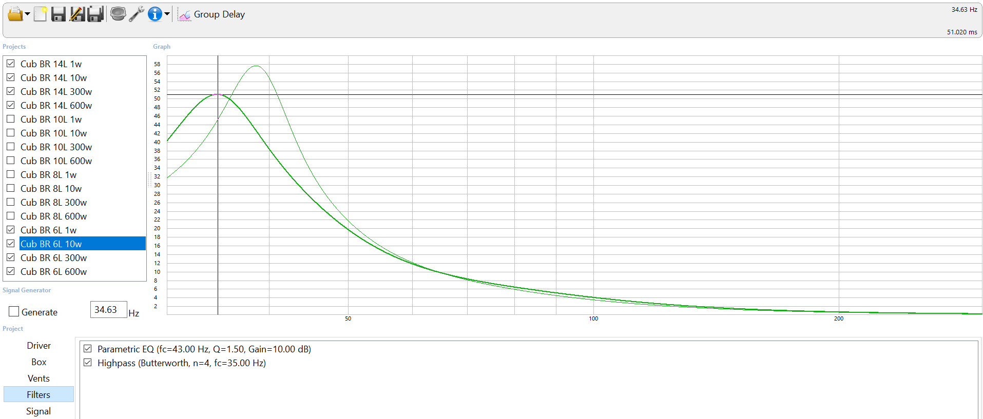

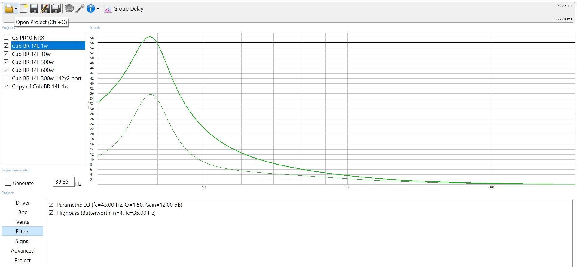

Group delay

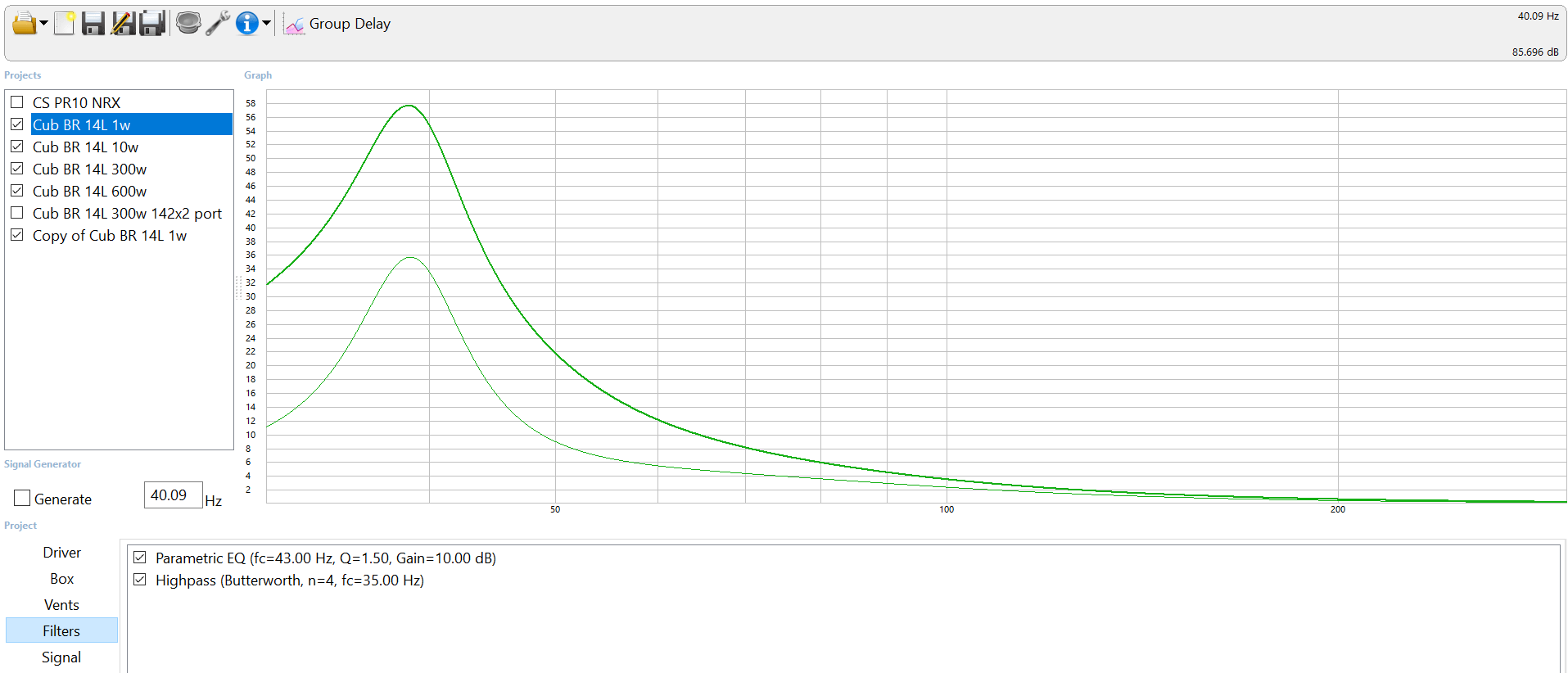

Learning to use the tool. Looks like group delay is just getting into the lower end of the unavoidable
https://audiojudgement.com/group-delay-explanation-measurement-audio/

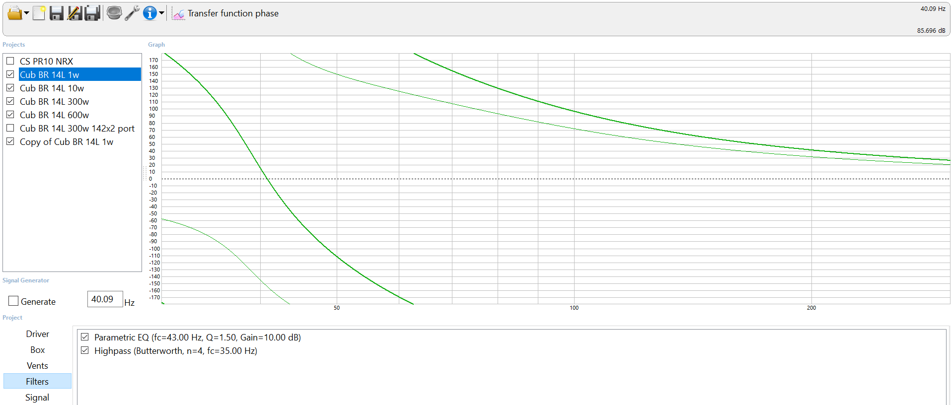

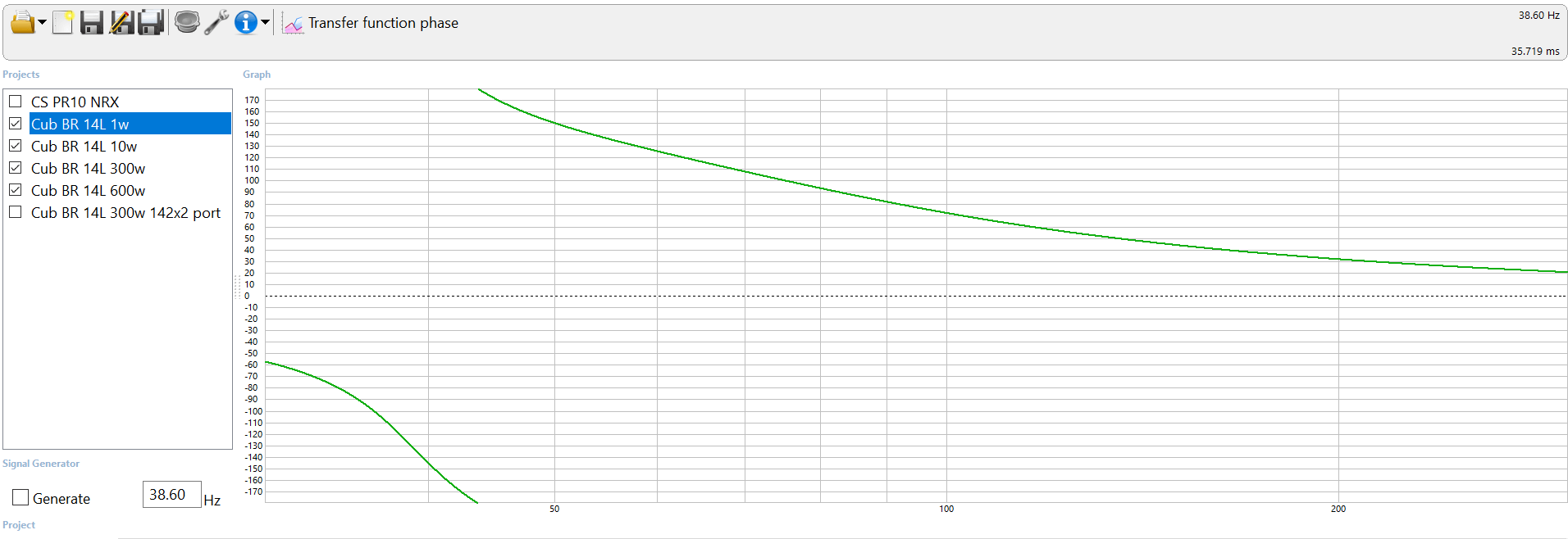

Transfer function phase
Have tried to read up on how to interpret this graph, I can read how the phase changes over the band but I dont know how to tell if this is a good or bad result

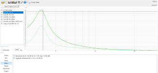

Impedance

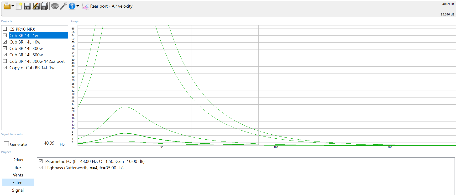

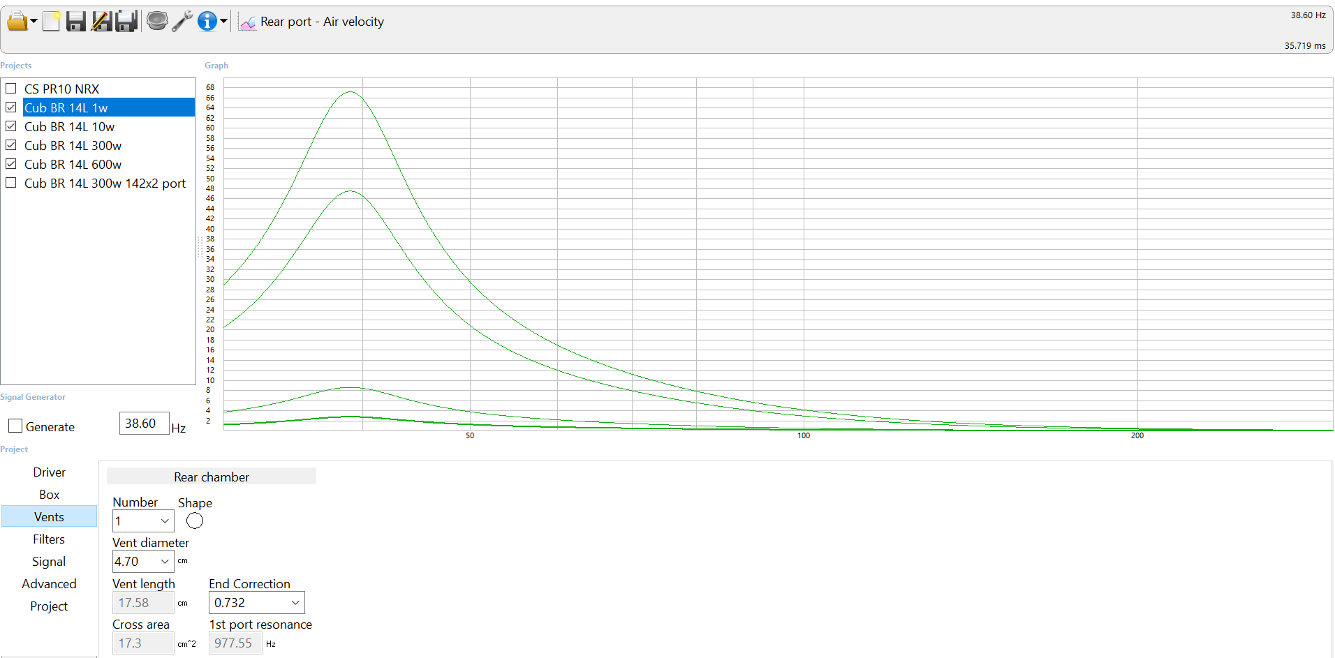

Port air speed
At higher powers, it resembles a cat5 cyclone blast!
I need assistance if figuring out if I am looking at exceeding 10w at the listening position. Note, there will be two cabs in stereo and the sims are for a single cab. Also, assistance with how much output I can expect before audible artefacts become a problem. Note, eventually the port will be replaced by a dual opposed passive radiator system

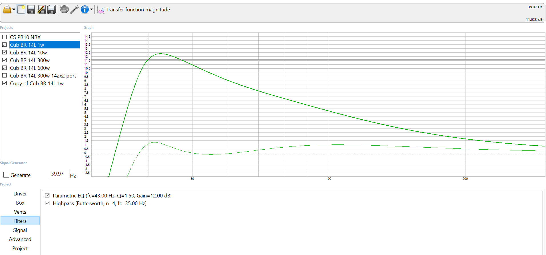

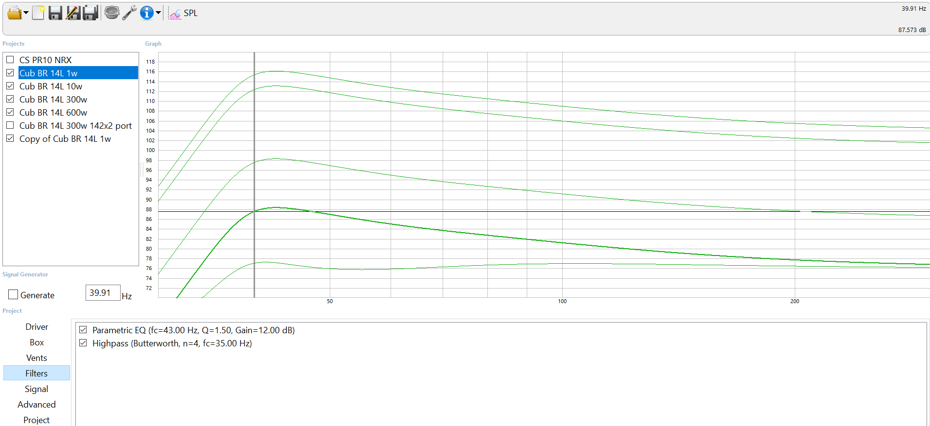

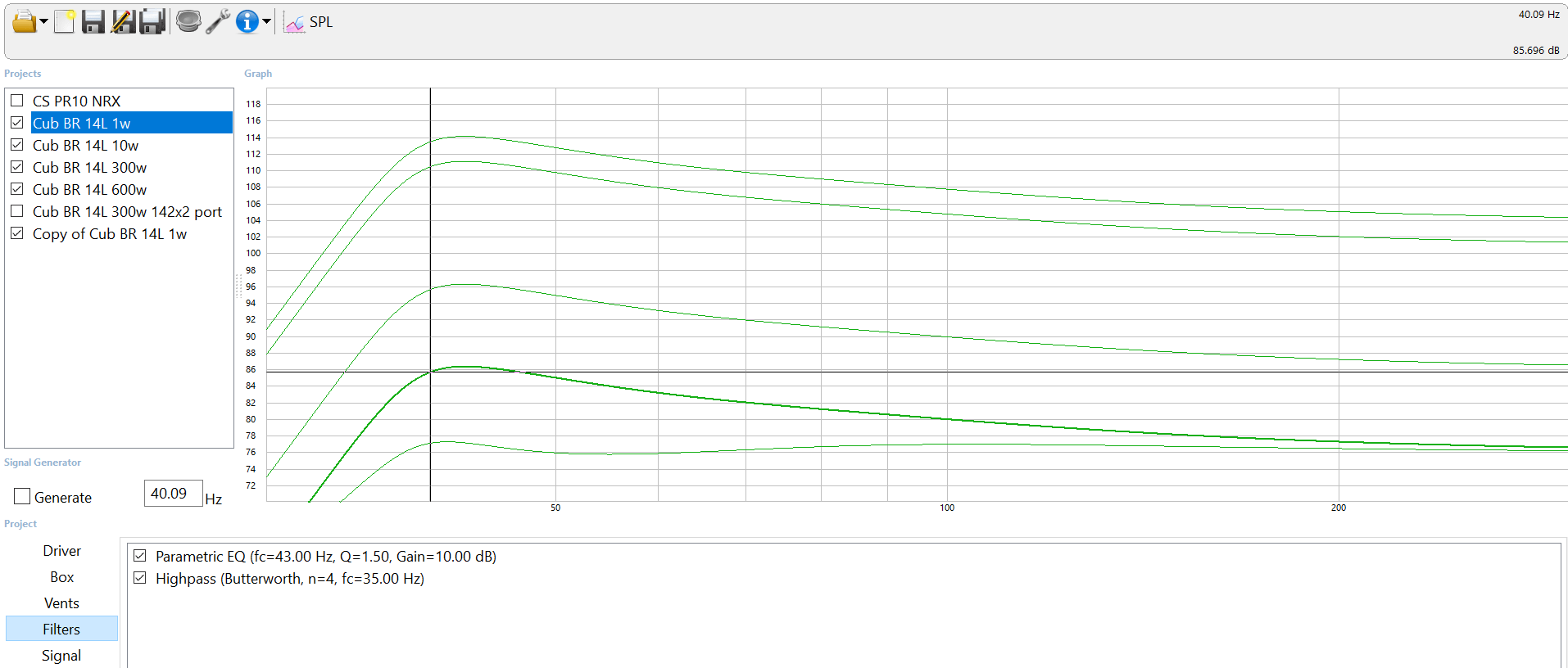

Frequency response with filters on
The pane on the left shows running and active projects. The lower trace is a copy of the 1w with filters off to show original trace
SPL with filters on
Group delay with filters on

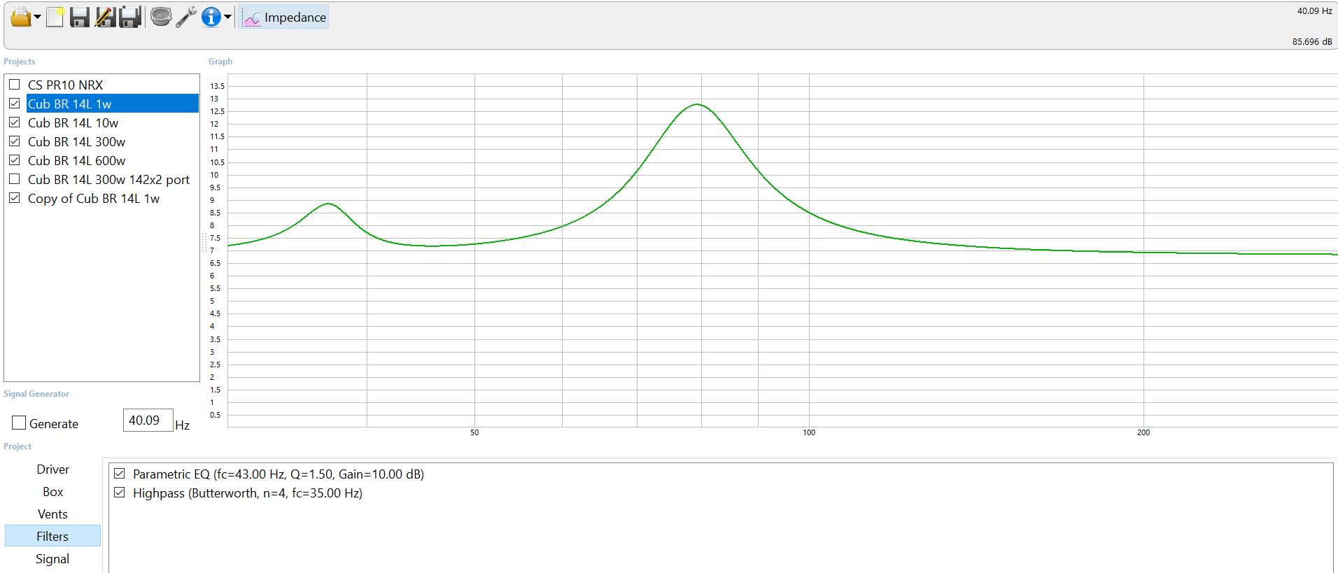

Impedance with filters on
Transfer function phase with filters on
Cone excursion with filters on
Port air speed with filters on
This is now a storm on Jupiter class gust in the upper powers. I need assistance to determine in port noises are likely to be an issue when matching the indoors 86dB levels over the subwoofers use band
Now this is the port air speed trace with dual 142mm dia ports. Length is 3.73m. I will try to use the material that Art provided to work out the moving mass needed for a pair of PRs. I found an article on SBA website re PRs that may help workout the compliance for the suspension
Would really appreciate some feedback from the forum if the sims look worth further pursuing as stereo desktop subs for near field? The tops would be a pair of 3" FR drivers in their own volumes. I'll prolly end up using a pair taken out from the z623 or Tang Bands if I can manage the shipping on them

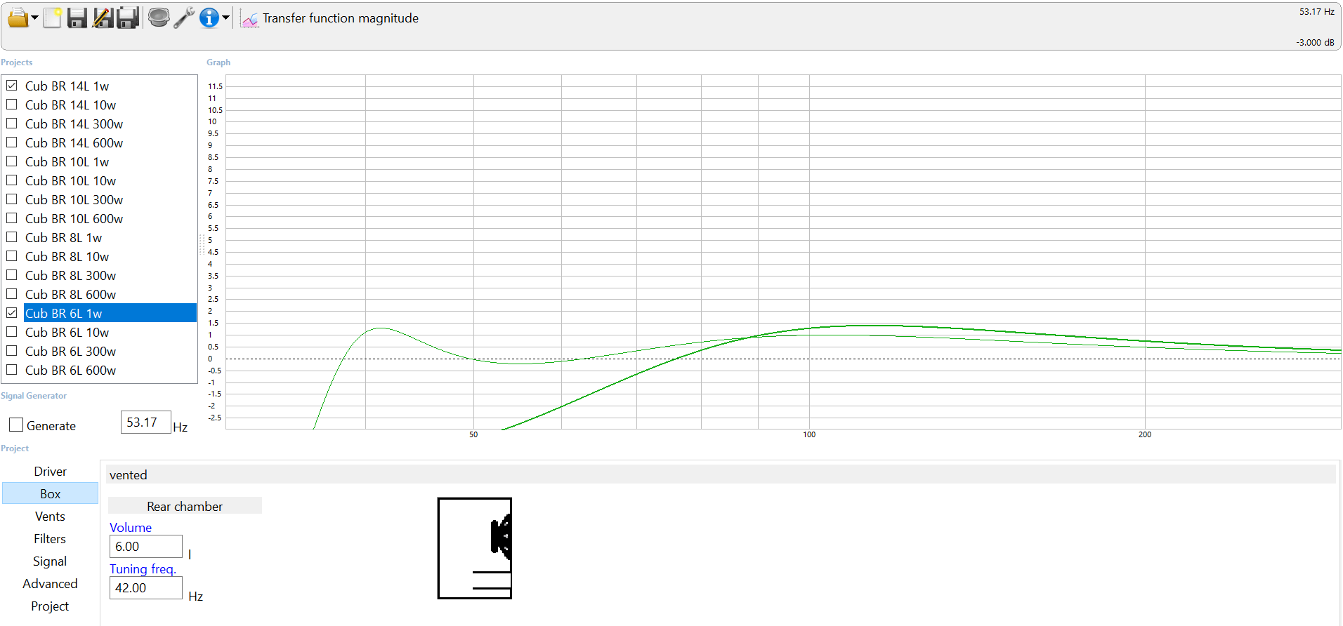

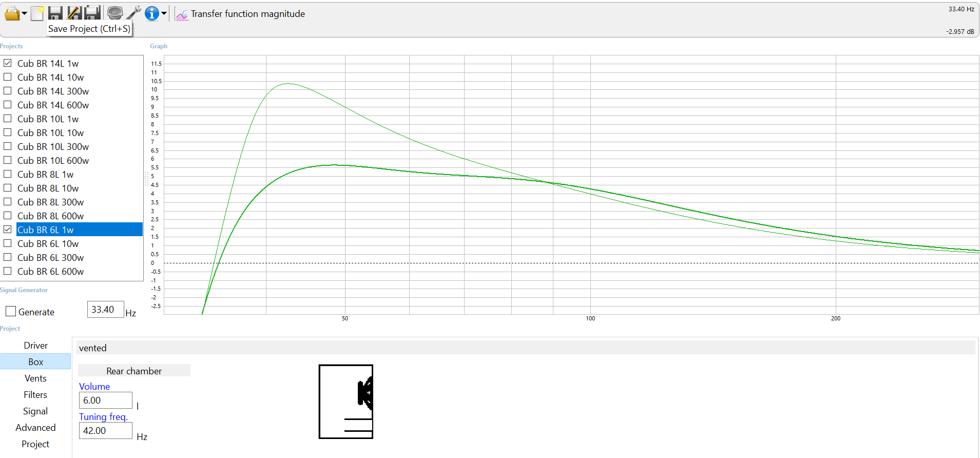

Continuing on from the previous post. That was the driver in the largest allowed volume for my purpose. Largest allowed doesn't mean it an optimum in all areas. A presence of this sized pair still intrudes into the small room, but is the most that I would want to live with if that's what it took to match the z623
Same sims of the same tuning and filters in a 6L driver volume. Running projects can be seen in the left pane in the graph pics. Active are the 14L and 6L sims. The lower traces in each pair are the 6L volumes. The inactive 10L and 8L sims stepped in neatly but makes the screen too busy if all are activated
14L vs 6L sims
Frequency response with filters off
At 6L, a -3dB prediction for 53hz, compares well if seen in context as bass response on a bookshelf when compared to the 60-90hz F3 for desktop 2-ways that I normally see out of comparably sized boxes
A -3dB @ 33Hz out of a 6L driver volume. Who can beat this and the group delay and SPL numbers coming up?

Group delay
Excursion with filters on
This is how I interpret these results, might not be correct due to inexperience, To me, the 6L cab slightly falls short of the SPL numbers when compared to the 14L cab. Otherwise, it betters the group delay numbers. It also shows much more lower end performance than what can usually be found in a tiny around 6L

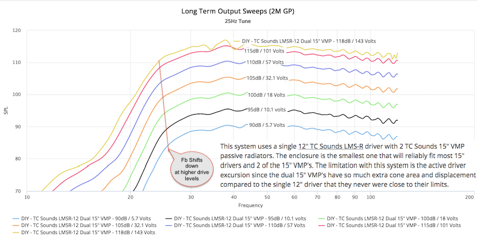

Also, this method ignores the PR's suspension. How does that affect the tune at varying drive levels?

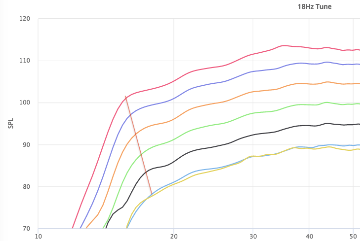

From what I can gather from Josh Ricci's measurements, the Fb using PRs appears to lower in frequency at higher drive levels.
https://data-bass.com/#/systems/5c2e78ff80141f000411fc28?_k=xfp69d
The above tuning dropped about 1Hz, not much from 25Hz.
Lower tunings require more mass to be added to the PR, and seems to increase the relative drop in Fb, from ~18Hz to ~15.7Hz:
