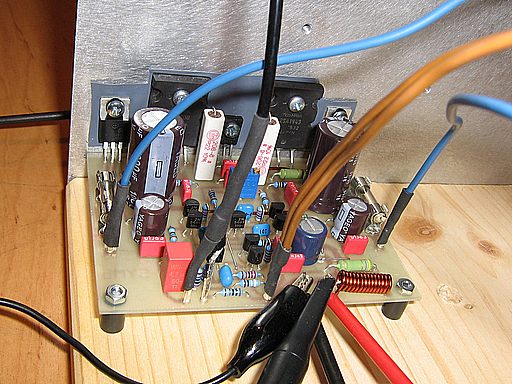

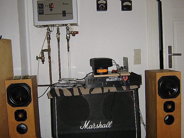

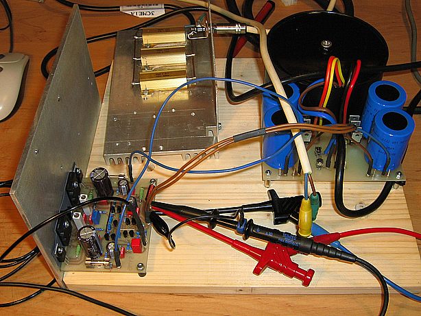

Hello all,
I just like you to know, that another pair of amps is coming to life soon.
The first side plays fine - as far I can rate this - my speakers may not be good enough to hear a difference.

Mike, thanks for sharing!
Here are some pics

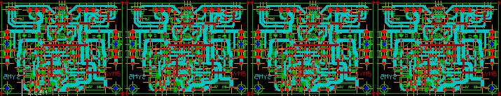

Multiple Symasym
I was just wondering if any of you guys (building the Symasym 5), has try to do a 6.1 or 7.1 to follow the creative DDTS-100 ?
http://www.ausmedia.com.au/Creative DDTS-100.htm
As 8 Symasym 5 are required, I thought the safest way to achieve it would be to 'panelize' tttking gerber files (see enclosed jpeg file) and place 4 on each side of the cabinet with maxi heatsink and forced air cooling.
Any suggestion welcome. 🙂

Hey, you live nearly around the corner to me !
Have you manually etched your pcbs ? Are your speakers also DIY ?
The boards were etched at home. I think the "homebrew quality" is fully sufficient for this application. The speakers are from a kit which I bought 15+ years ago from store at your hometown ("Speakers Corner")
Maybe you remember this store 🙂
I'm looking forward to complete the second amp now.
Regards
Tobi
