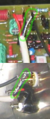

Hi Terry !
Wow, nice casework !
One thing, it looks a bit like you have reversed polarity on the right speaker output ?
And, you used shielded wire for the speakercables, but you maybe shouldn't connect that shield to signal-gnd, on photo it looks like you connected it to the left RCA ? It should be enough to connect on amp side to power-gnd.
That's no critic, i just want it to be "perfect"... 🙂

MikeB said:Hi Terry !
Mike
Good eyes Mike. You were right. I had reversed the wires on the right side. Thanks!
Those aren't shielded cables on the speakers though. They are short lengths of the speaker cable I use. It is 16ga stranded. I did use shielded on the inputs though. That is connected correctly I think. I connected the shield to RCA ground and the pin next to the input lead pin, the speaker ground to the ground pin on the PCB and then took the other ground pin on the PCB to star ground. If either the input shield or the speaker ground needs to go to star ground, let me know and I will rewire it.
Blessings, Terry

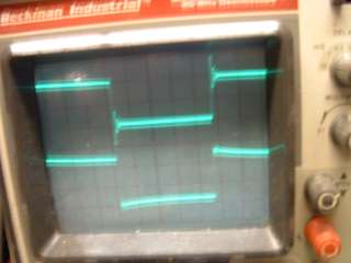

It survived!
It survived Mike!!!!!!!!!!!!!
Aleluia! The Symasym survived the ultimate test of the
electrostatics, I was so afraid to smoke the amplifier that I waited and waited until....the suspense was killing me.
First, as I said before, I ran one channel with 2.2uF´ and 8 ohms just to see on the scope how it would react. (I'm
sending you the pictures) As you can see the top square wave is the one with 2.2uF, the bottom is just the regular
8 ohm load. As you can see there was just that ringing which I found of less importance (I've seen tube amplifiers with bigger ringing), besides that no signs of major (or
minor) disturbance. That gave me the remaining courage to connect the amplifier to the ESL.
Unconditionally stable, no heat, no disaster.
As the amplifier has so much gain, as a precaution I
reduced a tiny bit the HV to the ESL that could cause distortion but then I increased it little by little to the very same point which is almost 5 Kvolts. OK so far!
On the other hand can you imagine the sound that comes out of those speakers?
I'leave that to your imagination!
LONG LIVE THE SYMASYM1

Hello John !
That is really great news, symasym happily driving your ESLs ! (I would be happy with a snow man...
Did you install the safety diodes at output (output to rails) ? Your outputdevices are MJ21193/4 ?
How do your ESLs sound with the symasym ? 🙂 I attached your scopeshot for the others to see.

Thanks for posting the picture, I've always problems in uploading
pictures, no matter what I do the board always tells me that's
a too big of a file to insert.
In any case for everybody to know the upper wave is the channel
loaded with 2.2uF with 8 ohms in parallel it shows a bit of ringing
nothing serious I suppose (tube amplifiers look worst sometimes)
and the bottom picture is the other channel loaded with 8 ohms
only.
