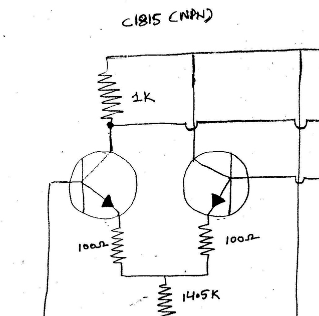

A fast off topic...someone sent me a schematic...this one i constructed and sounded
good...but i made some small modifications because treble.
I have lost your adress, i think you sent this schematic using my hotmail adress.
Well, i have the schematic, but do not have your name.
Thank you by the schematic..showing only a small part of the double differencial simetrical input.

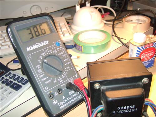

Doggy
Too much voltage for the Symasym, it is supposed to be supplied
with no more than +-35 VDC.
With a trafo of 38 volts, after rectified and smoothed the voltage
will be around 53 V DC which is too much...
The ideal voltage for the trafo would be around 2 x 25 volts.

What you see there is running through a rectifier and cap; that is dc voltage on the meter. So over voltage by 3.6 d.c-it might sag a little as well.
cheers
doggy🙂

Hi doggy !
Wife with blue hair ?
Etching your own boards is less ugly...
I did not think of the 22000uF beeing very big... I thought that the 47000uF might have been overkill, so bought them 2 numbers smaller. 😀 As rectifiers are not expensive, why not using 2 of them, one for each channel and use 4 of the 10000uF or 6800uF ? I bought them here in germany at www.reichelt.de ... (~8$ each)
As the amps have these 1000uf onboard, they do not put very heavy HF load to the supply and caps with not too low ESR in PS shouldn't hurt much. I tried some snubbers but heard no improvement, i only kept a 500ohms + 100nf in series in front of the rectifiers on AC side, according to sims it should completely eliminate diode ringing. Adding the wrong stuff here can turn the diode ringing into oscillation, without scoping the result it might be better to add nothing. But, i am not very experienced with PSUs... 🙁
About your transformer, 38v DC should do no harm, but is upper limit...
Is the transformer ~25v AC ? Jmateus is right, a tranformer with 2x25v AC is the perfect one.
