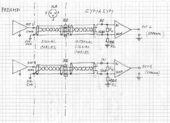

PMA said:IMHO it is more about proper cabling, later I would show the signal wiring in the amp (shielded twisted pairs, 10R CMV resistor to prevent loops).
That would be very interesting! Maybe a picture of the inside of your amp...?
I will show it, but give me several days, please, I am quite busy right now.

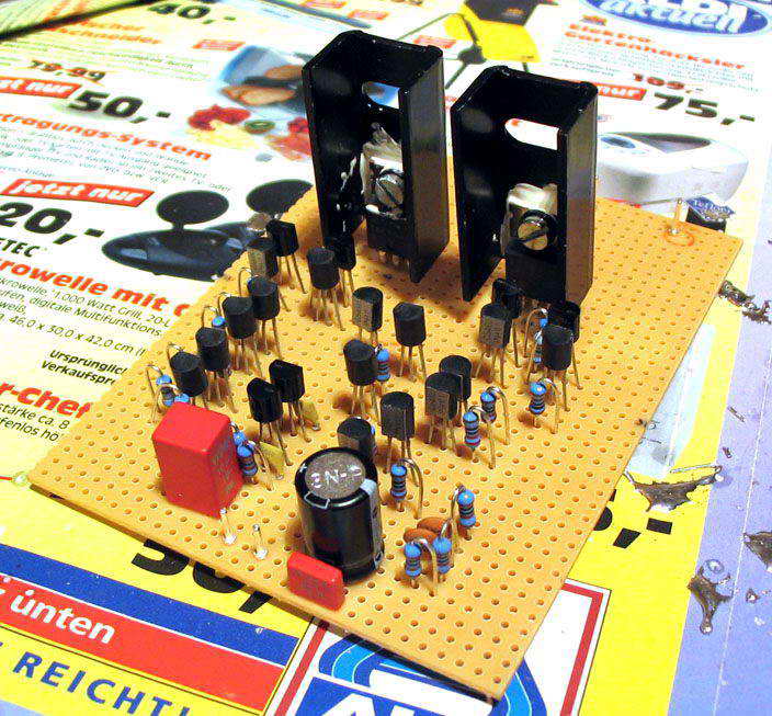

So my output trannies arrived from the US of A today. What I have at both channels now is when I put 22V on V+ i get 17 on V-. I have an adjustable mains transformer and use a test PSU of a bridge and two 10.000µ caps with a 8.2k resistor in parallel with each one. Without load, the voltages are fine. Any ideas?
Lukas
Lukas

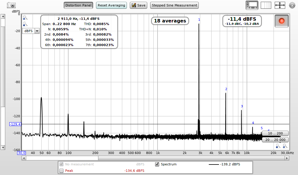

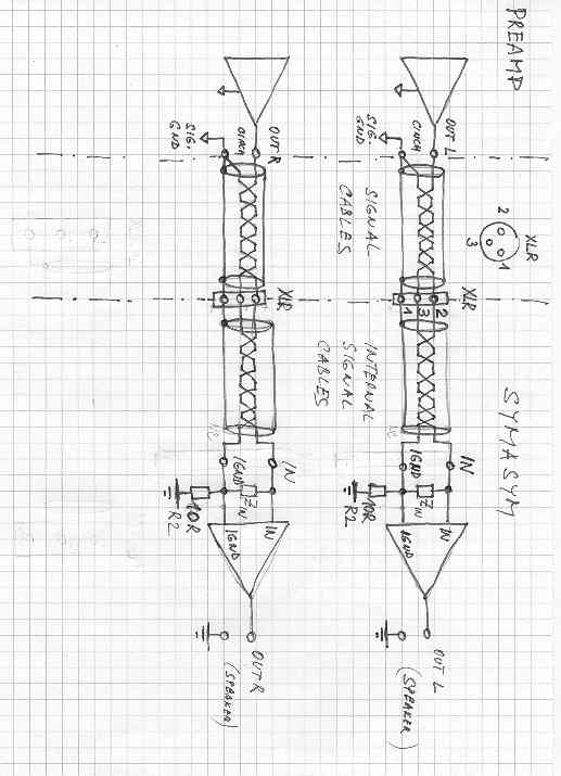

Here is the image of signal wiring of my amp. I use XLR input connectors, though inputs are single-ended. The reason is to utilize all the possibilities given by 10R R2 resistors between IGND and power GND. Both cables between preamp and amp and internal cables are shielded twisted pairs. Together with 10R resistors this arrangement yields excellent hum and EMI supression (see the review spectra), and no ground loops are created.

12 Cents said:Now I wired up a better PSU -> ah, better.
Q: What happens if I leave out C14 completely? Cause that's just what I did.
Nothing bad to the components. Pavel did that during testing of the compensation optimization. As I read the circuit (danger, amateur speculation), that cap will bypass the 22k resistor and increase feedback above about 30kHz. Lowering the value raises the transition frequency.
Sheldon
