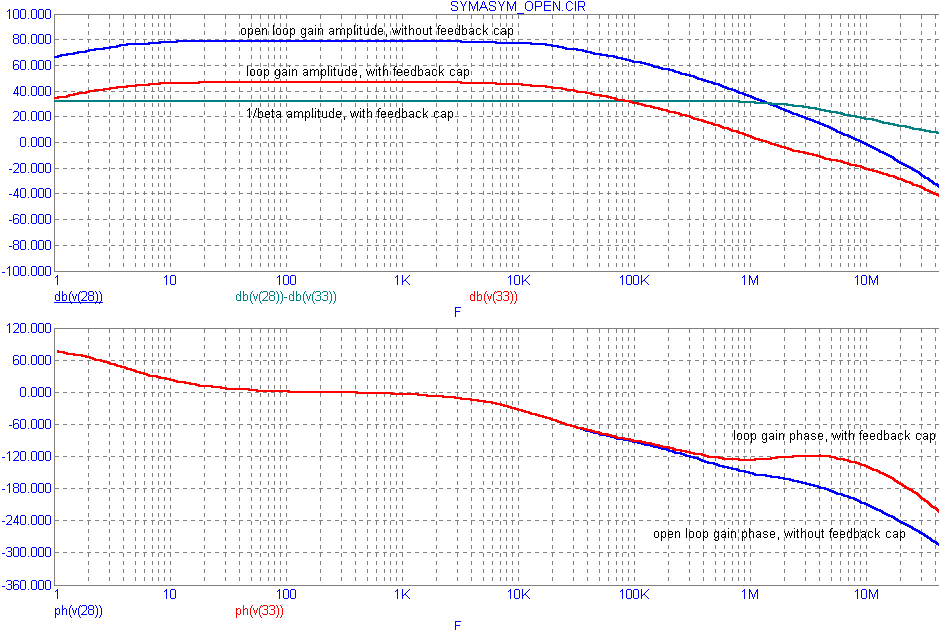

MikeB said:Pavel, you may explain which curve of the 3 phaseplots represents which node ?
Mike
Michael,
sure. Sorry for small delay, but I decided to prepare a new graph with standard feedback terminology included. Here it is, and I am sorry for my pencil-drawn graph shown before.
The graph attached shows contribution of the feedback capacitor as well.
Pavel.
