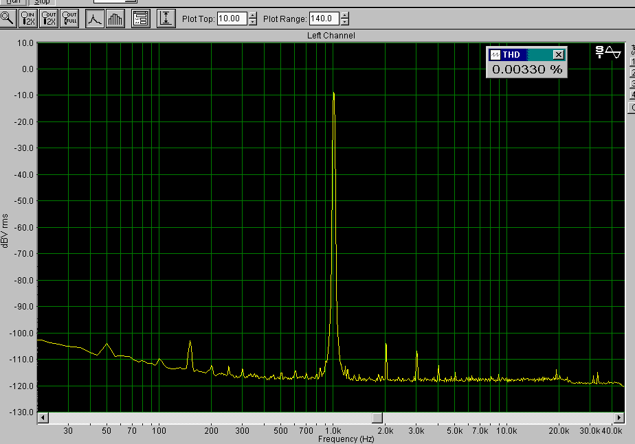

I just performed several distortion measurements. It looks excellent. My loop-back method shows 0.003%, which is the limit and I must bring special generator next week. The attached image is for low-level signal, not very good conditions for class B, but symasym surprised me. 0 dB = 1 Vrms.
The image confirms perfect PCB design. The highest PSU spuriae is -103 dB (related to 1V!!) at 150 Hz. And this line is again a limit of my measurement setup. Such a result is impossible with spider-nest or breadboard amateur construction (Mike, thick wire not used!)
Michael - try these Toshiba's. IMHO they are the best power BJTs in the world.
