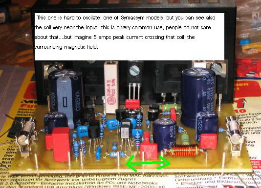

Moray, i was talking about AKSA 55, that amplifier came in many versions, at least
3 versions as i could see, and there are one version that you have the choice to colect the output very near the input, as the board provide, as option, the possibility to install a metalic post between the negative rail and ground star point.... not more than 20 milimeters distant from differential amplifiers.
Depending the way you assemble the output coil, that can be soldered under the board, connecting the output line to some input post, you can have some coupling from output to input,...that construction, if the constructor have not care to put the coil more distant, can produce some metalic treble, and in this case, is the magnetic coupling result as i could test here.
The result is more an effect than a defect, as produces a very interesting sound.
Normally, Aksa has magnificent trebles, unbeatable trebles i think, but bad construction uses, result of some no experienced customers, can create some problems.
This coupling problem is very common, you can see close distance also in Symassym, and in many others.
If you assemble the coil, over the board and aerial, or following Hugh written instructions, the way is shown in the diagram, supplied, no problem, but I made my experiences, also i constructed other coil sizes and diameters, and discovered that many guys can put that coil wrong.
Threshold of oscilation, is because if you put this coil very near, almost touching the first differential amplifier, of course you will have oscilations, i have done it and could listen a broadcasting station that is 4 miles ahead, with 20 Kilowatts of power...enormous AM broadcasting station.
This clean assemble that you can see, was made by our forum friend Greg, from Australia, and the board model was 1.6, he used the output coil in aerial way...pretty construction, and beautifull board, all Hugh board are pieces of Art work.

Hi Carlos !
I was aware of this problem with the magneticfield, but found no
better way to place this coil...
I had done it before, and observed no change in stability.
As the 2 transistors at input are very close, both get the same
signal inducted, so nothing can happen here. (In theory)
And... it's a very small coil...

Aaaagh!...no one can catch you...very intelligent Michael...you are really clever.
The induced magnetic field, as will cross both differential amplifiers will be cancelled...ahahahah..this was great.
But will apply a node on you...take a look in my example of magnetic propagation...can you see that the feedback transistor will receive the interference delayed related the input one?
Hummmm, you will say that the electrolitic will take care of that.
Yeah!...no chance, you win that one too..point for you.....aaaaagh!

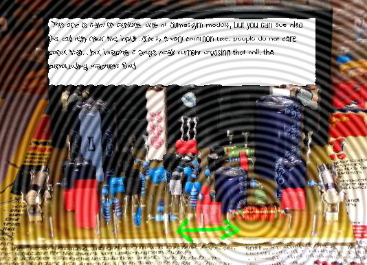

Hi Epupa, this is a Magnetronic picture taken from MikeB amplifier.
Having long time exposition, the waving was the magnetron effect, when 100 watts of 60 hertz tone was over 4 ohms load.
You can see the magnetic image, that Mike said that will not produce interference.
ahahaha!.... kidding guys, this is an picture effect of the ACDsee program...swivell is the name, i think.
But can have some idea of wave propagation from a target source.
