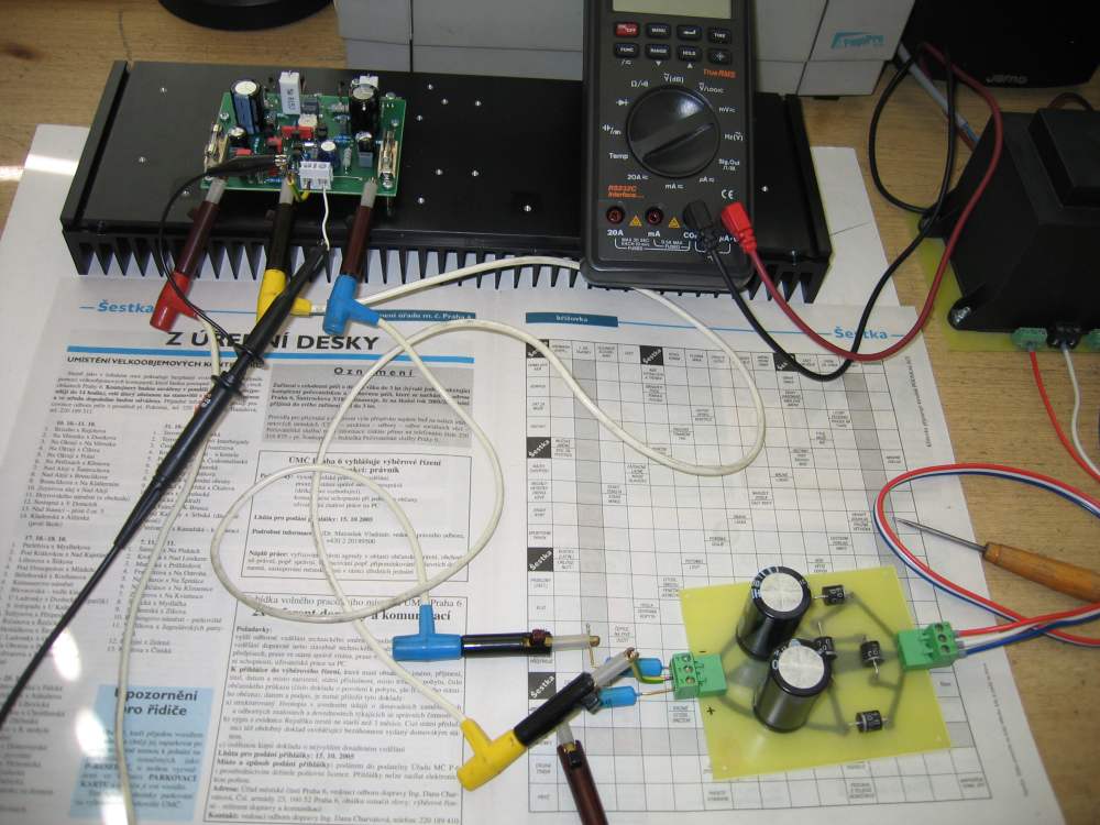

Got this thing working
Hello folks,
This morning I got the amp working fine.
Michael has been a great help and he was not (hopefully) bothered by my e-mail harassment.
I will post the listening impressions soon. I´ll have to wait better components from Germany to give a better evaluation.
My wife is going to kill me soon for spending a vacation with amplifiers
Jarno

Hi Jarno,
I recommend to set Iq of output stage no higher than 30mA, for stability margin. You just measure voltage across R27 by DVM. Then:
Iq = V(R27)/R27 = V(R27)/0.22
So you should read about 6.6mV on DVM display.
Maybe Michael has another recommendation?
