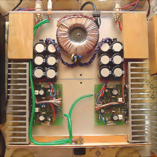

Re: Beautifull construction...one of 10 ultimate constructions made in this forum
Very nice, but I don't see a fuse or mains switch. Naughty! 🙂
destroyer X said:Sheldon have constructed also a pretty one...
Yes, very nice, this one is from Borys i think.

Hey guys!
I don't have much of a way of making circuit boards... Anyone have a point-to-point soldering diagram? 😀
On the serious side, exactly how sane is it to try to wire SymAsym this way, and what do you think that the outcomes would be? If I'm crazy enough, I might even attempt it!

Hi keantoken,
Use a 10 div / inch breadboard. Make sure your wiring exactly follows the pattern and use heavy conductors for the supply and ground traces. It should be okay if you are careful but more work on your part.

keantoken said:Hey guys!
keantoken
I made my first two that way. They work fine, after sorting out some problems with bad transistors (it was either that, or a bad connection). I just took the schematic and built from the input out, following the way the schematic is layed out. But to do it again, I would do as Chris suggests. Get perf. board, print out the board layout to scale and just follow that. It will be much easier. There's no reason it shouldn't work just as well as the printed board. The crew here can tell you how to print. Make sure you get a copy of the top of the board, so you know where to place jumpers (not essential, as you can figure that out from the schematic, but it will be easier having the top side view).
Or, you can buy a board making kit like this: http://www.radioshack.com/product/i...cuit+board&kw=circuit+board&parentPage=search
Carlos is an expert at doing it this way. I know that he's described his method in some detail here somewhere. My next prototype will probably be done this way.

What do you use for heatsinking the components? Do you just use one of those heatsink clamps that come with most Radio Rhack soldering kits?

keantoken said:What do you use for heatsinking the components? Do you just use one of those heatsink clamps that come with most Radio Rhack soldering kits?
Who knows... Maybe one day I'll design some point-to-point soldering diagram software. 🙂
I use aluminum plate and thermal grease between back and sides, so that the three surfaces act as a heatsink/radiator. See here for example - also on perf board: http://www.diyaudio.com/forums/showthread.php?postid=737581#post737581
Sheldon
edit: And here with printed boards - this one stereo, same type of heat management: http://www.diyaudio.com/forums/showthread.php?postid=862086#post862086
