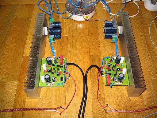

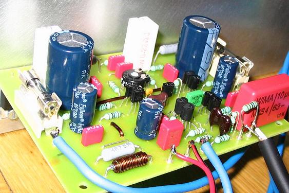

Hello all,
This is my mirrored symasym. The music that come out from a peer of Monitor Audio B4 is lovely, warm and soft. It is the best amplifier that I have made so far.
Thank you very much Mike, Pavel and all of you who actively participate at this marvelous project (I don't forgotten you Jacco, thank you too sir)
I succeed to obtain -0.3...+0.4mv offset, matching k170-bl JFETs in less than 0.5% D-S current. The same peers of two symasym amplifiers, with MPSA18 in input diff amp, have -3.5...-4mv offset (hfe matched in less than 1%).
I have MJE15034/35 as drivers and MJW0281/0302 as a finals. The iq is set at 113mA. In fact, I don't perceive any difference in sound between 10...300mA iq but I like 113 number 🙂
