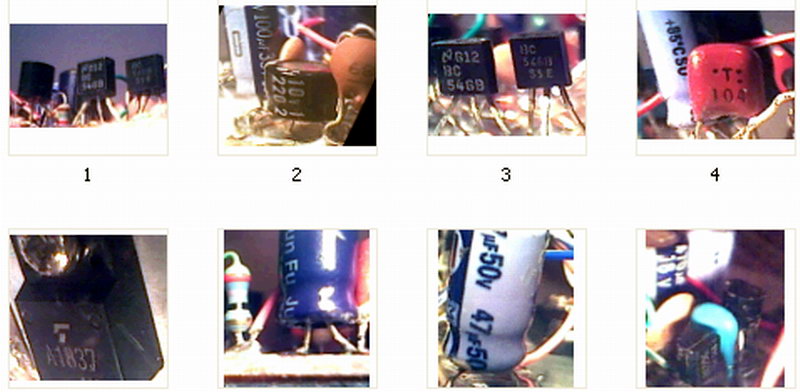

Explendid amplifier designed by Michael Bittner, our MikeB
Some small image details...the Discrete Chip...hehe
Of course kidding related to the Chip.....may be Cheap!...but not a chip!
regards,
Carlos

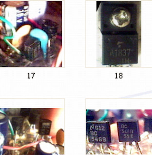

I could not find gain 900 transistors as Mike is using.
In the reality, i have to confess (I am old) that i never had measured a "non darlington" transistor with more than 550 of gain.
Those modern units Mike is using are wonderfull, and unreachable here.... and may result very different.
Well, my amplifier is sounding very good, and i feel shocked with that enormous difference in gain, and even this way sounding good.
Yes!...i have asked friends to hear and all them evaluate it as a very good amplifier too.....not only my evaluation, as i do not use my evaluations because only one guys opinnion is not something precise enougth, there are human factors that can change a little the evaluations.
For instance, personally i hate snobish guys, and i imagine that my evaluation of some "Snobberamp" will be not fair, because i am not a machine.... this guys amplifier cannot be presented to me before my audition, because it is hardly possible that i will not apreciate it.
And this is not very strange..... think about the idea i will explain you.
You may love Violin.... you may feel good with the sound....many years hearing and apreciating the Violin sound..... chords...you happy with violin.....but...someday one man that plays Violin very well started to watch your wife with interest.... and the damned advanced too much, and despite respectable woman, you wife felt enormous empathy with the Violinist, because his art, his capacity of play wonderfull songs....and you turning green with that damn thing, and the stupid Violinist wanting your wife, and you wanting to break the Violin into his head.
I will not like his Violin music anymore...Am i unfair in my judgement...no!...i am human!
Reason why the Enginners, some Numerologists, Number-0-Logists, apreciate so much numbers, as they are afraid of the ones play Violin better than they can....ahahahha.
Kidding.
Well...by the way Mike.... i will have your prefered food... Schligtisch or something alike.... will be burned till be toasted...hehe...cheers.
regards,
Carlos
