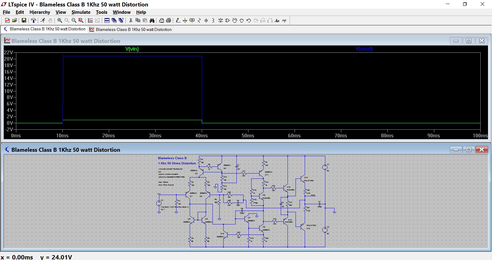

This shows a typical Class AB amp (described by its designer as a blameless Class B) that is biased to around 100ma.
The load is a 100uf capacitor of 0.08 E.S.R. Totally unrealistic, however...
Question :
If we apply a step function of 1 volt peak to the input, why does the output voltage NOT remain at the nominal level of 21 volts.
In other words, if (as you say) the lower transistor has no control in being able to 'pull' the voltage down... then what does ? Why does the cap not remain charged ?

There you have a 100W artifact , your speaker would be beaming 100X
that distortion right in your face. The amp would be quite the background
"performer". Speaker is at 1% distortion , BTW.
PS- this is what I give the forum , but can not make their speakers "blameless".

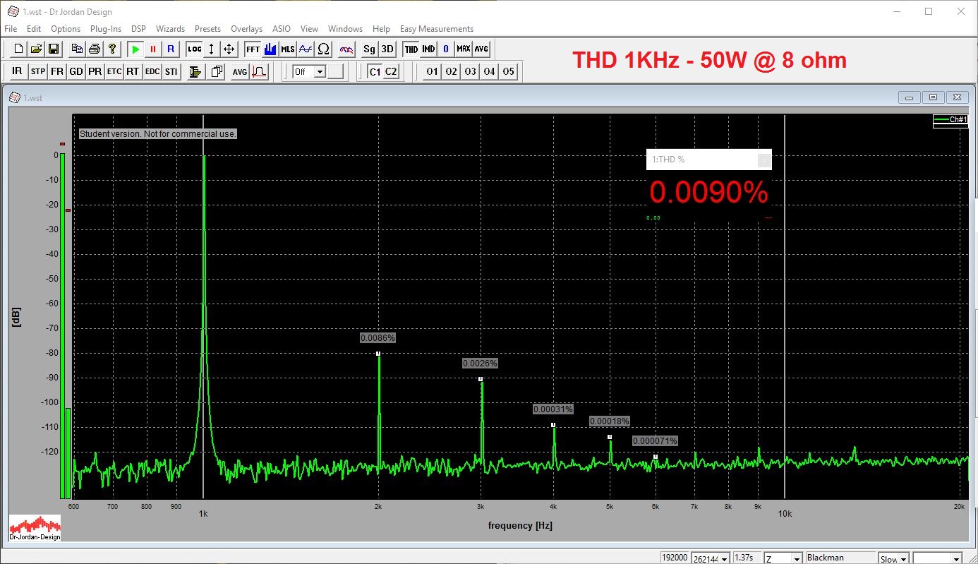

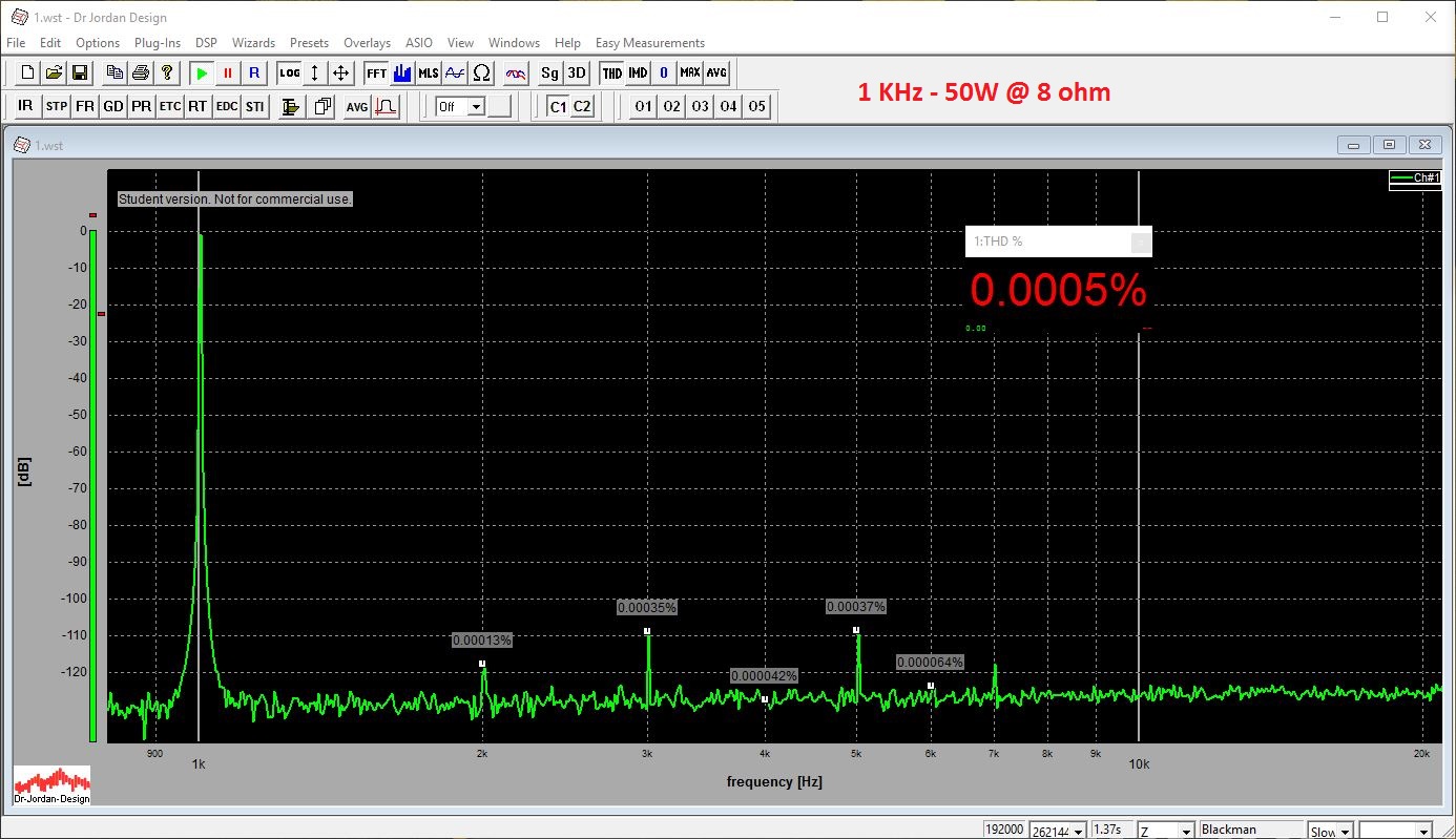

Oscilloscope is not that precise, you will not see some 2-nd + 3rd harmonics at the level of 1% THD on the scope sine curve, however you will hear it. But you will definitely see those components on the spectrums. That's why we use spectrum analyzers for measuring distortion and clear understanding of its profile.
For example, here are two spectrums, measured on the real amplifiers.
The first one is a top-class amp, utilizing a non-switching output stage.
The second one's distortion level is definitely higher.
You will not see any difference on the scope. Nothing at all.

Well, this is also not that easy 😉
Absolutely. An FFT must be used. However, it also doesn't tell the full story. Crossover distortion sounds a lot worse than a little 3rd harmonic caused by device non-linearities. 1% distortion caused by crossover distortion (which is like a sore thumb) is far worse than 1% distortion due to device non-linearities (which are not easy to hear).
ETA: Now I sound like a "snake-oil" guy. The reason for the above is the myriad of frequency components added by crossover distortion.
Yes, sure - crossover is a very bad one, producing lots of components.
The one I showed on the right is a properly biased class AB, so ... certain visible distortion is there, but it's got a good profile and no crossover dominance.
