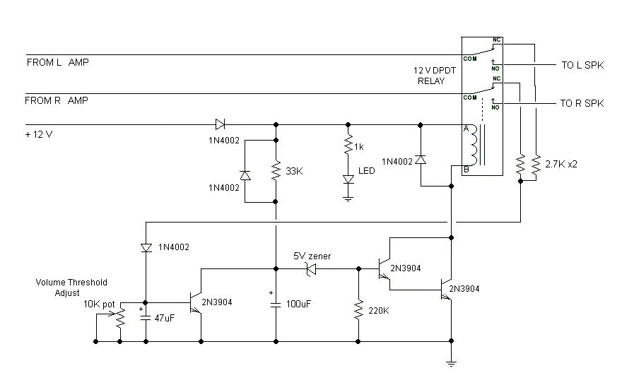

I've added a time-delay to 'some' amp outputs to avoid heavy thumps at turn-on.
Other amps, like cap-coupled, aren't too annoying, only to those that are annoyed by that split-second noise that usually obsessed nervous nutty people are bothered by.
And that's their problem, not mine.
My design of an optional delay is very simple, on a perfboard or pc board 2"x3" takes up the space of a pack of cigarettes, so it can be mounted anywhere appropriate.
And, additionally, it has a volume sensor, which, if the amp was last used at high volume, it will not allow the speakers to connect until the volume is lowered to a preset reasonable level.
This is to eliminate the sudden blast that would happen if say, someone was sleeping nearby, or a child cranked up the volume knob when the amp was turned off.
Also, is used in a cap-coupled amp, it allows the output cap to 'charge up' to the half-voltage level prior to connecting the speakers, and avoids that thump.

My simple circuit (above) works nicely, and has a quick reset time in case the power is turned off and then back on.
The only noise from it is the relay click.
The on-board LED is there to quickly discharge/reset the timing circuit at power-off.
The diode across the 33K resistor helps with that discharge.
With the values listed, the delay is around 5 seconds, adjustable by changing the 100uf cap.

It's all the little details taken together that can make something a joy to use I find. Your circuit is fine and I like the auto detect of a volume level that is way to high... nice feature. The Zener that allows a decent voltage to develop across the cap is worthwhile to and something that's often omitted.

Yes, part of the timing is the zener's knee 'kick-in' voltage.
Works like a charm.

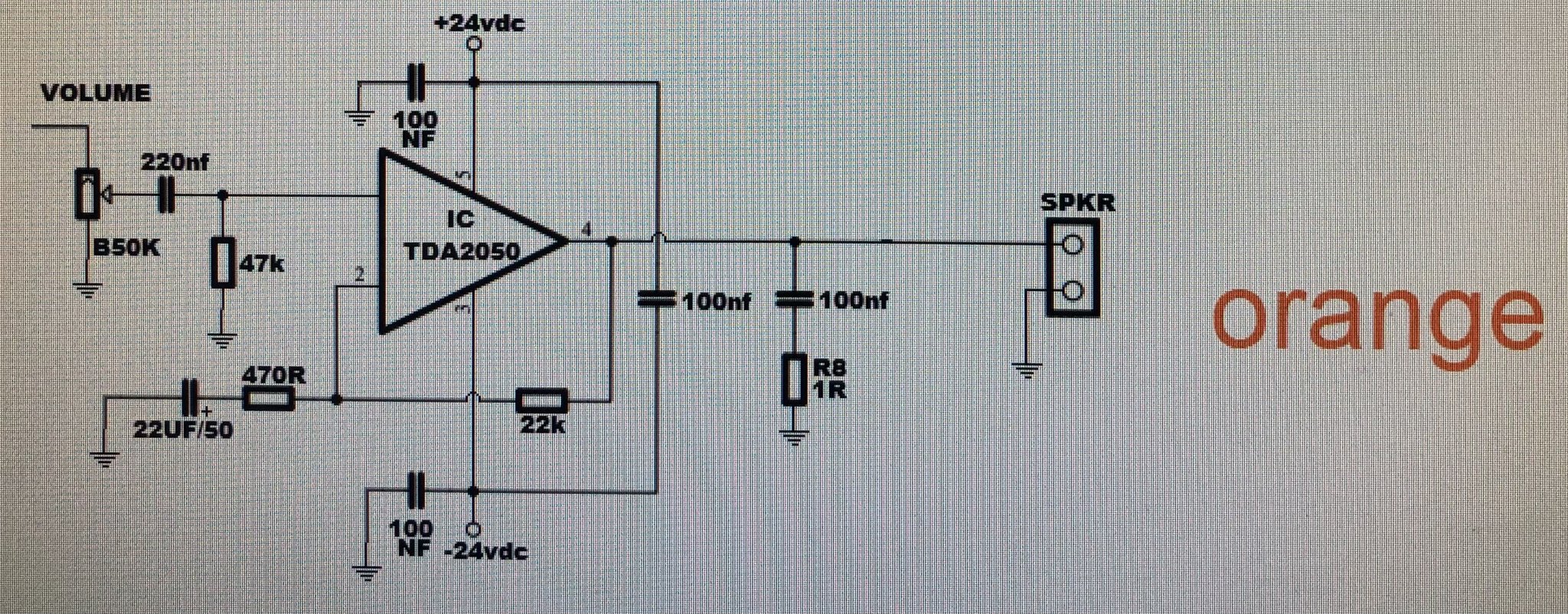

So guys I have now a very strange problem ,, I finish the voltage board -clean preamp board - overdrive board and power amp board … I test the clean preamp with power amp and the sound is great … now I test the overdrive board with power amp and I have some kind of oscillation … I test again the O.D. Board on my Marshall amp and works perfect without oscillation .. and I test an onother overdrive pedal with the power amp board and work perfect without oscillation … note : the O.D. Board works with 9vdc instead of 15vdc of preamp …. Where is the f***** problem !?!?!?! Any idea ?
I think we would need to see all the circuit details. Could you be driving the power amp into some sort of clipping so it is latching up and appearing to oscillate?
I put my very very high distortion pedal in frond of power amp and I dial the master volume all the way up .. power amp works great ,, but I can’t understand what is going on with the other O.D. Board ,,, I don’t have time to find it ,, just I add onother board for o.d… thanx by the way ..

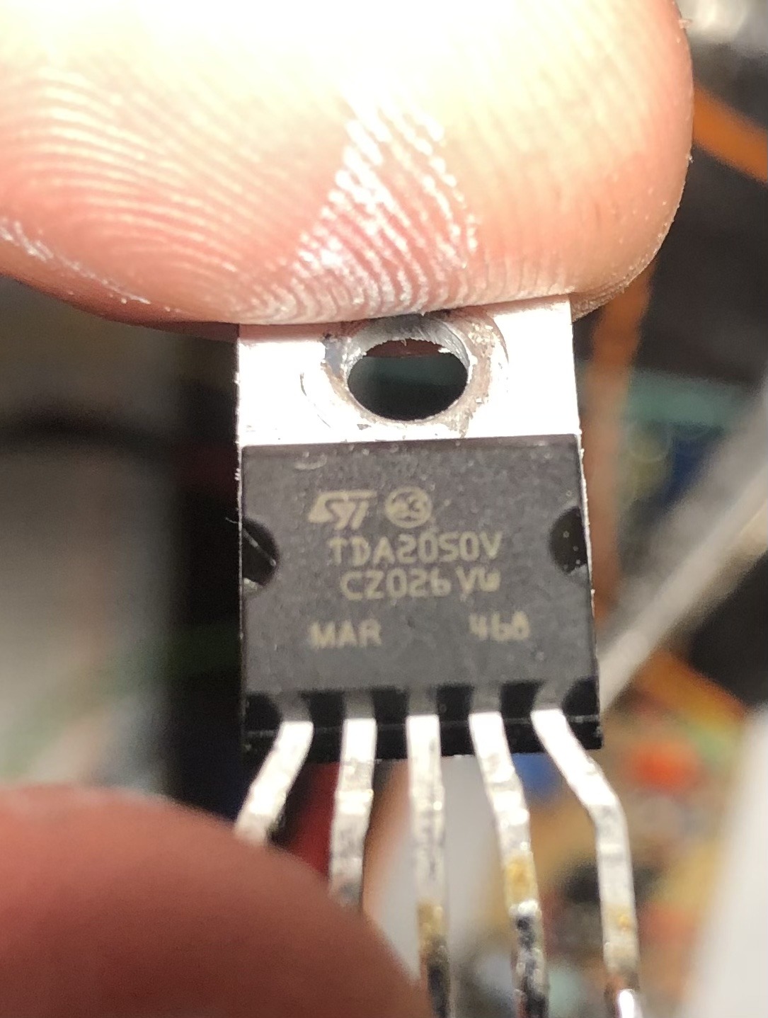

I found the problem ,,,, it’s the power amp , the tda2050 is dead or working like zombie .. I put onother new 2050 and I notice the heat sink is burning !!! I test it with clean signal and for 5-6 minutes is ok , but starting to make strange noises and the guitars clean signal distorted ,, and now just make a hum noise .. I am using the schematic of ORANGE for tda2050 … and I show you the original schematic of tda …

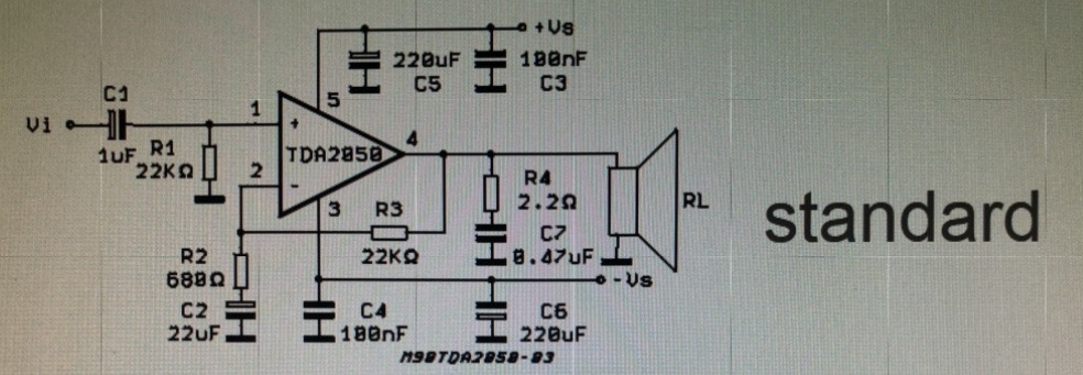

You need to be sure the chips are genuine because I think the TDA2050 is no longer manufactured. Make sure they are not just rebadged TDA2030's or similar. Your circuit in post#1 shows -/+48 volt rails which is right at the top end for a genuine TDA2050

I’m think is genuine , I’m using -/+22 volt on the ic .. I’m trying the original circuit .. must be reduce the voltage ? And I keep the input potentiometer as the same or change it with 10k?

Sadly many fakes around.
I was burnt with a lot of supposedly ST TDA2050, "perfect" in every detail, such as yours, bought from a supposedly "serious" supplier 😱 which can NOT stand +/-22V (so 44V end to end) rails at all.
Some start overheating on their own, some wait until passing some signal through, fact is they are all unusable.
But they all work perfectly well, zero problems, with +/-18V (hint hint) so I guess they are relabelled TDA 2030 chips.
A problem for me because I had designed 25/30W Guitar amps, for which there is a market; not interested at all in 15W ones of which the market is more than saturated.
Just not to fully waste them, I´ll probably design a new bridged output using two of them, for real solid 30W RMS, but for now that is in the back burner, lots of unfinished projects before them.
EDIT: I suggest you build a quick and dirty 16+16V supply, using a 12+12V AC transformer, or even a voltage doubler one out of a single 12VAC winding just to test your "TDA 2050". IF they now work properly, then you got the same kind of fakes as I did: relabelled TDA2030 which is the most common out there.

Very very nice post my friend …. I'm probably going to do that with 2030 ,, sounds good 👍.. but I don’t have now a 12-0-12 vac transformer ….. do you have a good schematic for the 2030 ? And can I test it with -15/+15 vdc ?
