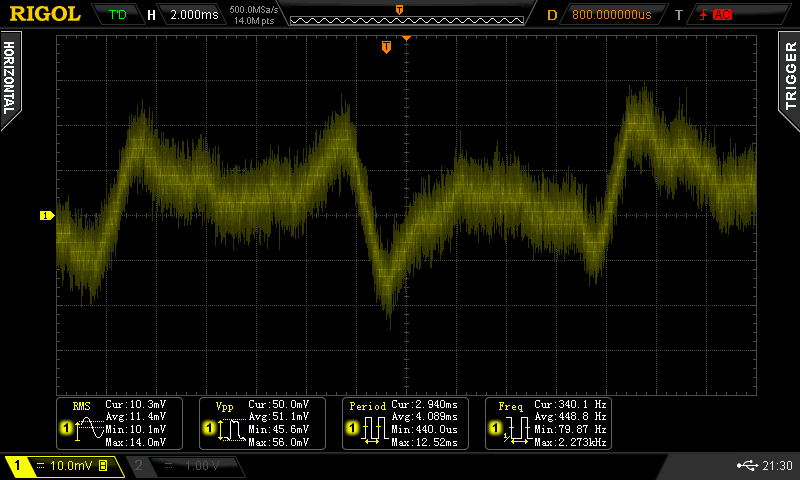

Next 2 tests are done on a board which is powered by this supply. The board has a local decoupling capacitor (470µF Nichicon LF).
File #4 : Transient response 15mA to 45mA
It looks much better now, with local decoupling.

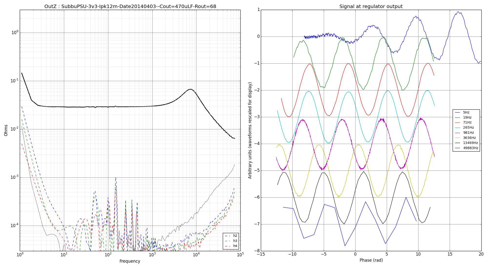

Last file : Output impedance.
30 mOhm at DC (including the wires). There is no sign of resonance or instability. Distortion is low, which means the output impedance is quite linear.
To suppress the impedance bump, a higher value local decoupling capacitor could be used.
If the purpose is to feed local LDOs like in the Subbu DAC, no problem.

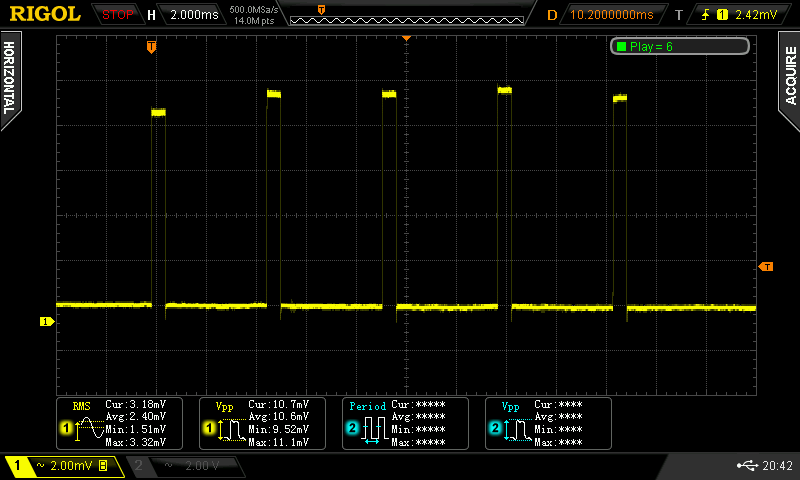

EMI Test :
Of course, all is not perfect, so here comes the dreaded cellphone test. I put my cellphone on the mains power cable, make a call, and look at the power supply output on the scope. I try to position the cellphone so it gives maximum interference.
I could get 10mV pk RF detection at the output.

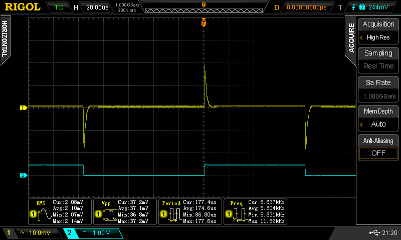

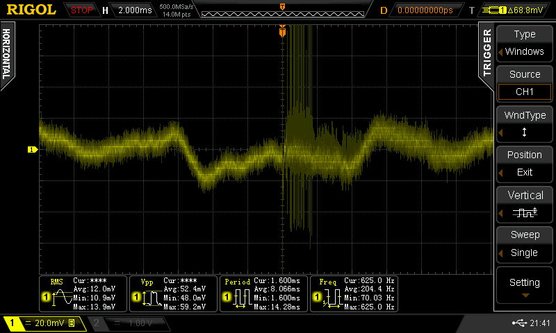

Eco-light Test :
I plug the supply on the same power bar as a lamp with an eco-friendly bulb (ie, big interference source), and switch the lamp on and off. The scope's trigger is set to catch the event.
Here, the x1000 preamp is used. Even though it looks nasty on the scope, the interference burst is only about 100µV of HF. The local capacitors on the DAC board will neutralize it.
The trace looks noisier once the lamp is switched on, so I ran a test with the power supply unplugged. The preamp runs on batteries, so the lamp switch-on noise burst is completely absent from the output, however the lamp's electromagnetic emissions are picked up by the cabling and the PCB. So the noisier trace after switching on the lamp is not the mains noise going through the power supply. A metal chassis would fix that.
Conclusions : The supply shows good rejection of mains noise. A mains entry filter and a metal chassis can still be useful.

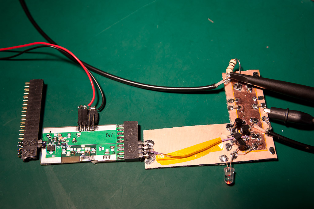

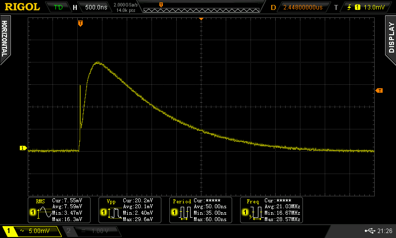

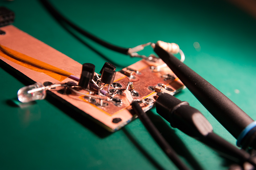

Anyway, let me introduce this guy, I call him Forrest, because he looks retarded, but he does run pretty fast !
Attached pictures of Forrest and his buddies the current source and NE555 pulse generator.

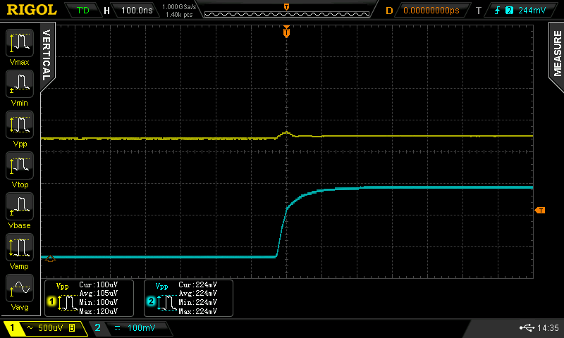

Scope shots are the transient response to a 23mA current step. Blue is "current" (measured as voltage on the injection resistor), yellow is Forrest's response.
Forrest is built out of a bit of PCB that was laying around (hence the deformed shape), Kaptan tape (chinese version of Kapton) and the "power plane" is a bit of copper tape. It does a nice emulation of a 4 layer board with thin spacing between power/ground planes though, which is the interesting bit here, low inductance. There are 2x 10µ and 2x 1u X7R at the output, maybe they still work, these caps have been desoldered a few times already...
Forrest is dumb so it doesn't have a voltage reference (just a LED). It outputs around 2.4 volts.
The thickness of this copper tape is unknown, but from the price I got it on fleabay (and the label that says "insulating tape") it is probably the thinnest possible kind of stuff. Since Forrest's output impedance is roughly the same as the bit of copper tape... it is a bit of a of problem to measure it here...
As for the transient response, well, I seem to need a faster pulse generator since what this thing is really measuring is the NE555 rise time, not so bad for another old dinosaur, around 30 ns on the fastest part of the edge. The regulator doesn't seem to care, as far as I can see.

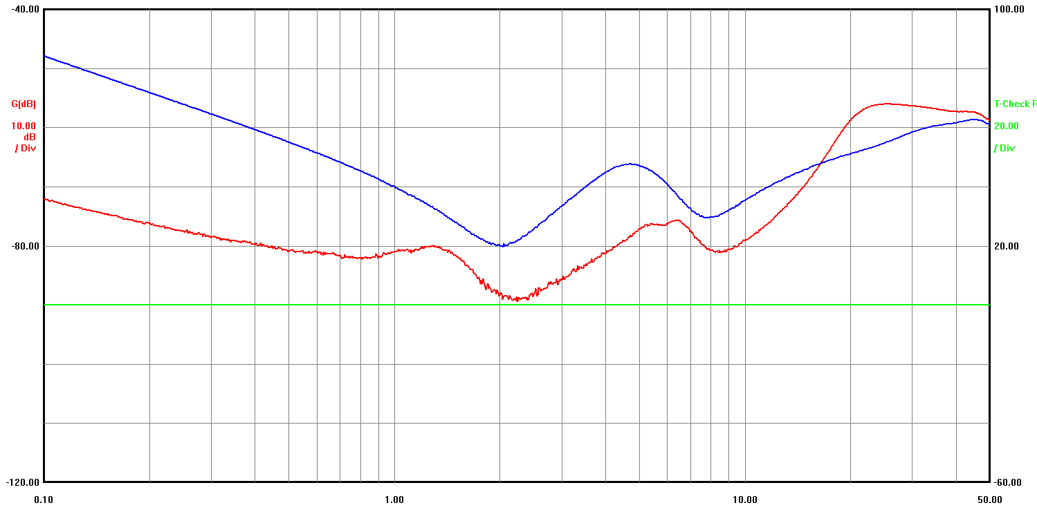

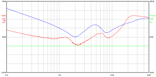

A network analyzer transmission measurement is included. It doesn't give impedance directly (it is transmission relative to 50 ohm). Blue trace is power off (just caps), red trace is regulator powered. The ceramic caps are visible as the two little valleys.

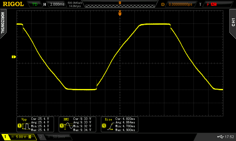

Someone asked :
jerry g said:
The Jg/subbu psi you recently measured has no Quasimodo style snubber on the transformer secondary.
Would that be overkill? Tia

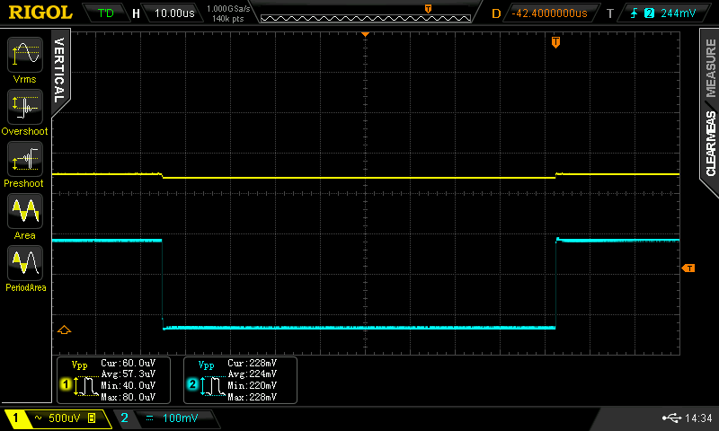

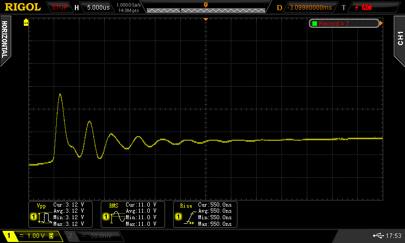

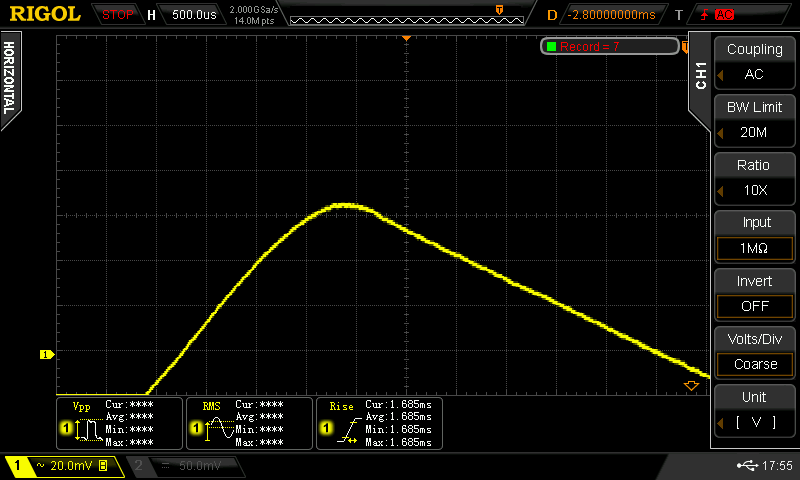

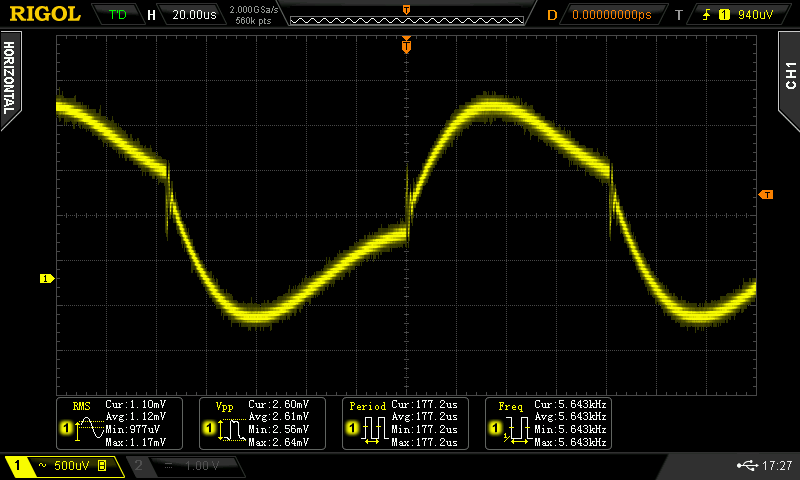

So, I stuck the 10x probe on the transformer secondary.
I set trigger to Line, it gives the first picture, as we'd expect, a sine with flattened top and little diode switchoff glitches at the end of the plateau.
I increased the sensitivity and adjusted the DC offset to zoom on the diode glitch. Then I hit Record and could walk around and expand the time axis at will. Gotta love this scope.
Second shot shows the diode glitch in pornographic detail. There is a bit of ringing, but it's not that bad. Massive poweramp toroids are a different story...
Third shot shows what happens on the second smoothing capacitor : nothing to see here. There is not a hint of high frequency garbage. The output is clean anyway.
If you really can't sleep at night, you can put a snubber 😀
