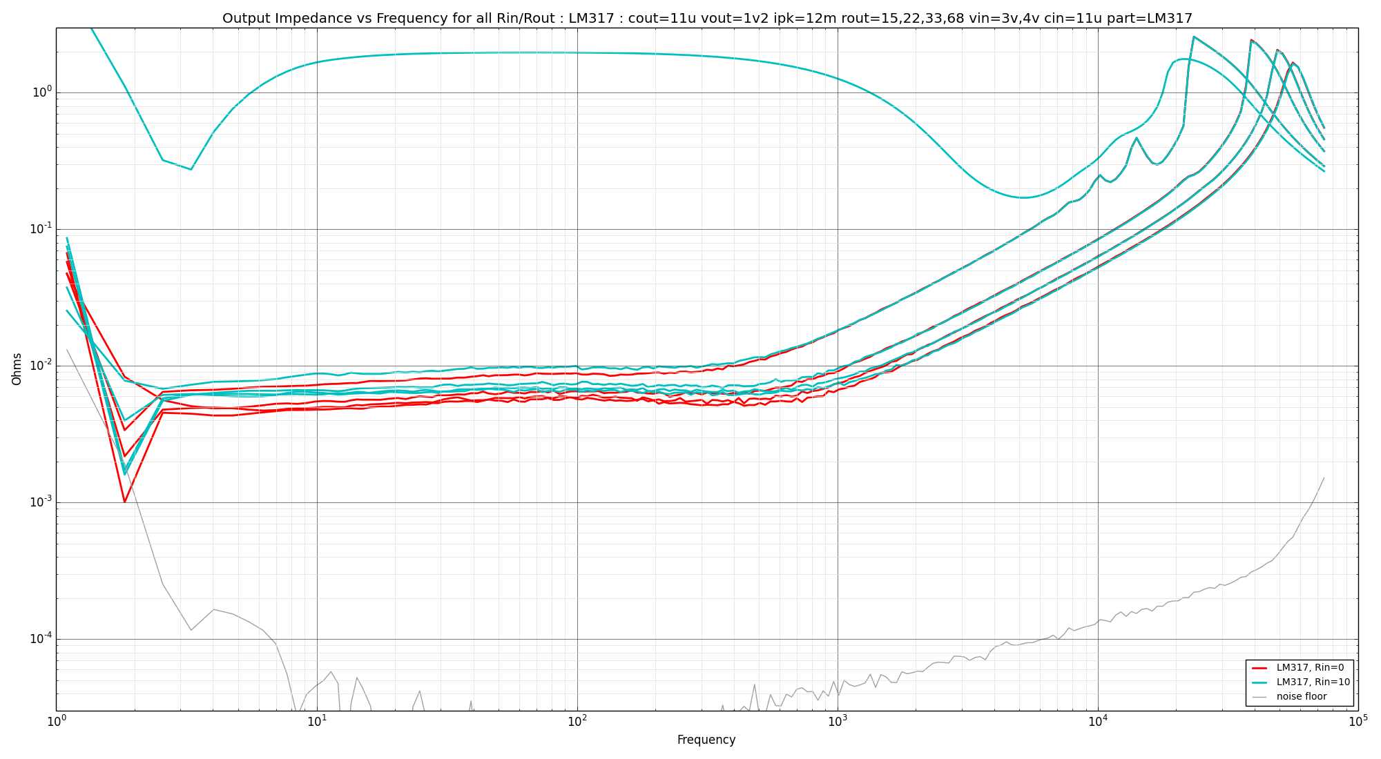

First victim : LM317
I will show the same curves for all tested regulators.
Here, impedance is plotted :
- with/without 10R resistor in the supply (different color)
- for all values of load resistors (all curves of the same color).
Its dropout is a bit high, and when Rin is set to 10 ohms, lowering input voltage at the higher test current, it stops working, as shown by the uppermost blue curve.
Also, this old fart was born before the age of ceramic decoupling capacitors. It does not like modern caps with low ESR. Here, it oscillates nicely, as shown by the huge impedance peak.
It will be unstable with virtually all modern capacitors, btw. I just tested it because I had one around. Using LM317 means the caps have to be selected appropriately, as per datasheet, with high enough ESR to make it stable, and bypass caps have to be applied with caution.
So, LM317 is out.

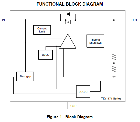

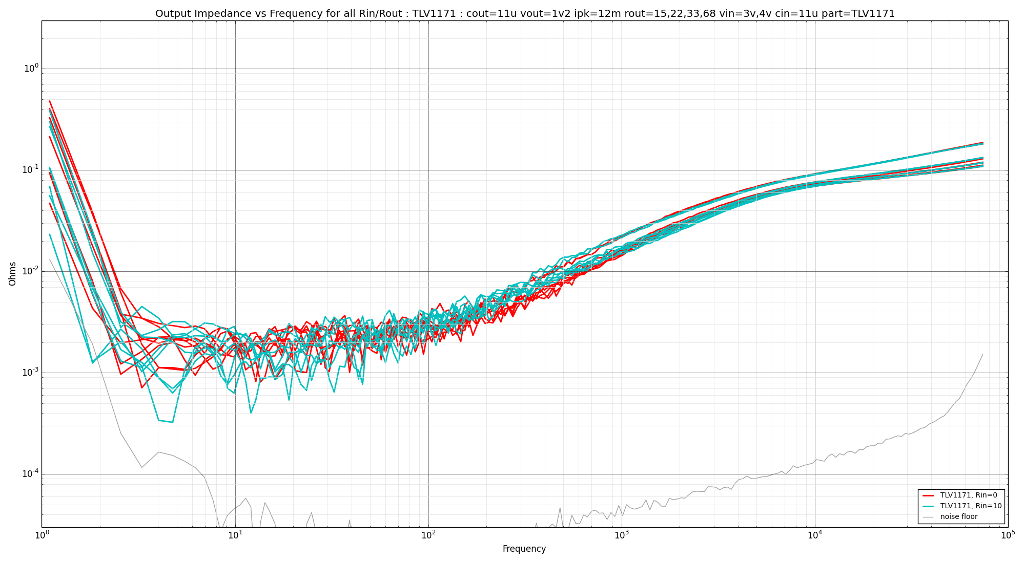

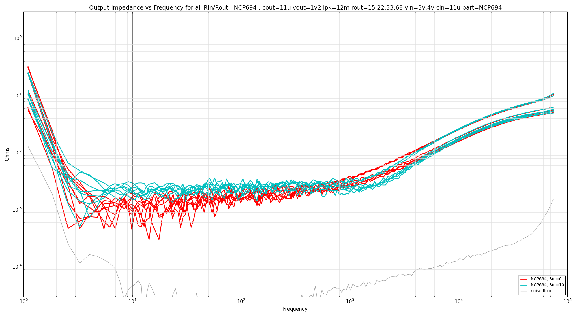

Next victim : P-type LDOs
The typical LDO has an internal architecture like this :
To achieve low dropout, the pass element must be either a PMOS or a PNP transistor, which acts more or less as a current source, driven by the error amplifier.
Extremely low dropouts can be achieved (in the 10s of mV for some LDOs). PMOS also allow extremely low ground currents.
However, the output, being a drain or a collector, is high impedance before feedback is applied. The output impedance therefore depends entirely on feedback.
This means we can expect it to rise at high frequencies... but how much ?

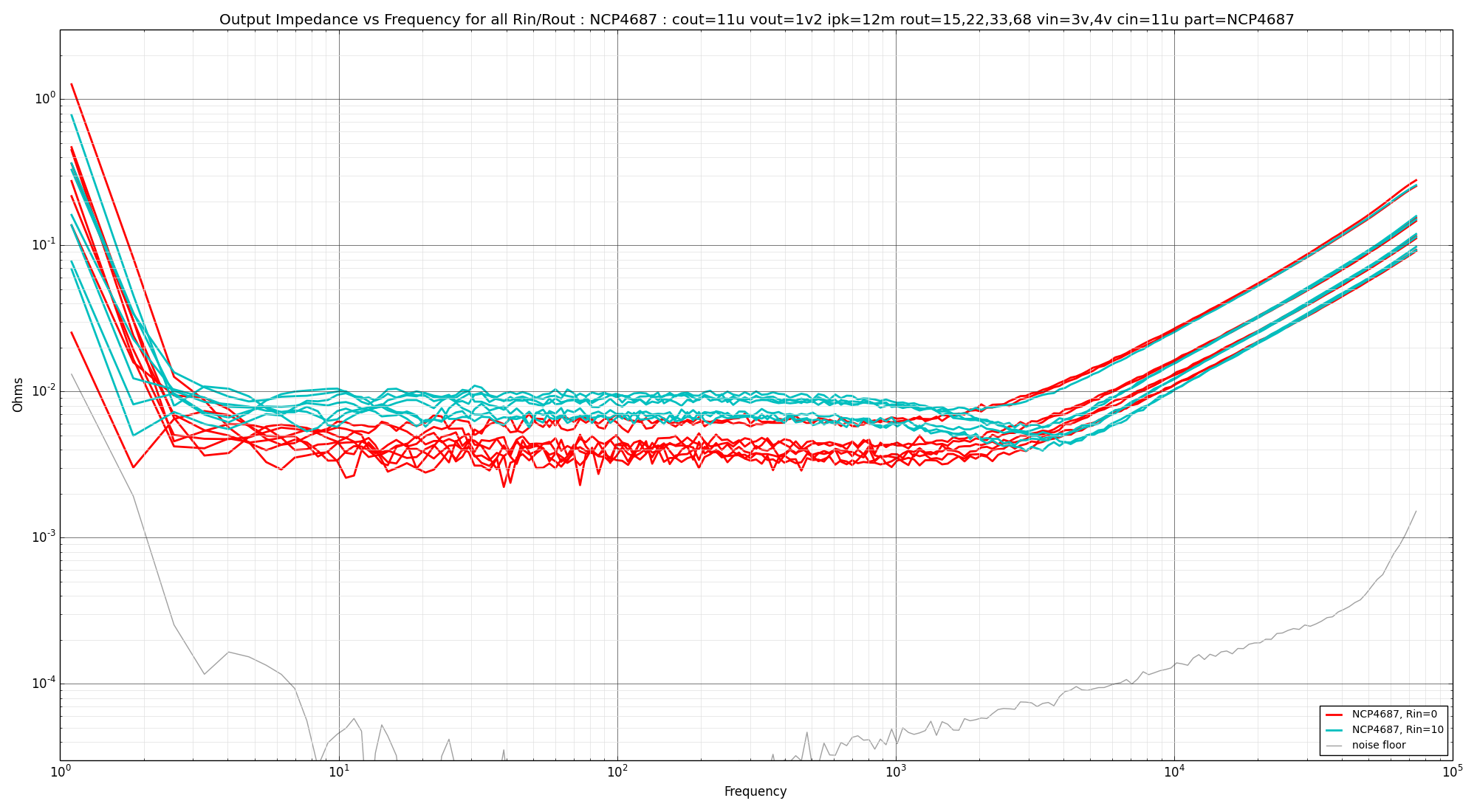

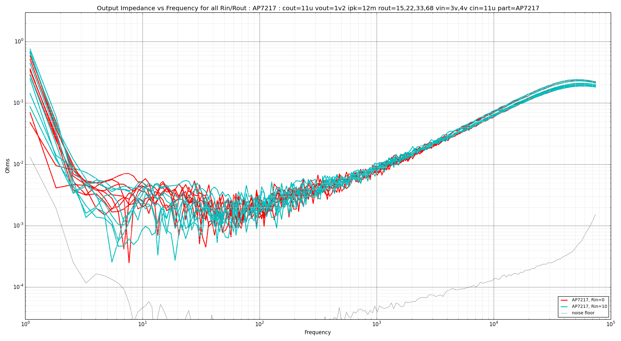

Here are 4 different LDOs measured, same as above, at various input voltages and load currents.
Some of them have impedance varying with input voltage and load, others not, but all have the same characteristic : impedance is very low at LF but starts to rises at not so high frequencies.
At 100 kHz all of them don't look so good.
The AP7217 impedance rises enough to show the 10µF output cap taking over at about 60 kHz.

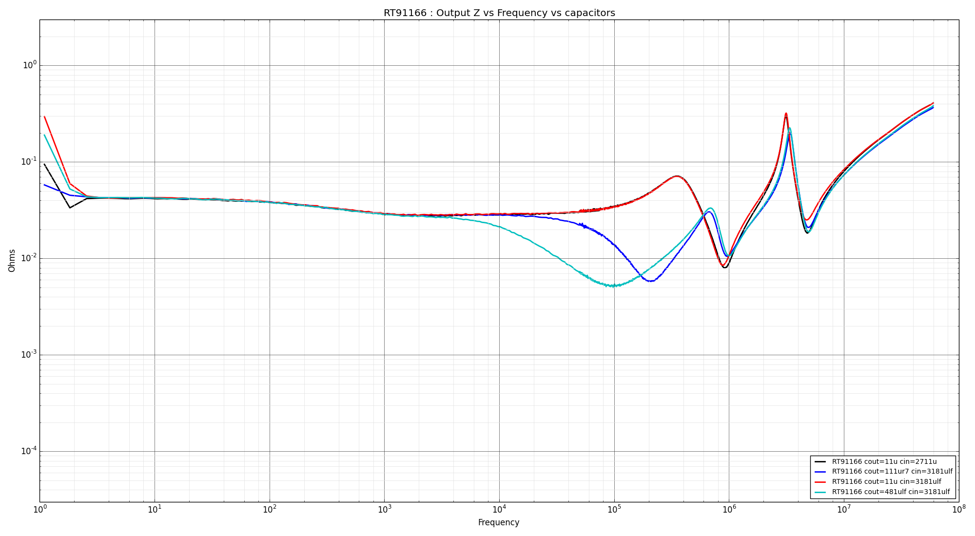

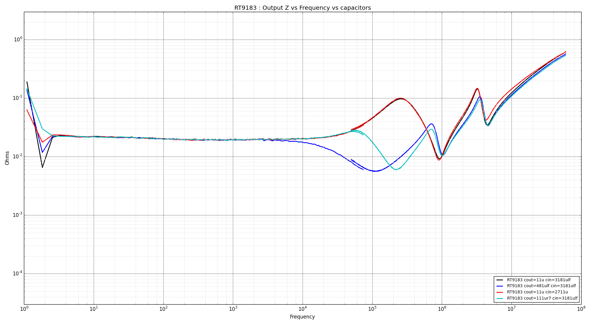

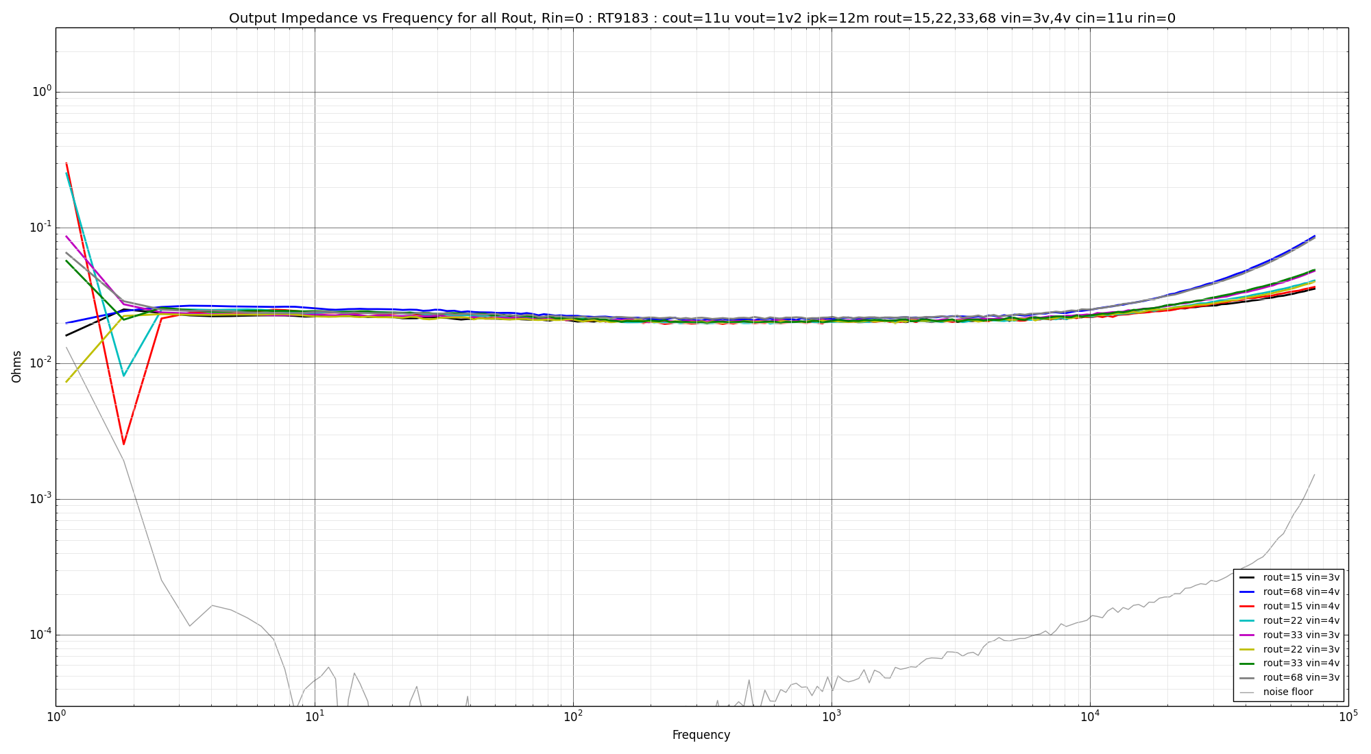

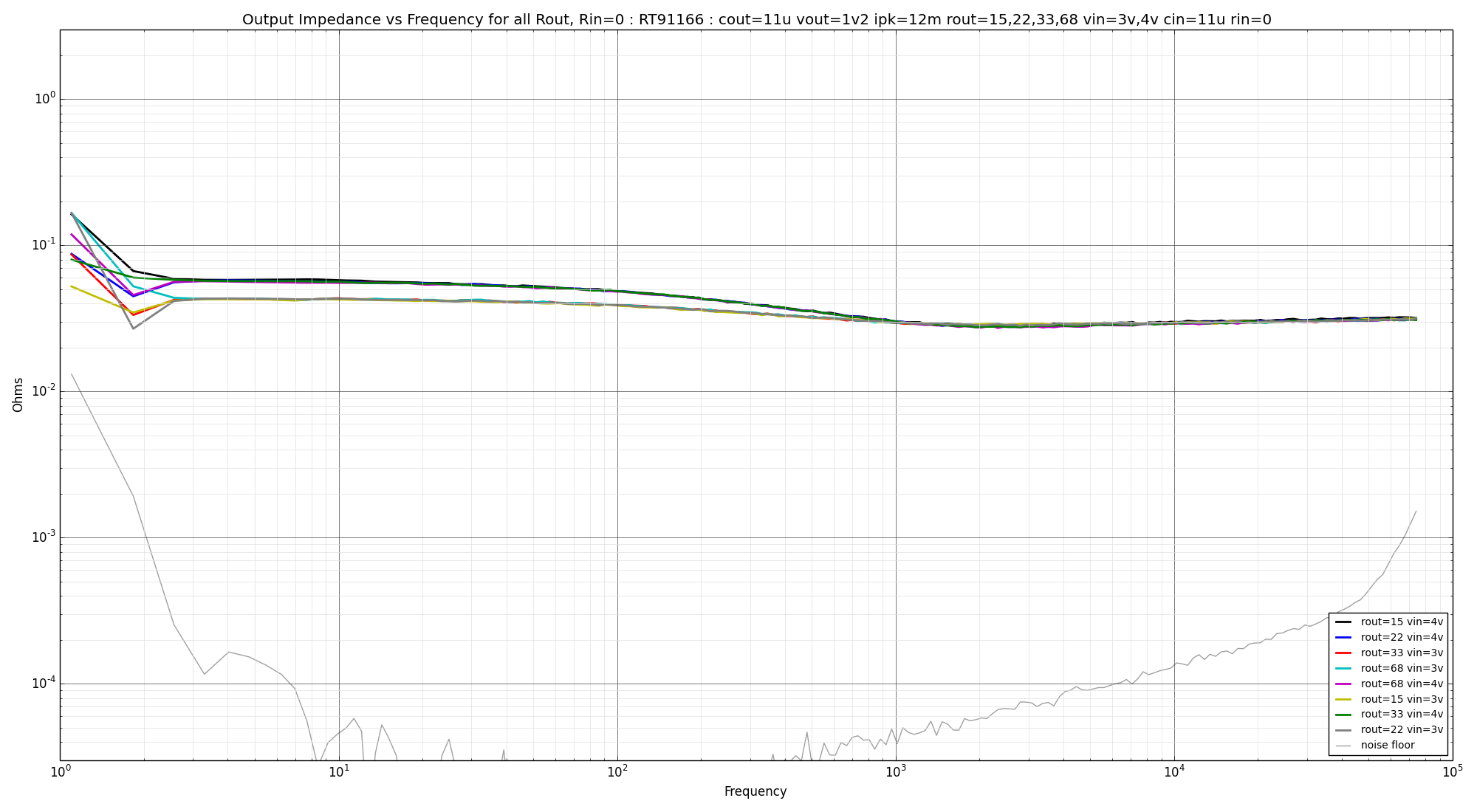

However, not all PMOS LDOs are slow.
Those two by Richtek have a bit higher dropout that the others, therefore I do not show the curves with 10R resistor in the power supply, which reduces the input voltage too much. They're perfectly happy at 3V input, so no problem.
Their impedance is just flat. At low frequencies, it is higher than the previous bunch, but at high frequencies, those two start to win.
Especially interesting is the second one which is ruler flat at 30-40 mOhm from DC to 80 kHz. Nice.
EDIT: fireworks: I added the forgotten pics !...
Can you post the graphs for those two also ?

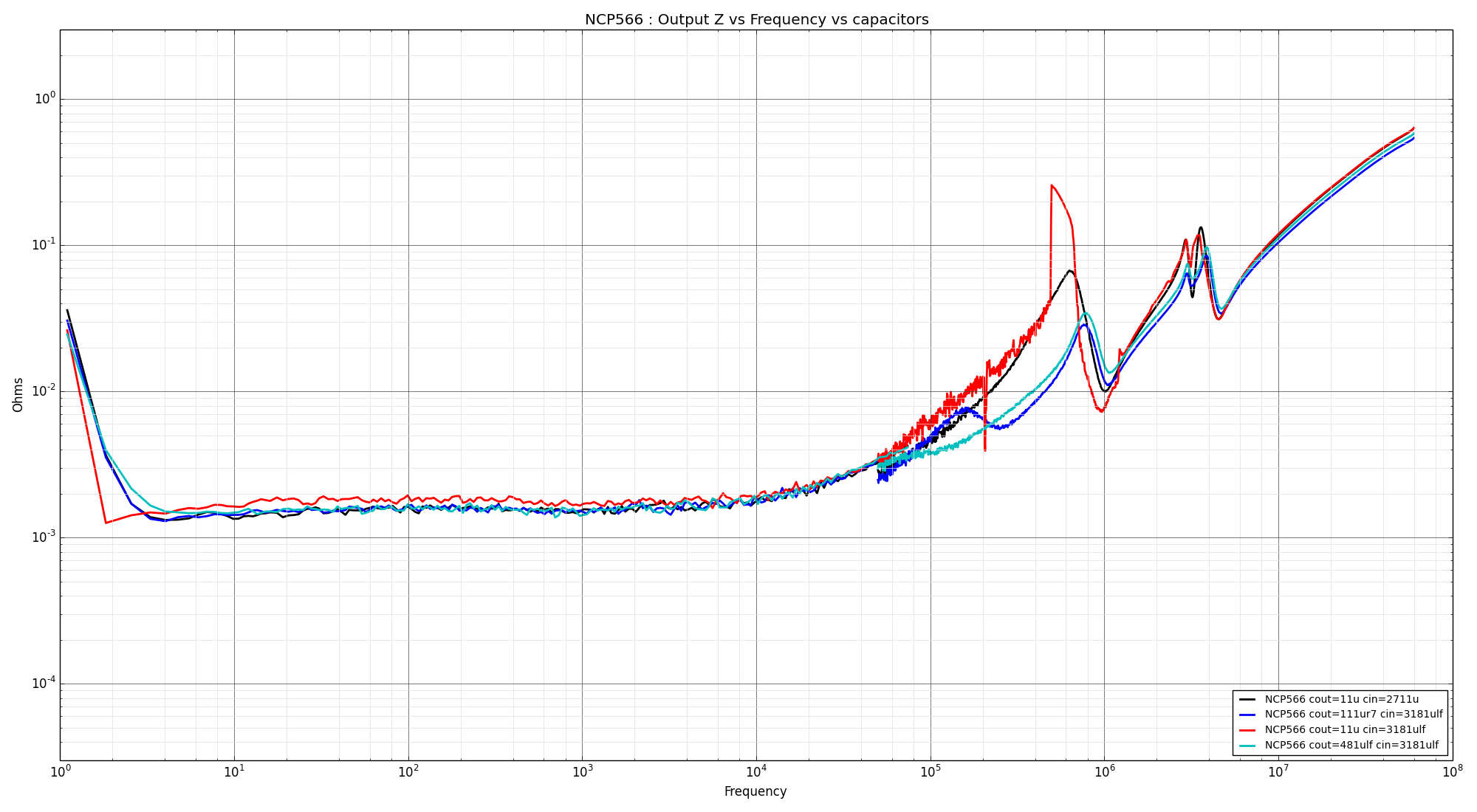

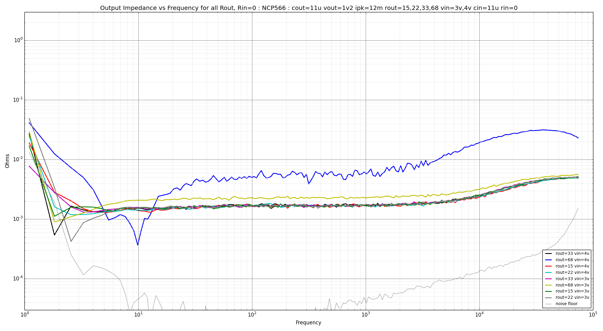

And finally, we have an outsider, NCP566.
What is inside isn't known, the datasheet mentions that it has an "output stage". Well, yeah. The usual graph of Dropout voltage versus current is missing. There must be something super secret in there...
This one seems to require a minimum load current. The soundcard volume is set to +/- 12mA peak, and the 68R load resistor draws 17.6mA... in this case the regulator switches in and out of some sort of powersaving mode, or just switches on and off (its output is distorted).
The 33 ohms resistor makes it happy. It could probably work with less.
Anyway, once this minimum current is satisfied, the performance is just incredible. 3 mOhm at 10kHz, 6 mOhms at 70 kHz, I had to check if the output was short circuited, but it isn't...
The datasheet just understates "The fast loop response and low dropout voltage make this regulator ideal for applications where low voltage and good
load transient response are important." and "Ultra Fast Transient Response (1.0 µs)"
But all other datasheets have words like "ultra fast"... this one has impressive datasheet transient response plots though.
It has low noise, too.
To be continued...

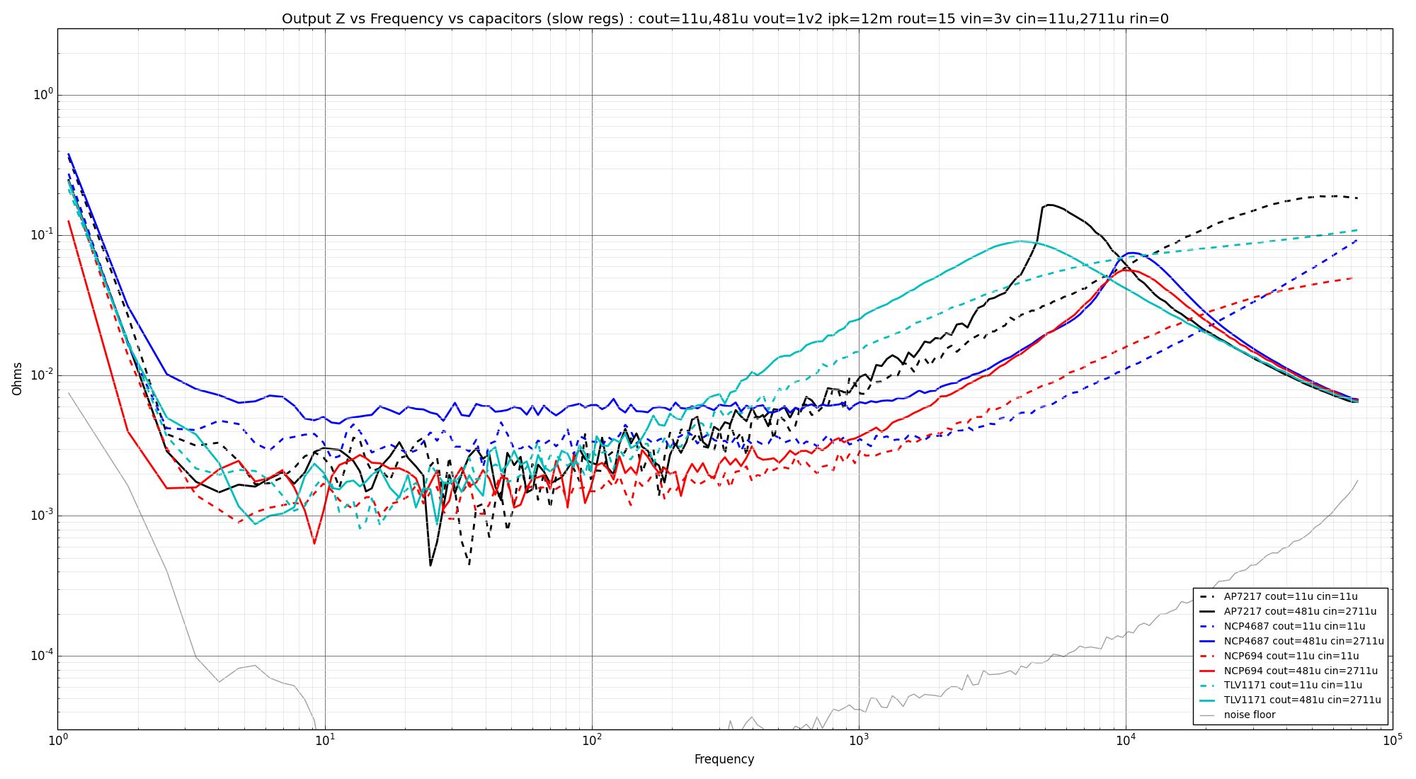

That could explain the excellent performance !

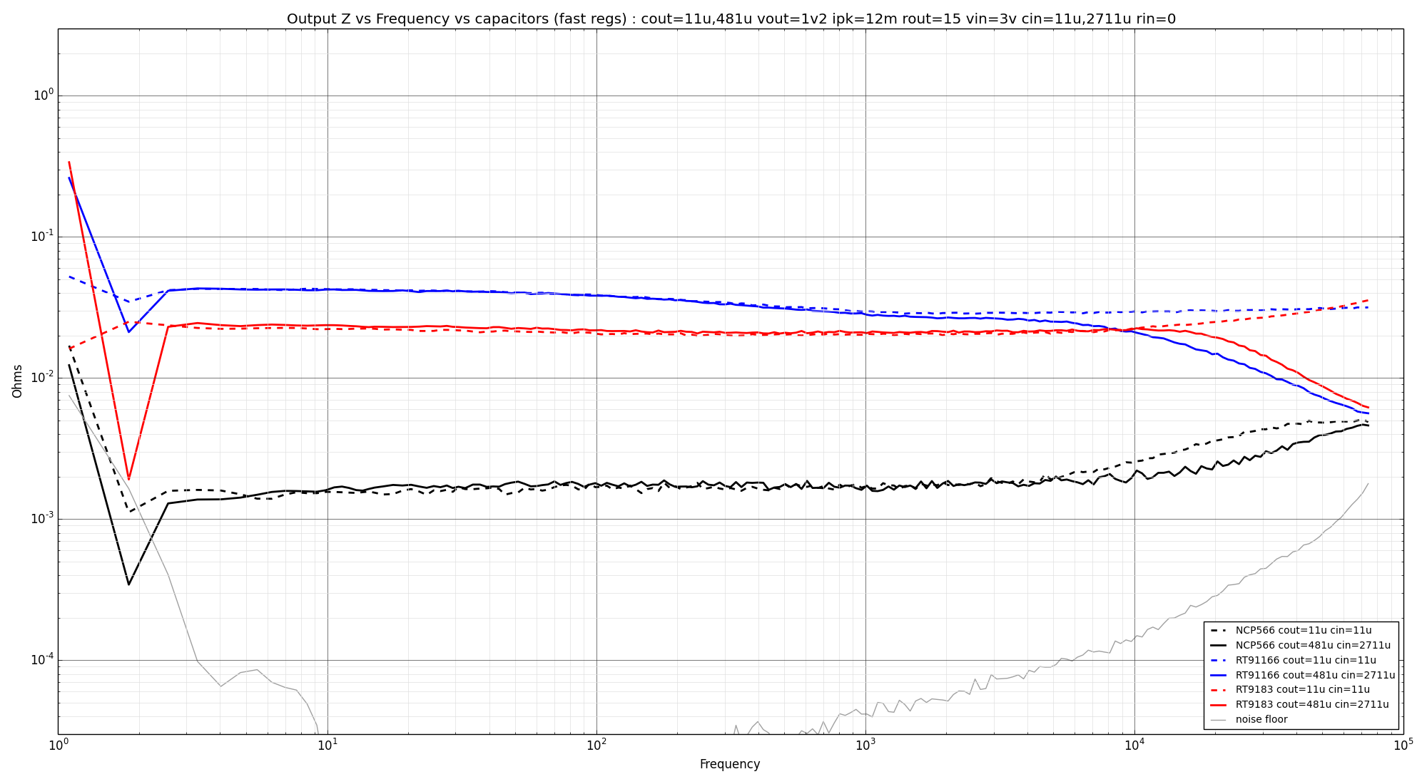

I have added :
- 470uF Panasonic LF ultra-low-ESR polymer capacitor at the output
- large 2700uF Nichicon PW low-impedance electrolytic at the niput
The LF's are really nice caps. I have used some at the output of a switching regulator, a tiny 220uF cap eats 2 amps of ripple, doesn't heat at all, it doesn't care, and the output is pretty clean.
Anyway. More curves.
The dashed lines are previous measurements, with only ceramic caps. The full lines are measurements with capacitors. Same color, same regulator.
Left plot : the slow ones. Here we got some problems. Three are definitely unstable. The TLV1171 looks ok, except, well, it would need an enormous capacitor to have a flat impedance curve.
So, I will no longer consider these regulators.
Right plot : the fast ones. Very different picture...
- The two Richtek regs deliver a smooth transition from regulator to capacitor between 10-20kHz.
- The NCP566 desn't seem to care.
Those three are quite spectacular...

Of course, above a few MHz, a test with a real layout and appropriate ceramic capacitors would be needed, so please don't look too much to the right.
Here, for each of the 3 winninig regulators, 4 tests are performed.
Black trace :
Cin = 1µ X75 // 10µ X5R // 2700µ low-ESR
Cout = 1µ X75 // 10µ X5R
Red trace :
Cin = same Cin as Black, plus 470µF LF polymer
The two Ricktek regs show no difference between those two. Thus, the ceramics at the input are sufficient.
For the NCP566, the adding a local polymer cap at the input seems to cause some problems. I would have liked to look at the waveforms, but my scope died... However, with more output decoupling, the problems disappear.
With only ceramic caps, its output impedance is still very low, 10mOhms at 200kHz, impressive !
Blue trace :
Cin = same Cin as Red
Cout = 1µ X75 // 10µ X5R // 100µ Nichicon R7 polymer
Cyan trace :
Cout = 1µ X75 // 10µ X5R // 470µ Panasonic LF polymer
Blue/Cyan comparison :
Here the difference is the output capacitor, 100µ versus 470µ. Both are high performance polymer caps, with ridiculously low ESR and excellent HF performance.
NCP566 seems to like the 470u cap better. It provides a smooth transition from regulator to capacitor, whereas the 100µ cap creates a small peak.
This is due to the output impedance of the regulator becoming inductive at HF. It behaves like an inductor having an extremely low ESR (1-2 mOhms). So, in parallel with a cap, it can resonate depending on the value and the ESR/ESL of the cap. The same thing happens when parallelling capacitors. 470µF seems to be the sweet spot.
For the two richteks, no such problem, since their output impedance is higher, they behave like an inductor with more ESR, which dampens the resonance. The caps lower the impedance above 10-100kHz.
Capacitor choices :
For the NCP566 I would stay with the 470u LF cap which provides a nice transition. However its ESR is extremely low, which means it creates a not so good looking antiresonance peak with the 10µ ceramic. This means more low-ESR caps would be needed to fill the holes, maybe around 50-100µF, or more large ceramics. More tests needed.
The Richtek regs would be better associated with a capacitor having higher ESR, perhaps 15-20 mOhms, instead of the 4-7 mOhms of the LF/R7. This would flatten the impedance curve and soften the antiresonance peak with the ceramic caps. Thus, less capacitors would be needed in total.
So, these regs offer two design options.
The NCP design target could be :
- 2mOhms up to 10k
- < 5 mOhms up to 100k
- < 10 mOhms up to HF
This option would use many capacitors.
The Richtek design target could be :
- flat 20 mOhms up to HF
This option would use less capacitors than the NCP.
Decisions, decisions...
Black trace :
Red trace :
Blue trace :
Cyan trace :
Capacitor choices :
- 2mOhms up to 10k

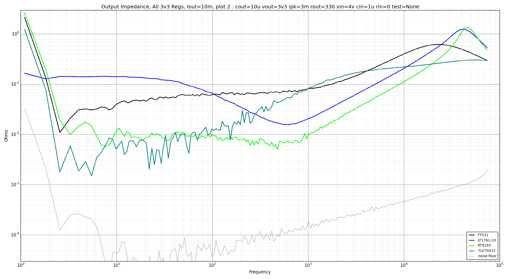

First plot, the flat ones...
No ultra low output impedance here ! The best are around 0.1 ohm.
Based on output impedance alone, the 4x price difference between the most expensive and the cheapest of the bunch.

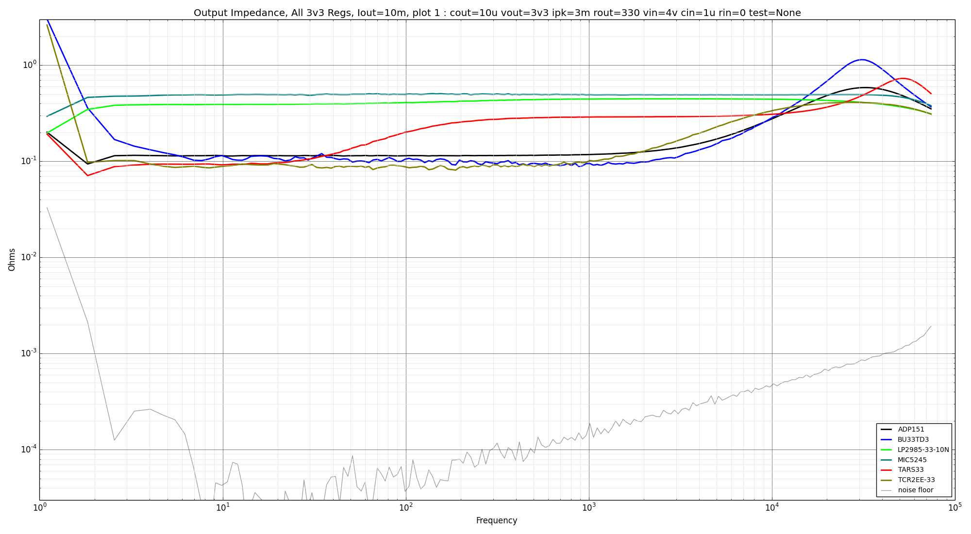

Second plot, the wavy ones...
LT1761 delivers a funny-looking impedance graph (LTSpice agrees). It is by far the most expensive of the bunch and doesn't seem to provide any advantage, unless having low impedance only around 800 Hz could be useful ?.... I included it because people seem to like it...
Richtek RT9193 scores on output impedance (again), although the noise on this one is 100µV so not "ultra-low" as the datasheet claims, also it is not as fast as its 1v2 brothers RT9183 and RT9166... which exist in 3v3 versions (very difficult to find though).
Of course, noise is important too, but on a regulator with 10µV output noise and 0.1ohm output impedance, a 1mA variation of load current is enough to make the output voltage vary 10x the specified noise. So, the low-noise ones (ADP151) would be nice to power something which draws a constant current, like a clock.
So, no real winner this time... For the ES9018, DVCCT isn't critical, but DVCCB seems to be important for jitter, so I'll have to measure the current to check if it is constant or not.
I will also do a comparison with a TL431.

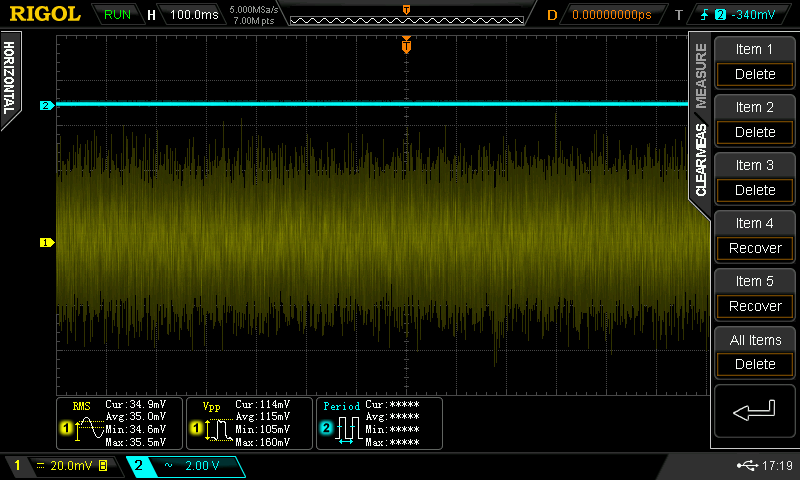

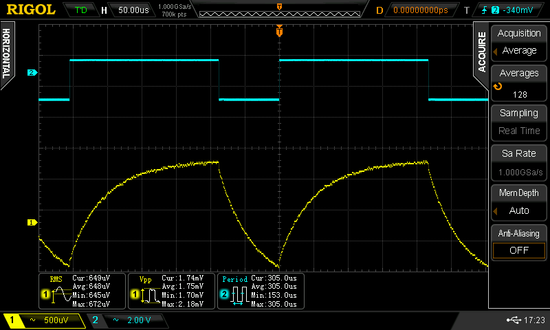

In the meantime I have measured a few samples of good old TL431.
Here is the noise with scope on 100ms/div setting and Groner's x1000 preamp.
This corresponds roughly to the noise in the preamp's bandwidth, which is specified at 10 Hz-100kHz +/- 0.1dB (so the 3dB points are wider, of course).
I should do a FFT... when I find a way to import the scope captures into the PC...
As we can see it is important to pick the right one... TL431 also has high frequency noise, the capacitor filters it out.
The output impedance is desperately high at about 0.1 ohm (see datasheet).
Attached are two scope shots of OnSemi TL431 :
- Noise (using x1000 preamp)
- Transient response. The shunt current is stepped between 23mA and 40mA, a 17mA step. The impedance of the device is specified at 0.1 ohm, accordingly this produces about 1.75mV peak-peak voltage variation.
