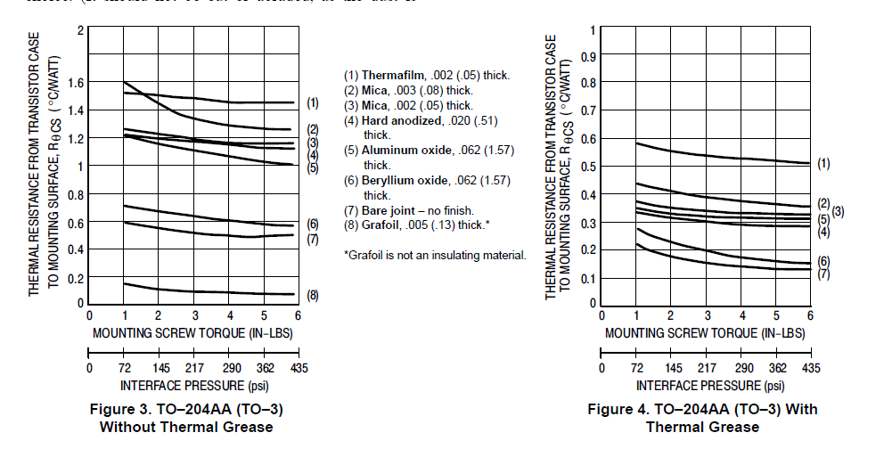

The torque applied to the mounting bolt has a very significant effect.
If you haven't tested for this it would be a worthwhile addition to your results.
If you don't have access to a torque wrench I could share my results when I get around to doing it.
Motorola application note AN1040 includes LOTS of data about the effect of mounting bolt torque. Or perhaps I should say the non-effect. Here is one of their numerous figures.

I am talking about single screw mounting.
Those graphs as well as the TO-220 are not junction to heatsink values, but are case to sink. As such, they can be misleading.
On page 11 directly under fig 11, they state that the TO-220 cases will lift as a result of screw torque.
When the case begins to lift, the heat path is no longer direct to sink, but has to travel horizontally to the high pressure area.
If you are going to believe a write up like that, look carefully to see that they are actually measuring thermal performance by monitoring both the heatsink temperature and the junction temperature. Again, case temperature will be misleading.
I've performed these thermal resistance tests using two techniques..drive the die to the exact temperature using an active control circuit and see how much power is required for a specific heatsink temp, or drive an exact power and monitor a die temp dependent entity.
Driving the die to a programmed temp was really fun, as you can actually de-mount the device and watch the power drive plummet in response.
