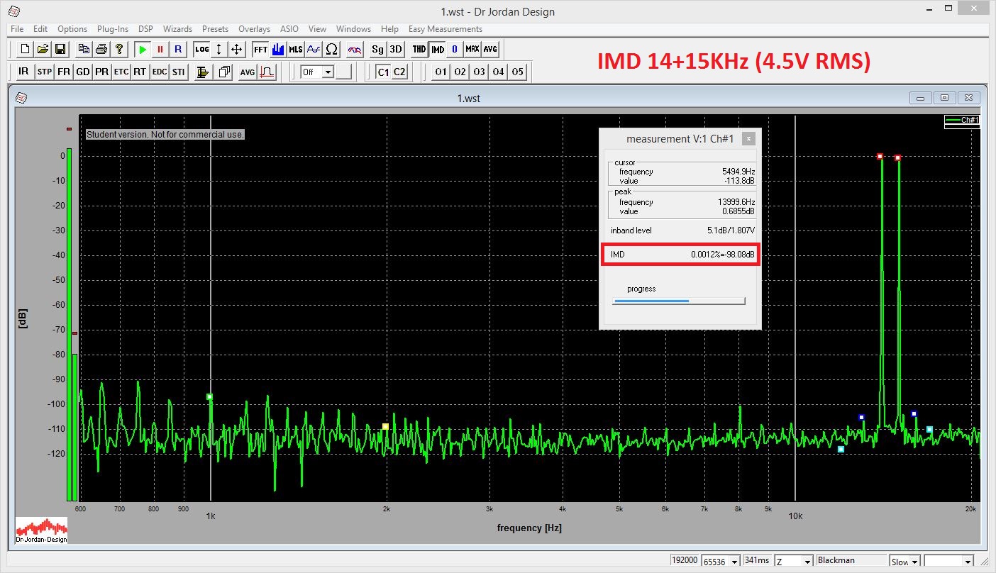

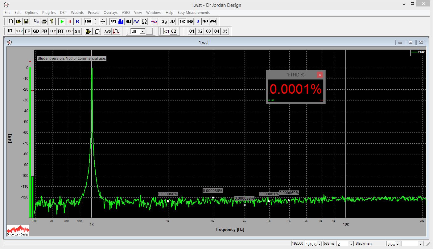

I use the German software from >HERE<, commercial version. With Lynx L22 pro-grade sound card - very precise metering system. External loopback shows THD at the level of 0.0001% at 1KHz as well as at 20KHz (see attached). Output level is 650mV RMS here, sample rate = 192KHz.

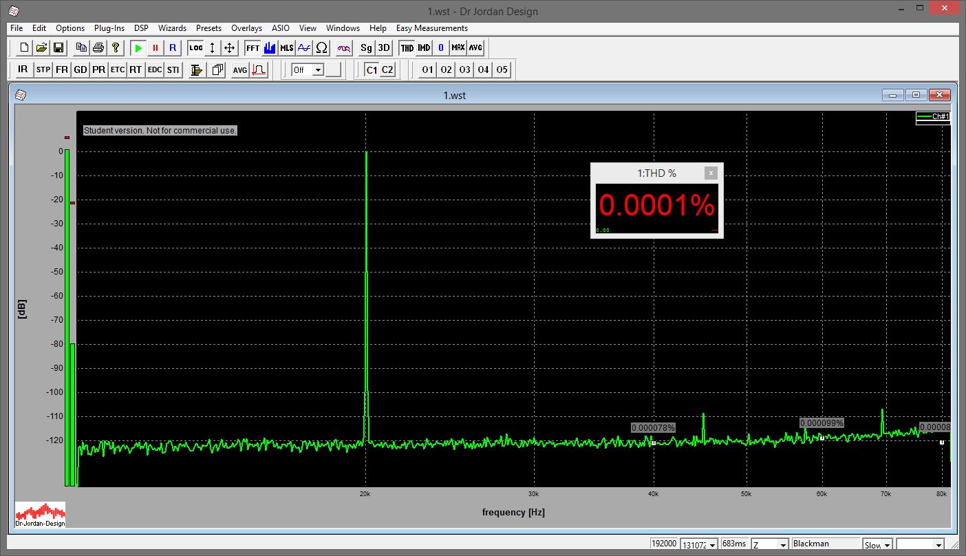

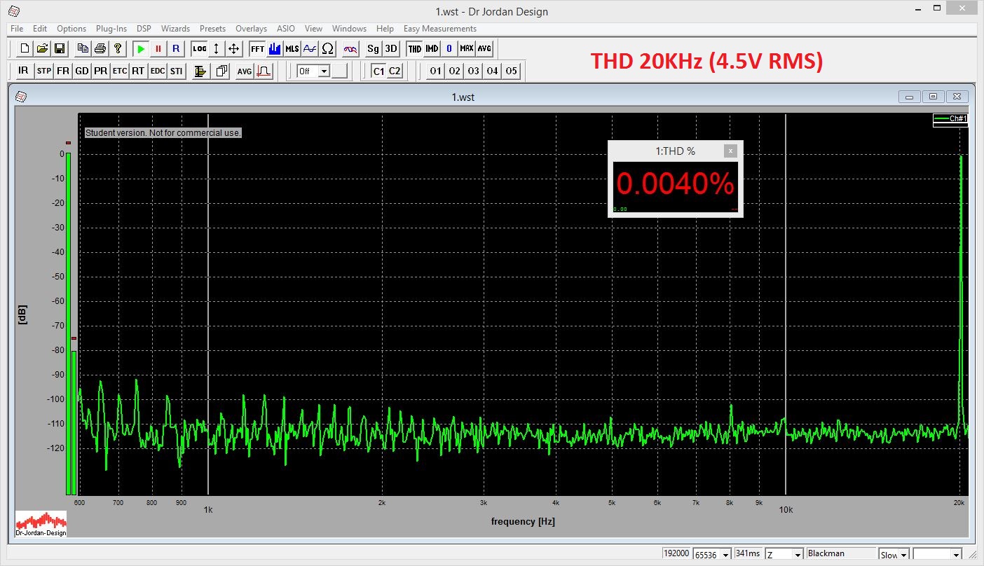

Hi Valery
The screen for the 20 kHz THD doesn't show any response past 20 kHz.
If the response is filtered past 20 kHz then the THD will look very impressive, of course😉
Some sound-cards and/or software assume you don't want response past 20 kHz.
Fine for sound but bad for measurement, have you checked this?
Can you show the response past 20 kHz?

Hi David,
I see what you mean, I had these doubts as well as soon as I started using the software. Unfortunately, it doesn't show anything higher than 22KHz. But it still measures there.
At 192KHz sample rate the sound-card's bandwidth goes up to around 90KHz.
So, for 20KHz signal, the software can see at least the 2-nd, 3-rd and 4-th harmonics, which is good enough.
Measurements for a number of different amps show adequate results.

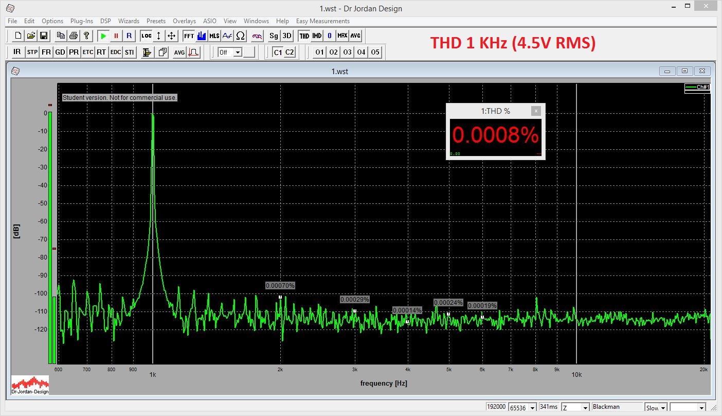

Attached are the graphs for one of my "serious" hybrid amplifiers, running at 8R load with 3 pairs of IRFP240/9240 at the output.
20KHz THD is 5 times higher than 1KHz one, although we still can't see anything above 20KHz.
I even spoke to Dr Jordan Design engineer - he confirmed, the software measures up to the bandwidth limit (varies according to the sample rate).

Nice IMD measurement. I couldn't get this level of IMD performance from the last soundcard I tried, let alone the amp.

?? Manual, page 382Unfortunately, it doesn't show anything higher than 22KHz.
Use Options->Display Properties->Zoom and set x-max to e.g. 42000. You can also double click outside the plot area on the x-axis label an this dialog box opens.
?? Manual, page 382
Hah! BV, thanx a lot 🙂
By some reason, I didn't know about such a simple thing 😛
It works. Here is the same external loop-back spectrum for 20KHz signal.
Some minor artifacts are visible at 45 and 69 KHz, but - c'mon - no complains, excellent performance anyway

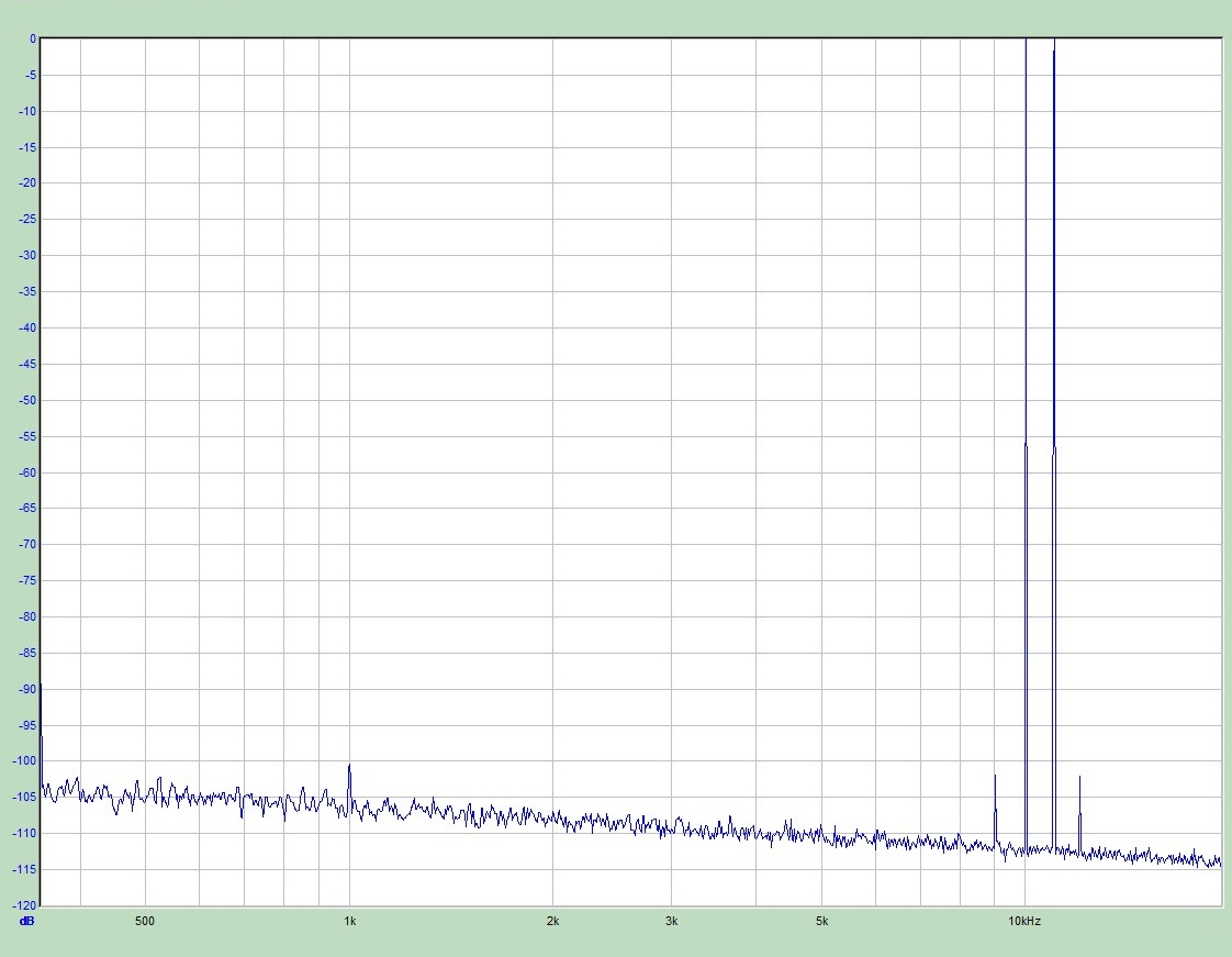

I keep hearing this, yet the M-Audio 192 PCI card I've been using is extremely quiet. Measurements of my phono preamp, for an example:
