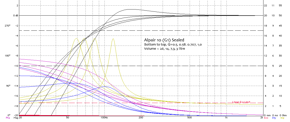

I have the original Alpair 10s.
Sim attached.
Alternatively, what would the A10 be like in a transmission line?
Probably. Pensil, Brines, M10-A10 for the newer ones. Old A10 was close enuff to A10.2 that they work in the same reflex box.

You guys are talking about sealed boxes/acoustic suspension.
