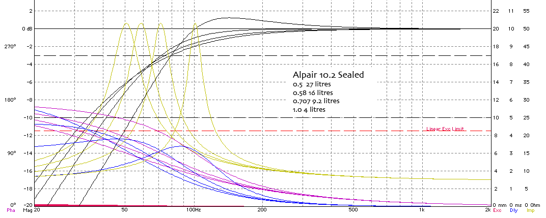

Do these units work in infinite baffle? If so what's the optimum volume?
I have 21 litre columns, which I've been using in infinite baffle with Alpair 10s. A bit light on bass but the rest is nice. I wouldn't mind building a bigger cabinet.
I much preferred the Alpair 10s to the JX92s I had previously. I really didn't like them much - the Alpairs were smoother and more musical and the difference wasn't subtle. So I'd be curious about these new units if they really are a step up from the older ones. And the extra bass would be useful.

Terminolgy guys -- infinite baffle means a box so big that the volume is irrelevant. You guys are talking about sealed boxes/acoustic suspension. For Alpair 10.2 (or do you have the original A10, newer ones are much better) something like 10 litres gets you down to 70 Hz F3.

Yes, sealed box. I have the original Alpair 10s. Would I gain any bass with the newer ones? Looks like 21 litres isn't shabby from your frequency charts. A bit down at 40hz though.
Has anybody used a passive radiator with a unit like the A10? And if so what type?
Alternatively, what would the A10 be like in a transmission line?
