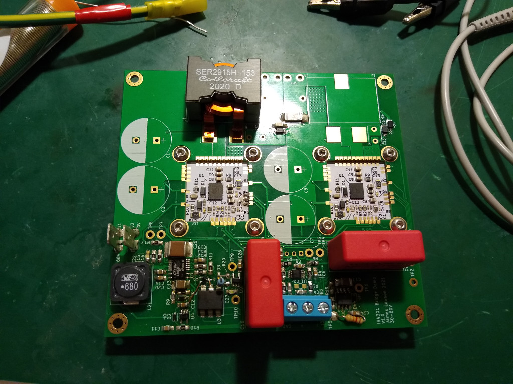

I have been trying to work with the IR4301 in a single supply full bridge configuration (two IC's) I haven't got it working yet though (didn't work straight away and I have been busy). I have also assumed that its IRS2092+FETs. The datasheet isn't very good and I found I had to look at all the example IRDAUAMPs and the application notes before I had a clue how to design around it. Even then some things are quite unclear.
I can share some info on my board(s) later but its a hybrid of aluminum PCBs and a dual layer carrier board. This didn't work very well (hard to solder the alu pcb to dual layer PCB) so I would recommend a 4 layer PCB, possibly thinned (<1.6mm) with high density thermal vias.

Here is a picture of my partially populated dual IR4301 prototype. The aim was to allow greater power dissipation through use of ALU board for the IR4301 which ASIK should allow up to around 500/250W 4/8 ohm when operating them in full bridge. However soldering the alu boards to the 'carrier' board is a total pain, I had to use a 80W metcal station and it was still tricky. If this prototype works I will do another using a 4 layer board and thermal vias instead to the get the heat out. My main aim is battery powered PA so maximizing power output is very important.
In terms of sound I doubt they will sound very different but TPA3255 with a good PFFB implementation has very nice measurements.
